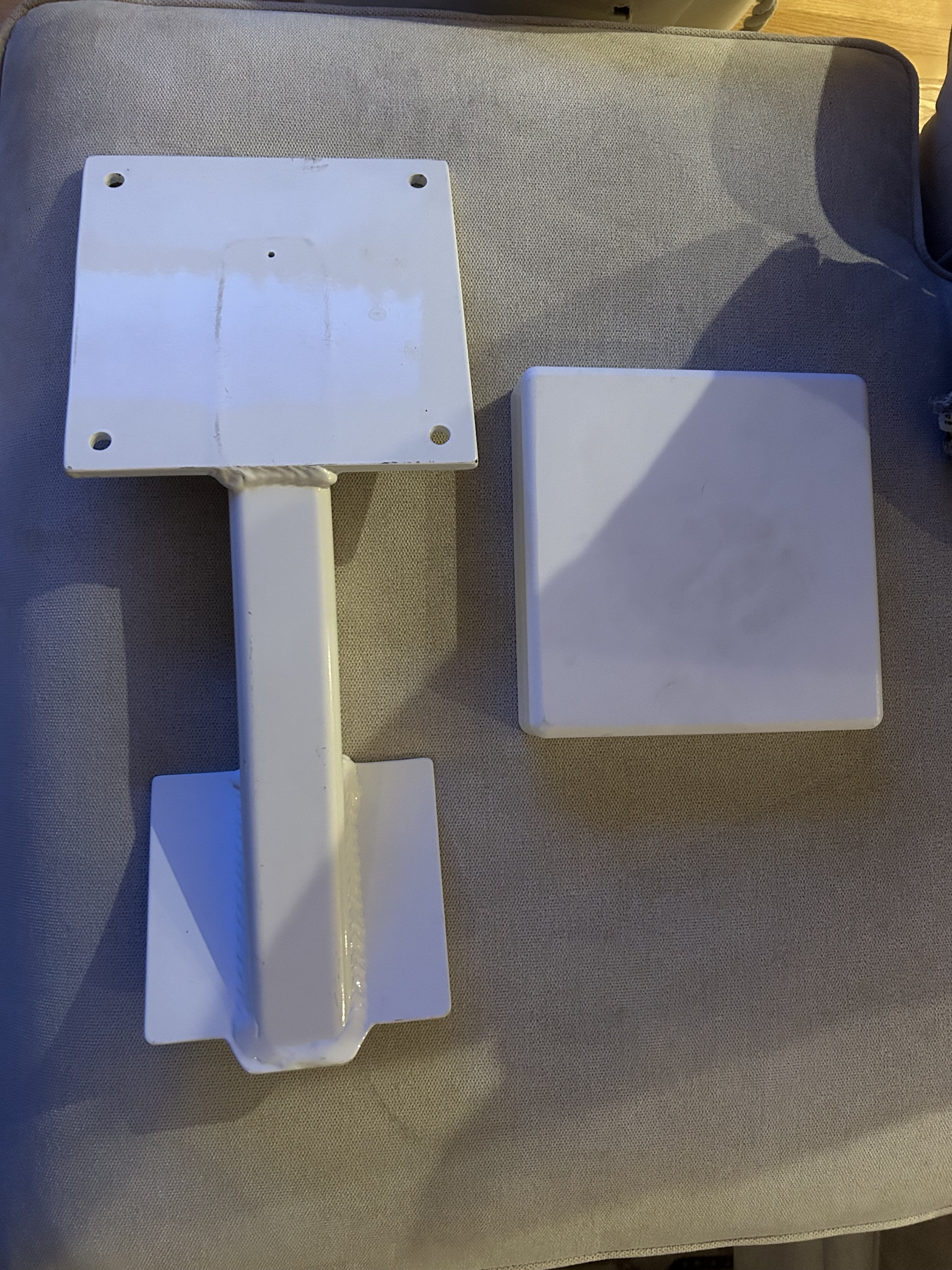

Just bought a Yamaha 2.5 and a mount to store it on the back of my R27. Bought it from Port Boat House and they delivered it today. This isn’t what I expected to receive and I’m not sure how it mounts!!! Email to PBH was not answered today.
This is supposed to go on the back side of the propane locker.
Does the pad shown go on the inside of the propane locker to support and strengthen the fiberglass?
I’m used to seeing motors mount onto the pads but the pad I received is sized for the larger end with the bolt holes which has to go into the boat?
Anyone know how this mounts? I received only the two pieces shown.

Closing the loop, the motor does rest on the pad at the larger end. I need to drill holes in the smaller end mounting plate - lugs pass through the transom into the propane locker. I’ll support the bolts with a plate and big washers. Should be straightforward, having to drill holes in the bracket threw me for a loop.

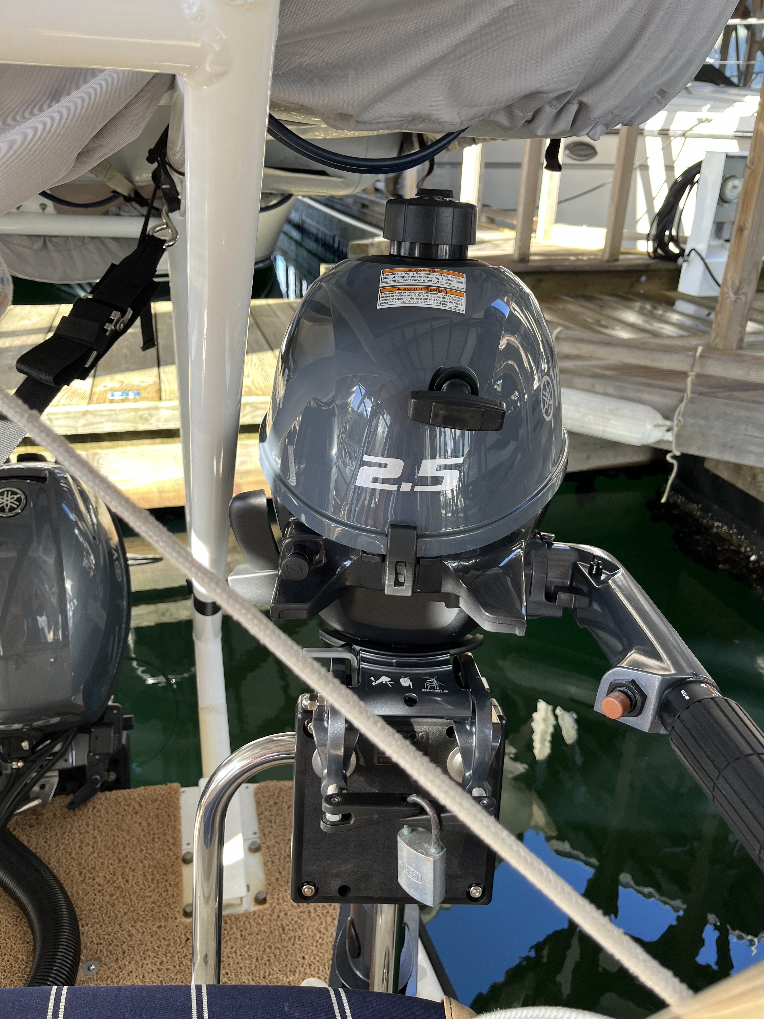

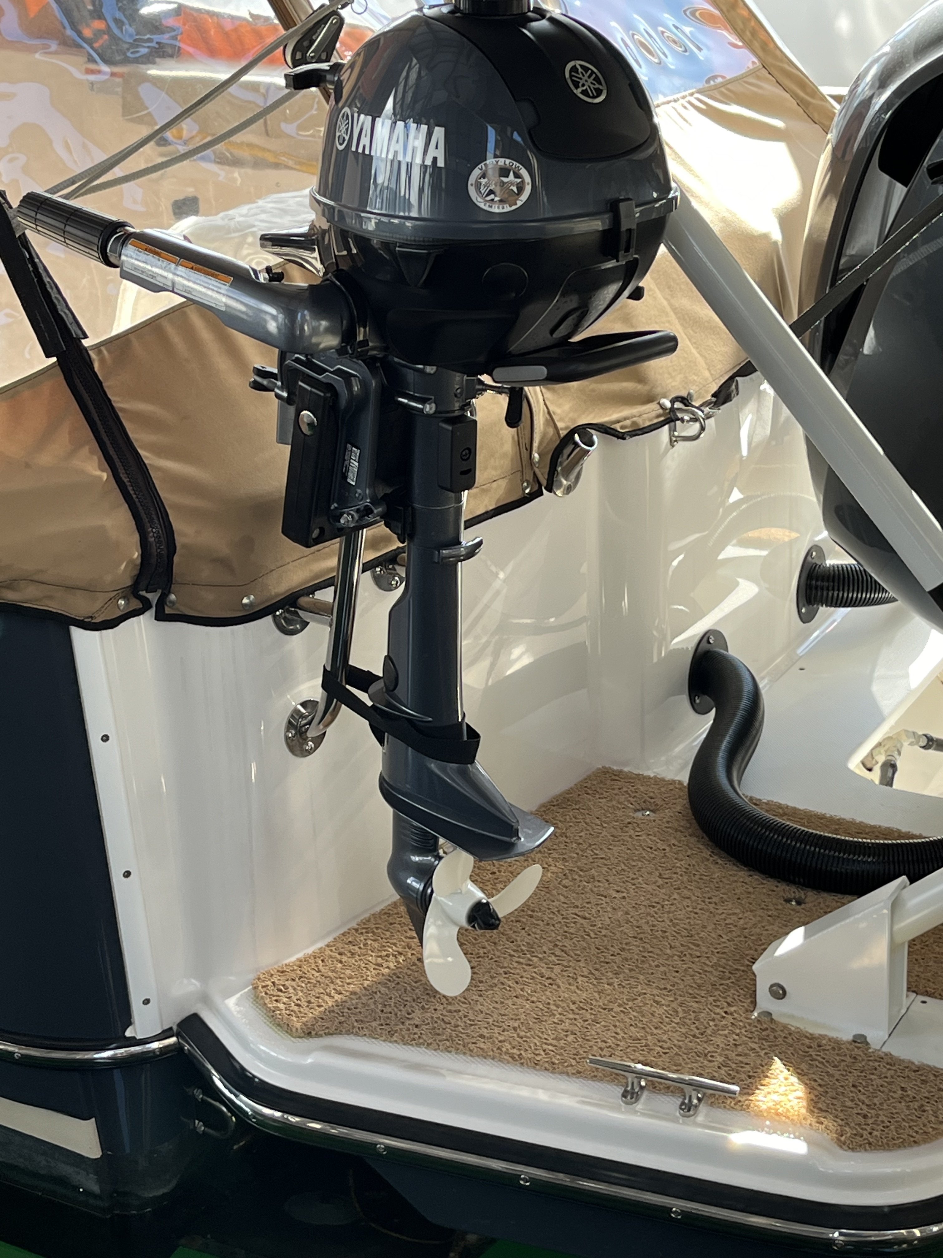

I too was faced with the challenge of how and where to mount my dinghy motor on my RT 27ob. I had initially used an electric motor for the dinghy and found it easy to store inside the port lazarette (no oil, no fuel). However, range anxiety meant distance/time is very limited. So, i purchased a 2.5hp yamaha.
The boat came with a dinghy lift and the standard dinghy motor mount provided by PBH with the 2.5hp could not be properly positioned along the transom area. Eventually, I ordered the mount that Ranger Tugs uses with their factory setup.
Yes, holes have to be drilled but what is crucial is to beef up the backside of the transom wall. Mine has a space ( a few inches) between the transom wall and the propane locker, so putting a plate inside the propane locker wall will not properly support the dinghy motor.

Hi, I initially received the mount you pictured, but because the boat came with the factory dinghy lift, I had difficulty positioning the mount/bracket properly to my satisfaction with the lift pulled up. So, I decided to purchase the factory motor mount and follow RT's method.

@tedli357 - thank you. I went to the boat (not close!) tonight to see what the situation is. The transom wall and the propane locker wall are much thinner than what I envisioned and I struggle to see how the mount I have will hold a 40lb motor without flexing and stretching the holes. Then what a mess!!!!

@tedli357 thank you so much. That’s the one I’ve been looking for and what I thought PBH was selling me. The photos are very clarifying. Thank you. Do the bolts pass through right into the propane locker?
No, there is a space between the transom wall and the propane locker wall. It is within this space that one should be putting reinforcement for the transom wall. I strongly suggest having someone familiar with fiberglass work do the reinforcing for you; that space in between is quite tight.
