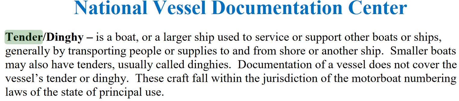

Although a lot of people handle this in many different ways, it is pretty straight-forward if you look at the actual policies and laws of the respective agencies. The USCG will defer to the individual states in regard to tender registration. From the USCG NVDC (https://www.dco.uscg.mil)
From the Revised Code of Washington (https://app.leg.wa.gov/RCW/default.aspx?cite=88.02.570) exempting vessel registrations, here are the relevant sections:
Exemptions. (Effective until January 1, 2029.)
Vessel registration is required under this chapter except for the following:
(7) A vessel equipped with propulsion machinery of less than ten horsepower that:
(a) Is owned by the owner of a vessel for which a valid vessel number has been issued;
(b) Displays the number of that numbered vessel followed by the suffix "1" in the manner prescribed by the department; and
(c) Is used as a tender for direct transportation between the numbered vessel and the shore and for no other purpose;
(9) A vessel with no propulsion machinery of any type for which the primary mode of propulsion is human power;
So, by the letter of the law, a USCG-documented vessel's tender does not need to be registered in WA provided that it's under 10hp, only used for shore transportation, and it has your USCG doc number followed by "-1" on it. Or, you only use muscle power to make it go.
For us, it's cheap and easy enough to just register the tender with WA DOL and then use it like we please.
