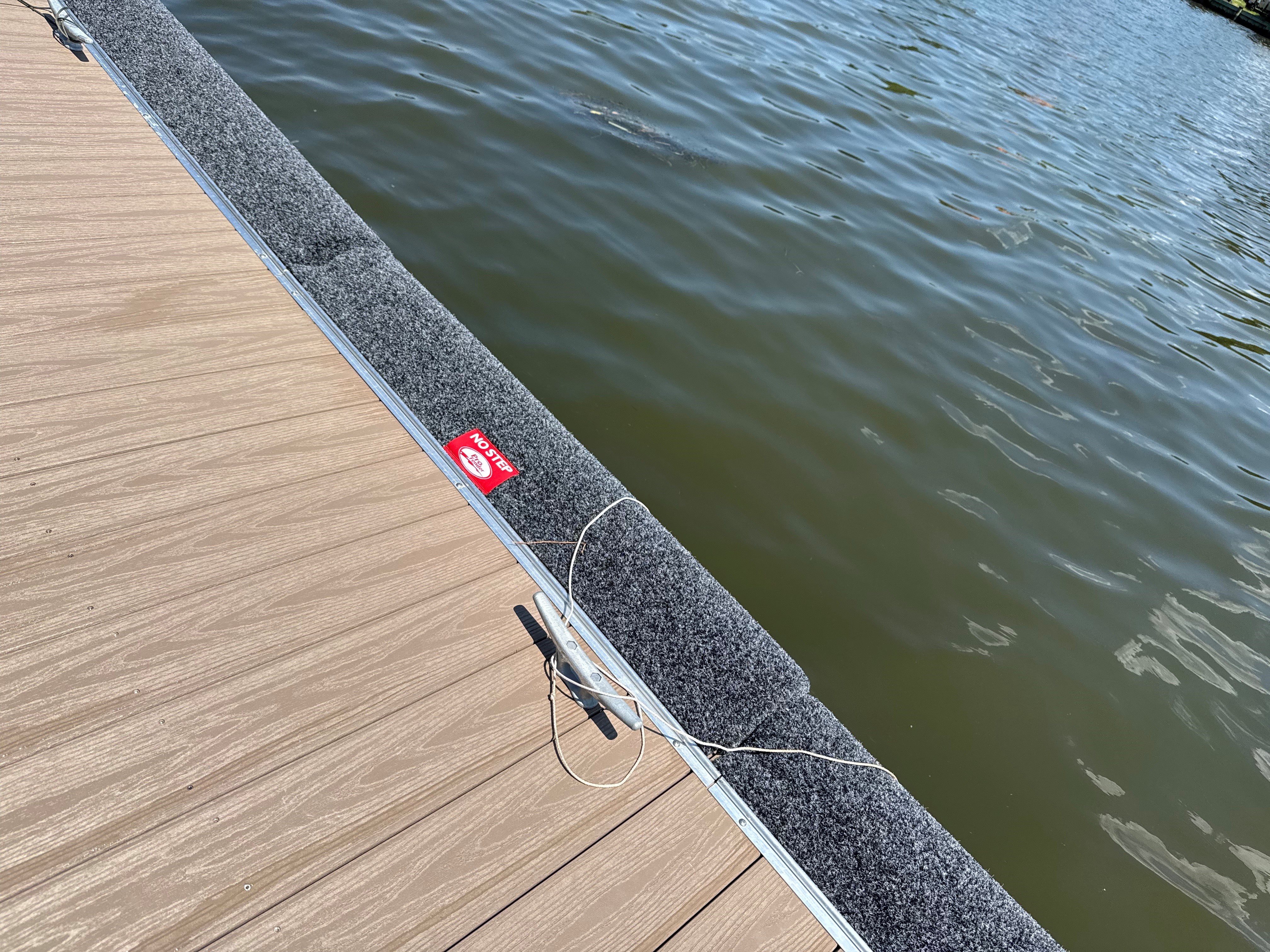

If it's your own personal dock/slip I can't recommend highly enough the product by profender international. Myself and many others in my area have switched our docks over to them. Basically its a metal track which replaces the dock rub rail and a full length fender is wrapped in carpet and secured in it. Now I only carry a couple fenders for when visiting other ports.
This looks like a great product. I am going to see if I can get a sample of the carpet to see if its abrasive at all.
I submitted a request online for a swatch of their carpet to see how abrasive it was. 2 hrs later, I received a call from the owner and founder, Ross Cooney. He answered all my questions and told me to call him personally if I needed more information. I was impressed. Will be placing an order in the next 48 hrs.

Ended up going with ProFender, https://profendermarine.com/products/profender-custom-dock-fenders. They are great so far.
