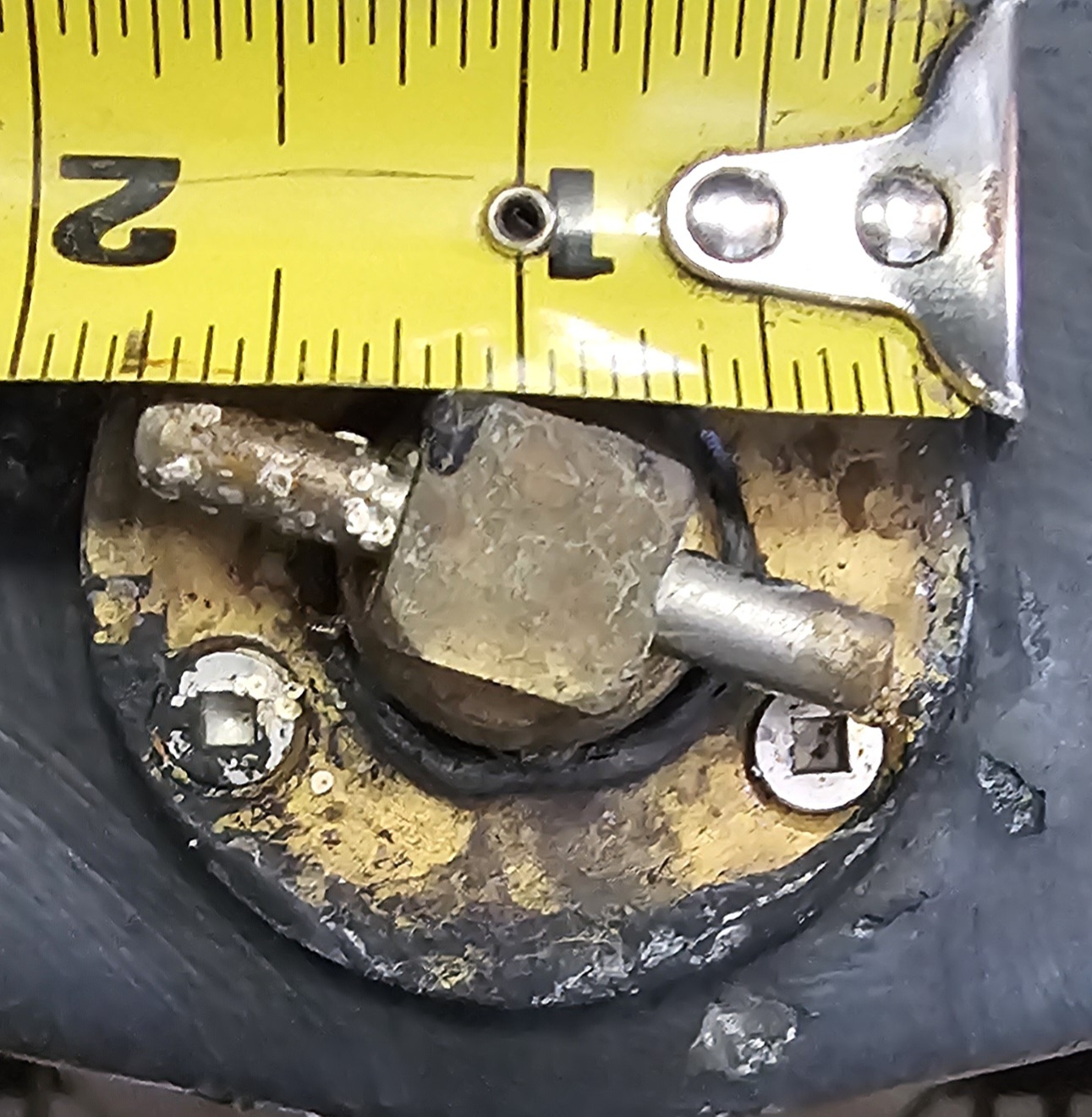

After trips where the boat didn’t really have to deal with seas or spray except on the hull, I notice that there is about a quart and a half or a half gallon of salt water in the far after bilge area right where the pump sits. The mid bilge by the second pump is just a bit damp as though a little water may run in there when I come off plane.
I think the water is coming into the boat through the drain plug, which I haven’t touched when I pulled the boat out for the first time.
I am going to put the boat on its trailer and replace the brass screw-in drain plug, and I am asking if anyone else has experienced a similar situation.
Also—is the plug a standard 1inch diameter or two inch so I can have the right size plug ready to replace when she is on the hard—it looked like a one in her for my 2019 R27 Outboard.
Thank you in advance for any discussion or advice!
Anything is possible, but I wouldn't consider that the most likely spot for water entry. Easy enough to check when you pull the boat out of the water; put some water in the bilge and see if it leaks out from the drain plug.

The drain plug (garboard drain plug) on our boat is bronze. A brass plug is not advisable .

Is the garboard drain plug a 1 inch diameter or 1.5 or 2” bronze T-handle item? Thank you!
Check this thread (specific to an R25 but your R27OB should be the same).

Thank you Pandion—I really appreciate your pointing me in that direction—and the clue about the drain plug!
