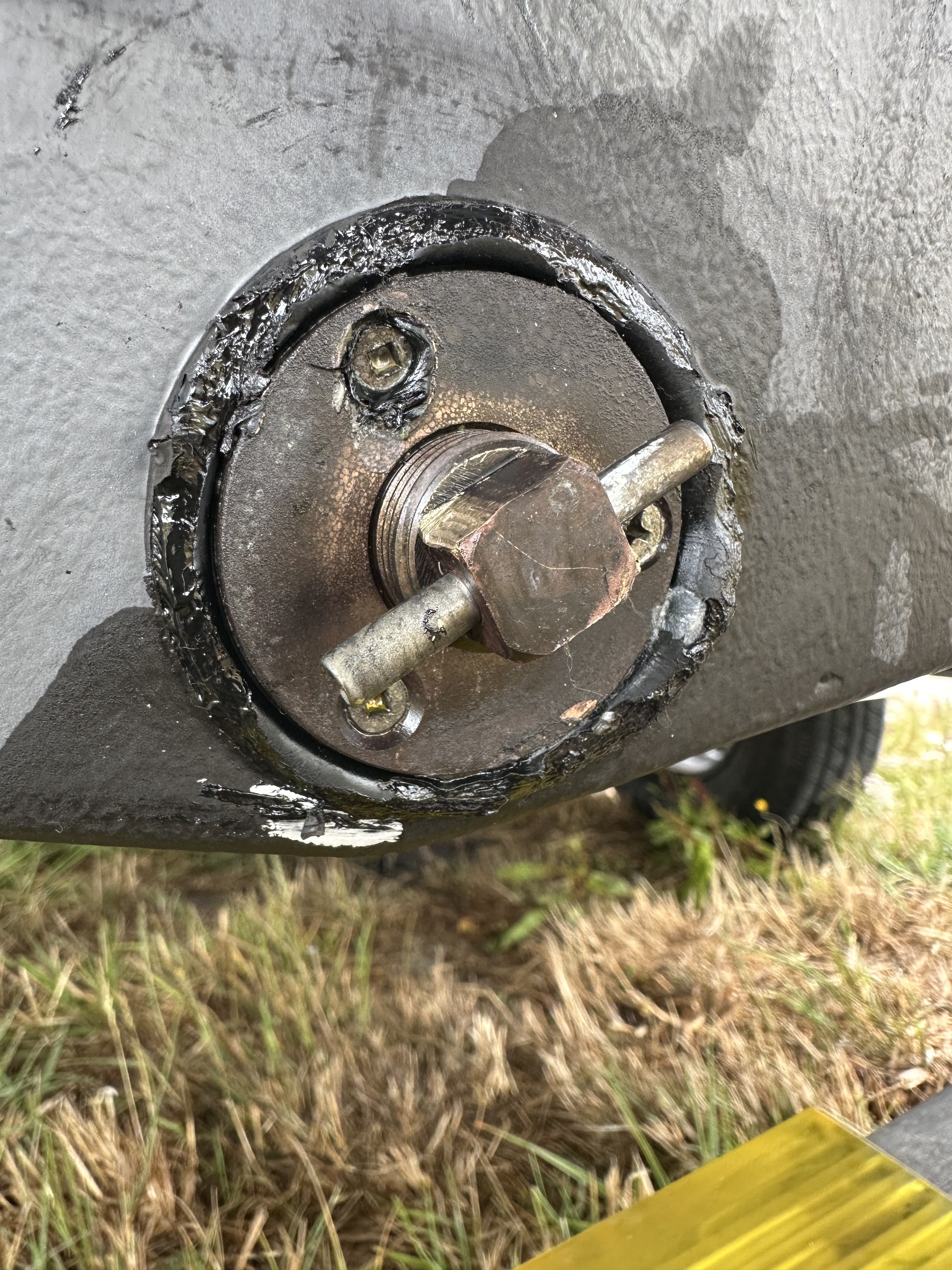

2023 R-23 drain plugs are not budging at all.
Hit them with a little PB Blaster but my very large crescent wrench is not moving at all.
Do I need a special tool to remove the two drain plugs?
I feel stupid I can’t get these out.
