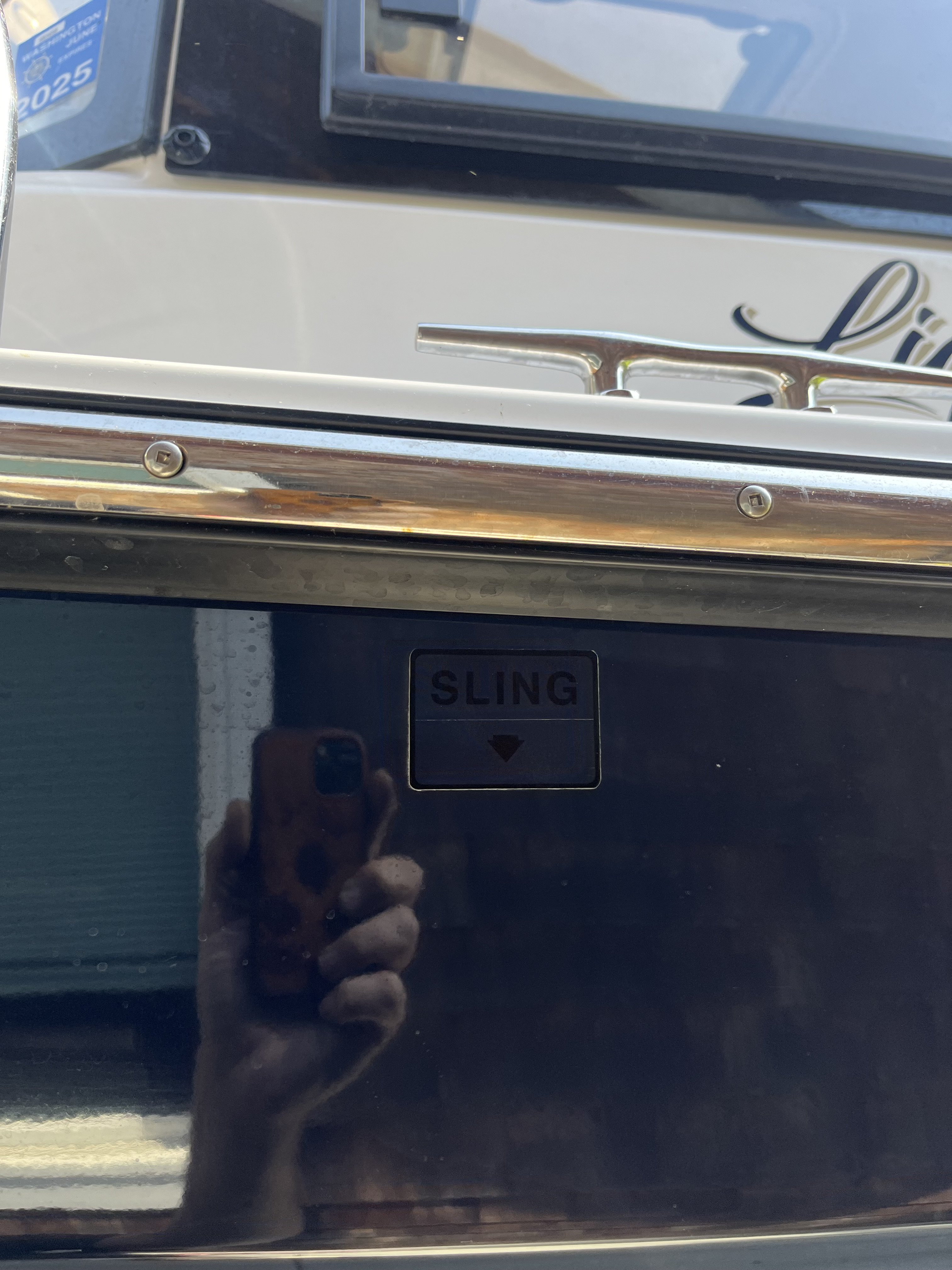

I do have a blue hull and I have not found the sticker. The boat is currently at Elliot Bay while I am on the waitlist for Edmonds. We purchased the boat and trailer about 1 month ago and I still have not seen the trailer. Andrew included it with our purchase, its behind the Factory some place.
If anyone has a photo of a R27 OB sling sticker location I would love to see it, I was unable to find one with our search tools.

You can somewhat see the decals on this red Tug from the FM website. The forward decal is just below where the bow rail meets the deck; the aft decal is mid-way between the back of the cabin and the transom. Look for dark smudges just below the gunnel rub rail.

Forward sling sticker just below sliding front window. Aft sling sticker is 41” forward of back of boat. 12’ 6” spacing between stickers. Forward sling sticker aligns with cutouts in target (forward) bunk set. However, I just noticed that our aft sling sticker sits forward of the bunk cutout. We have a 2024 27OB sitting on a Float On trailer. The aft sling sticker is 41” from the back of the boat and the bunk cutout falls on the 15”-32” mark from the back of the bunk.
Another tip... Get some yellow painters masking tape (it's not very sticky). Cover the top of the gunnel with it where the sling markings are. This helps the sling operator find the spot from looking down on the boat.
