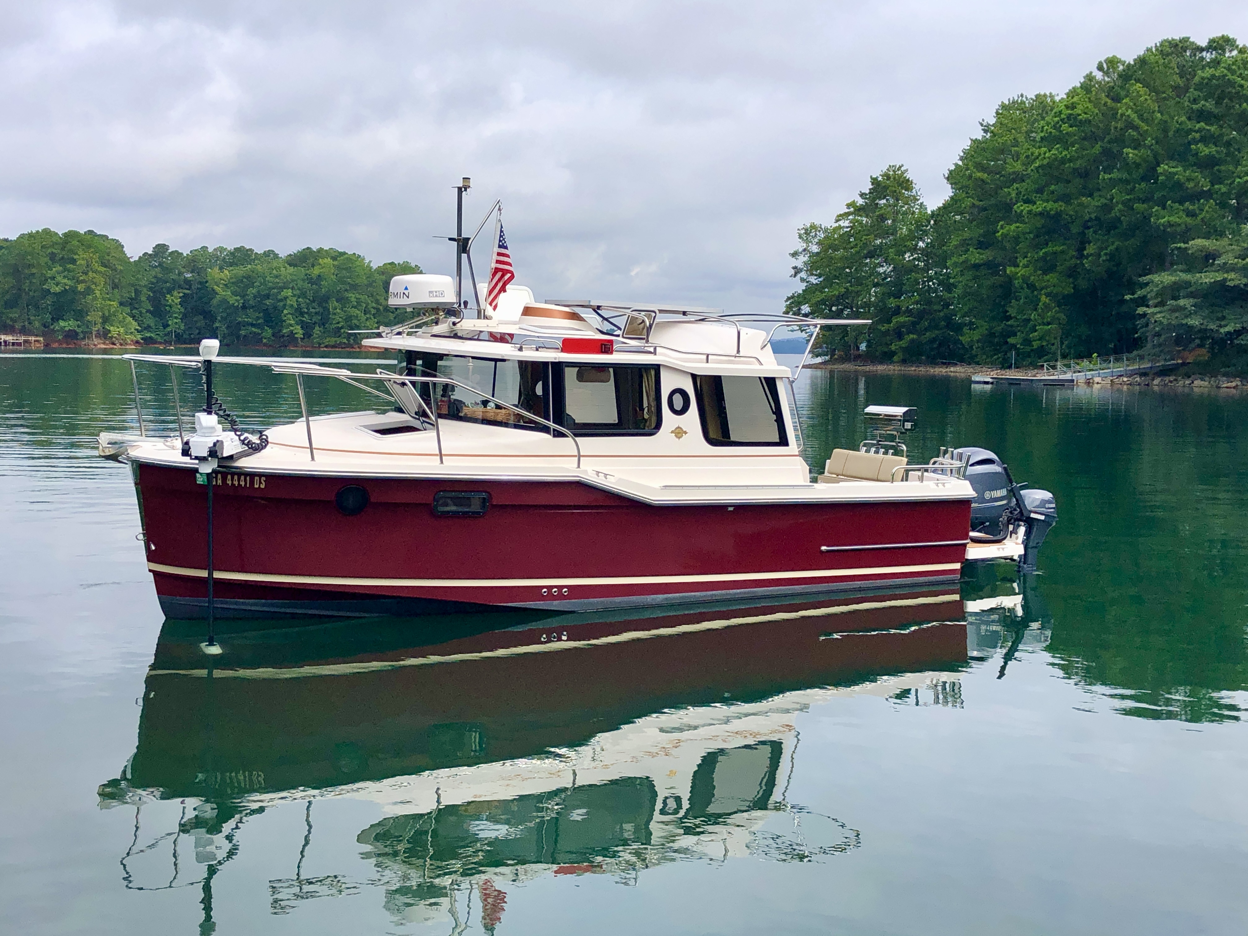

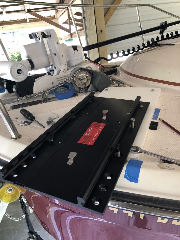

I am not an ocean or great water cruiser by any means BUT still having the same safety concerns plus helps immensely for self launching and fishing thus, the auto deploy/stow Minn Kota Riptide Instinct Quest 90lb Thrust, 87” Shaft works great for me (there is bigger available too). Let me know if you want to see a video or check the Minn Kota website. I know I know. That’s a lot of redundancy but then again I have always been a risk management/safety kind of guy.
