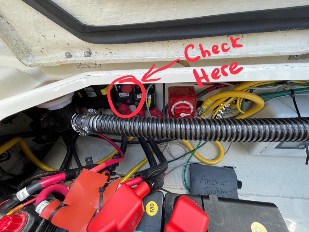

Just replaced all four batteries. Engine good, thruster good, house no good. Have to use boat on parallel for house and dash power. Have house switch on properly. Did i miss a breaker under port cockpit locker? I may have accidentally flipped cockpit courtesy lights for a few days, but not sure would discharge both new deep cycle house batteries. Any quick breaker thoughts?
Thanks very much!!!!!
Sounds like leaving the courtesy lights on for a few days is the culprit. I would charge your batteries up and then monitor. When away from the boat it is good practice to turn all your battery switches off unless you are on shore power with charger on.
I doubt courtesy lights would drain new batteries that quick. There is a breaker for the house that should be in the lazarette. It has a lever on it. My guess is that it got tripped or accidentally bumped.
Check here:
Wow. That photo solved the problem! Thanks so much and thanks to everyone mind enough to try and help. Now a happy boater again. Happy Spring-Summer. !!
Kind enough to try to help. Sorry for typo.
