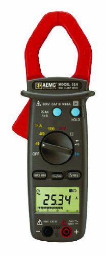

I suggest you get a clamp on VOM (Volt Ohm Meter) with DC measuring capabilities. The first one I bought only measured AC, so I had to get another for boat use.
This is what I'm talking about:
Something SIMILAR to this, I mean. FLUKE brand is TOPS, but also quite expensive. Look on line and you will find units from $25-400 but you don't have to get an expensive one.
Anyway, clamp this puppy onto one of the cables on your START battery. If everyting is OFF and the battery IS ISOLATED, you should read ZERO amps. If your getting ANY amp readings, then you will need to do more detective work to see WHAT is consuming the amps. IF you get ZERO amps and the battery is crapped out in 3 days, well then you know you've got a BAD BATTERY.
NEXT, clamp this puppy onto the pos or neg cable of your house bank WHILE YOU HAVE YOUR STUFF RUNNING. This will give you an idea of the actual LOAD on the house bank. Adding up all the consumers will work too, but this way there's NO GUESSING because you are measuring the actual amp flow.
Wonder HOW MUCH SOLAR juice your getting? CLAMP this puppy onto the wire and SEE THE AMPS!
Wonder if your alternator is putting out the amps? Clamp this puppy onto the alternator output wire and SHAZZAM now you actually KNOW.
Are you starting to see HOW USEFUL one of these puppies can be?
NOTE: if you clamp the thing around a 2-wire conductor, like lamp cord with the (+) and (-) together, your VOM will read ZERO since the amps flowing in oppposite directions cancel each other. You must be able to clamp INDIVIDUAL conductors. They usually come with probes so you can still use it to measure VOLTs.
