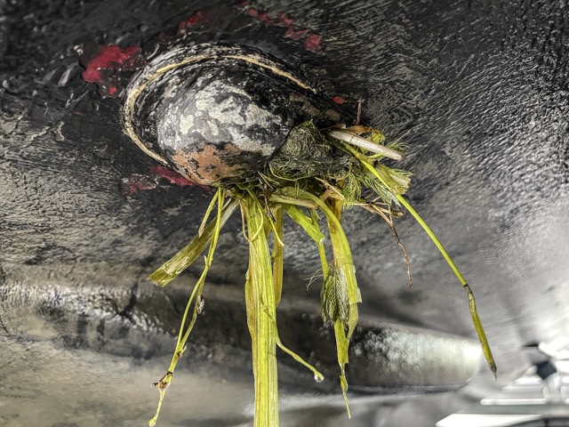

BEWARE: When I was on the canal, there were areas with lots of large mats of floating eel grass, especially in and near locks. It was impossible to avoid them. My raw water intake on the bottom of the boat got clogged up with eel grass three times. The strainer only had small bits of grass in it.. I had to enter the water and get under the boat to clear the intake. It presents exactly like a failed impeller— the engine temperature rises with increasing rpm and will overheat. I needlessly changed an impeller the first time it happened. I have owned this boat nine years and it is the first time I have experienced a clogged raw water intake and I’ve been all over the eastern U.S. with the boat.
