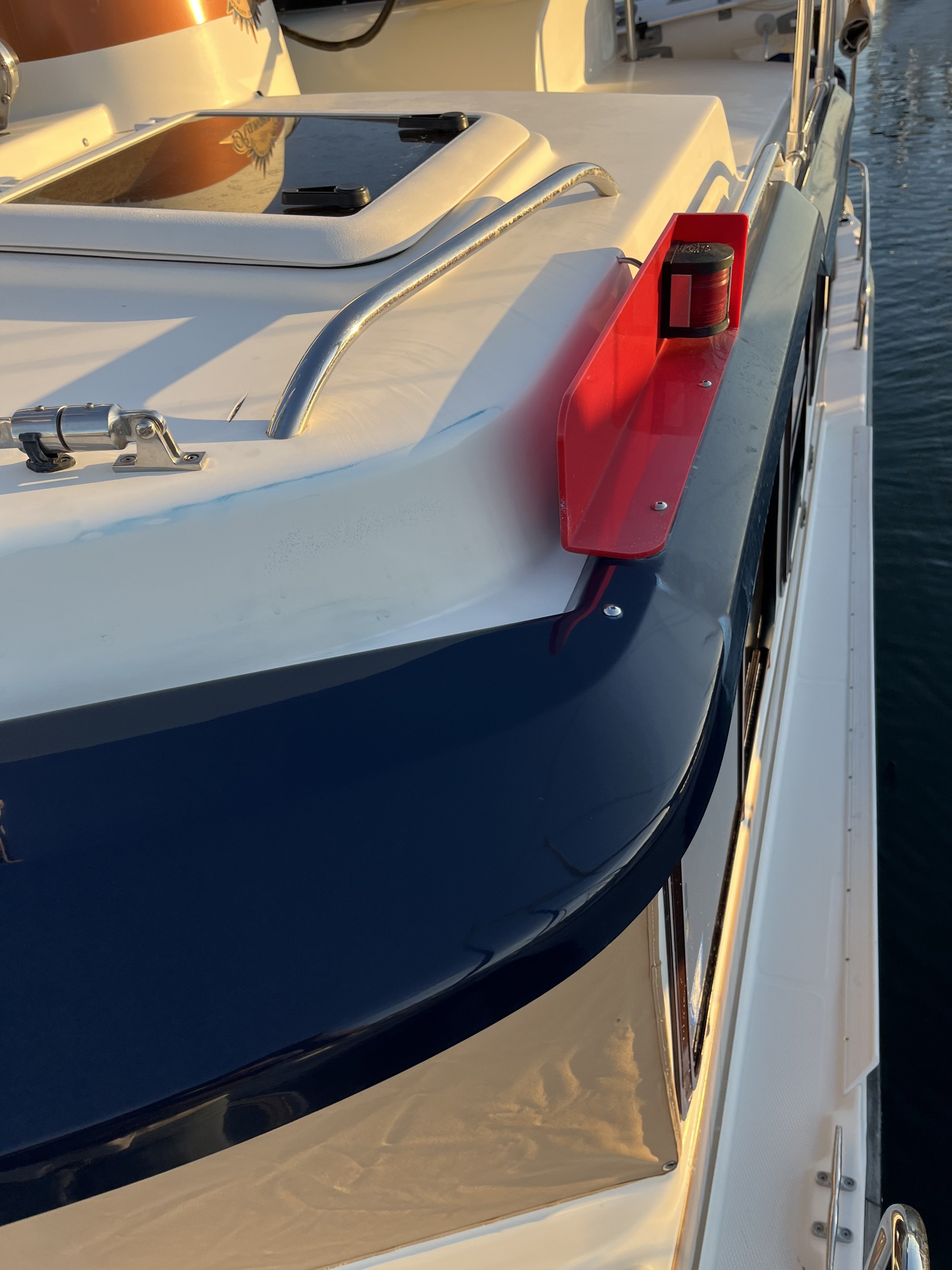

My LED light strip under the forward port side cabin “eyebrow” has gone out. These gently illuminating exterior cabin lights are awesome and come on with the cockpit courtesy lights. Can anyone point me to the replacement part? While this LED strip is the first of the four to fail I suspect the other three strips (1 under each of the 4 “eyebrows”) are soon to follow

I used these a few years ago to replace a section that had failed. They are not the same and do not match the light color or pattern exactly. But they are similar enough if you replace the entire section it appears very much like the factory installed lights. They are very easy to install, you can just cut them to length with scissors. They work fine with the boat power, just plug and play. They are self stick for easy installation. Still working fine 2 years later. Search on Amazon.​
iNextStation 12V LED Light Strip IP65 Waterproof Yellow LED Strip Lights 16.4ft/5m Cuttable 300 SMD 2835 LED Tape Flexible Led Lights for Bedroom Outdoor Indoor Decor (Power Adapter not Included)​

I ordered a spool of these led lights and they will arrive tomorrow. Appreciate the pointer to a replacement light and will probably do the entire port side (2 strips) so everything looks consistent.
