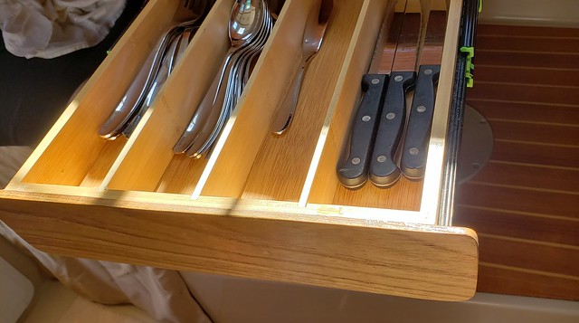

I have done a few mods to make the boat better for us. Lack of a cutlery drawer was driving the admiral nuts (more) so I added one like a few others have done under the table.I started with a bamboo cutlery drawer divider and added slides to the sides and some angle brackets under the table top. Found a scrap of teak to make a face for the drawer.
Cutlery drawer by evguy, on Flickr

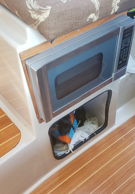

On one of our two day trips we were just getting back to the marina when there was a pop and lots of rushing water. The hot water line for the galley had come off a tee fitting. I'm not a fan of clear braid hose and plastic tee fittings for hot water so I pulled out all the lines and replaced with red and blue PEX with crimp fittings. I would have thought this would be the way they would come from the factory. Added a small pressure tank to reduce pump cycling while I was in there. I cut the access hole to the cave below the micro like many have done and intended on adding a door to it this winter. On the first outing our two small dogs found the new hole and claimed it as their own. I just lined the cut edge with auto door trim for now but will trim it in teak over the winter. It now has 4" of egg crate foam left over from a piece I cut for the V berth so they have a cushy bed. Dog house on the boat by evguy, on Flickr
