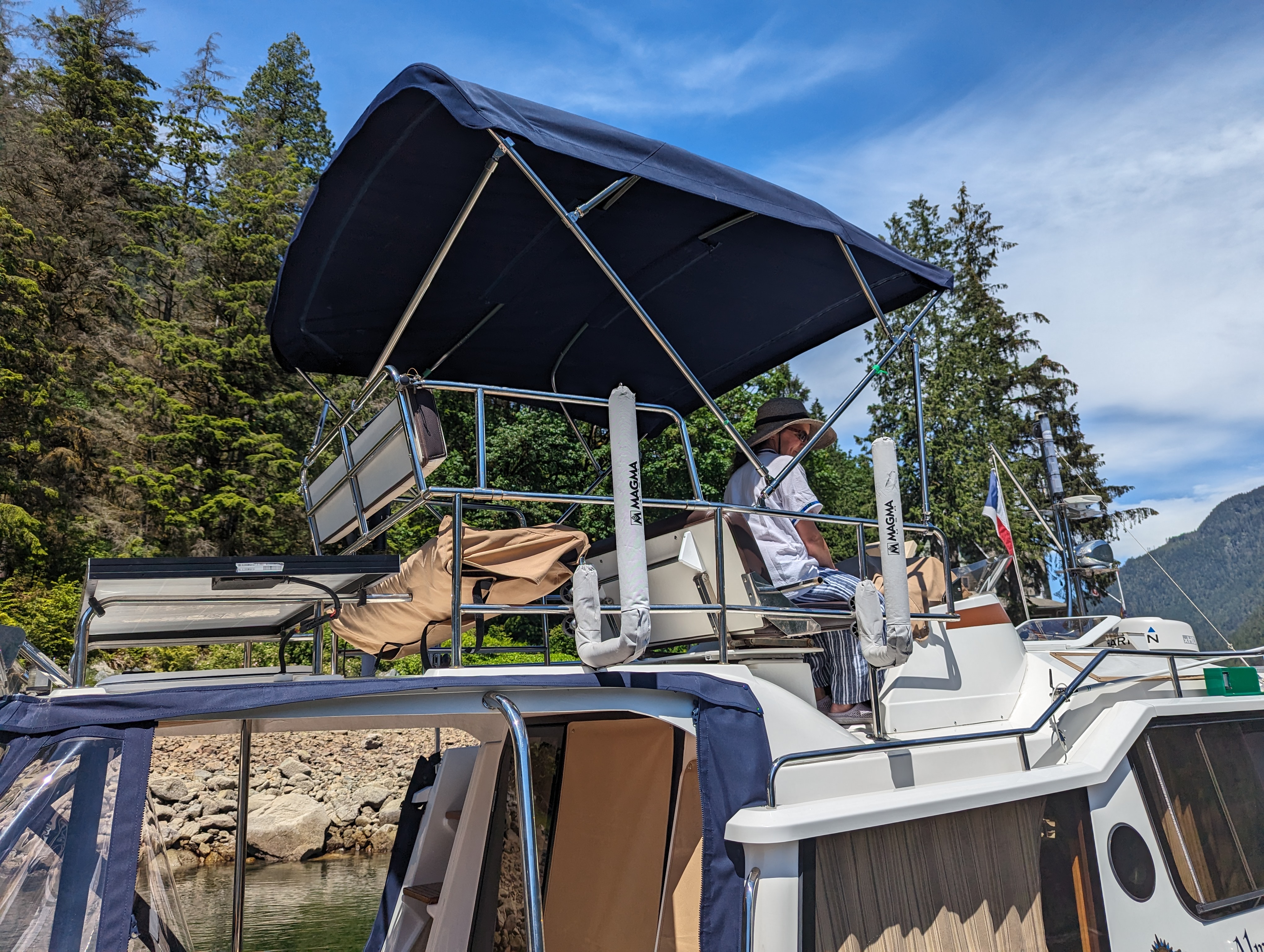

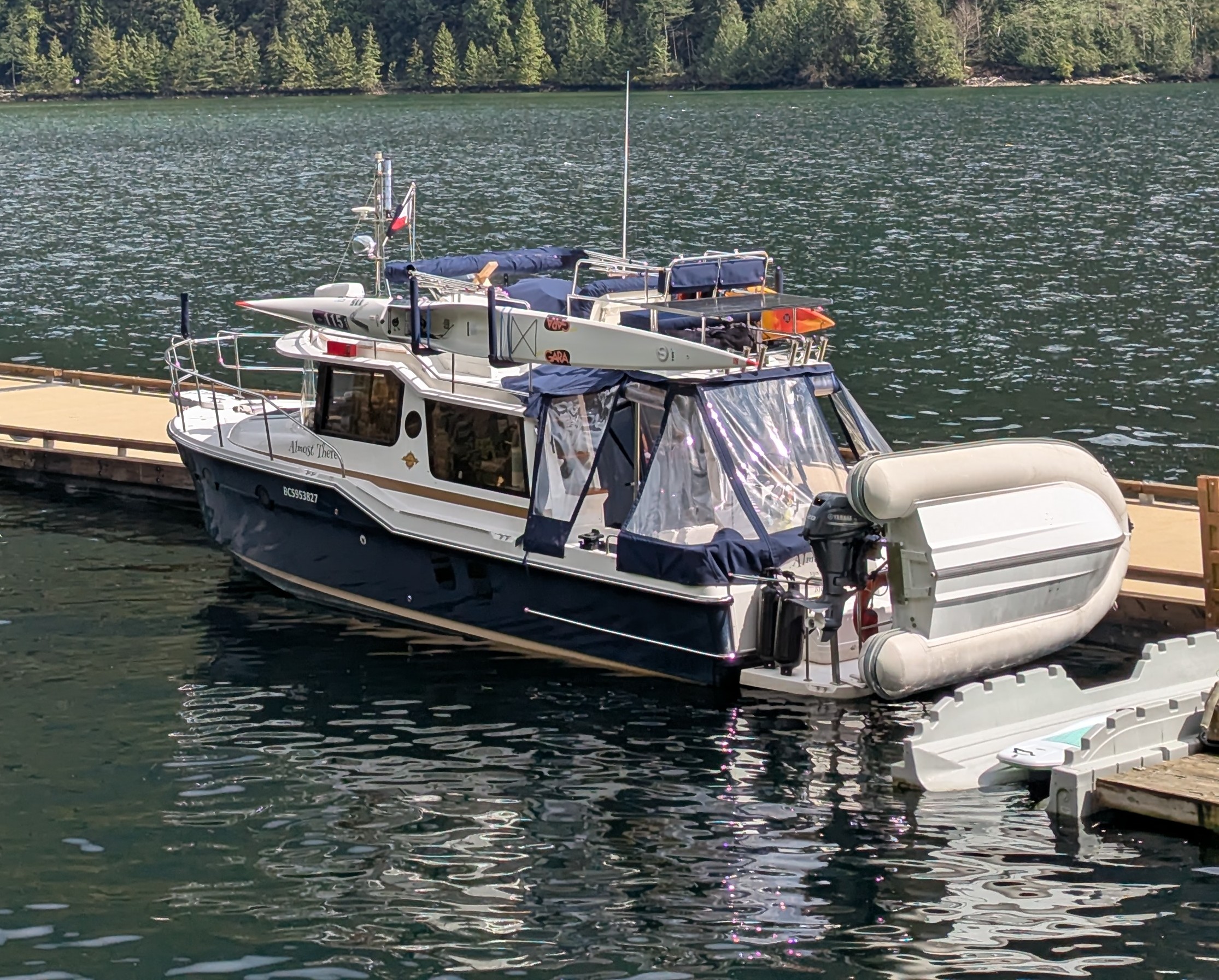

Typically, biminis are installed with the main bow angled aft around 45 degrees. We flipped ours around so that it could lie flat because our boat shed is too short
This shows the main bow forward, with vertical struts to anchor it to the railing. The secondary bow is aft with struts angled in to provide lateral stability.

Thanks for pics . Helpful Ken
