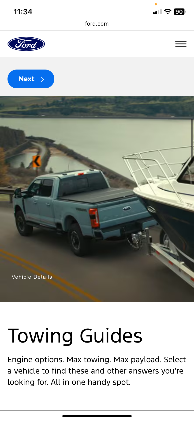

I believe this is the advertisement you were talking about, but I can’t determine what type of boat it is.
Is this the ad?
That Ford ad shows the truck exceeding its towing capacity. With a Ford F-150, to tow a load above 5,000 pounds, a weight distribution system must be used. That’s according to Ford’s own published information. One is not being used in the ad.
The only way to exceed 5,000 pounds with an F-150 without weight distribution is through the use of a gooseneck or 5th wheel hitch.
Every Ranger Tug or Cutwater I’ve ever seen on a trailer has been on a conventional aluminum I-beam trailer. Almost all manufacturers of such trailers prohibit use of weight distribution systems because of the loads imparted on the trailer. So in effect, a Ranger or Cutwater cannot be towed per manufacturer specs by a Ford F-150.

If I am not mistaken, Ford ads typically say the F series Truck is the best selling for x number of years. MIK is correct that the particular truck shown in the above picture is a super duty, which is likely either a F250 or a F350.
