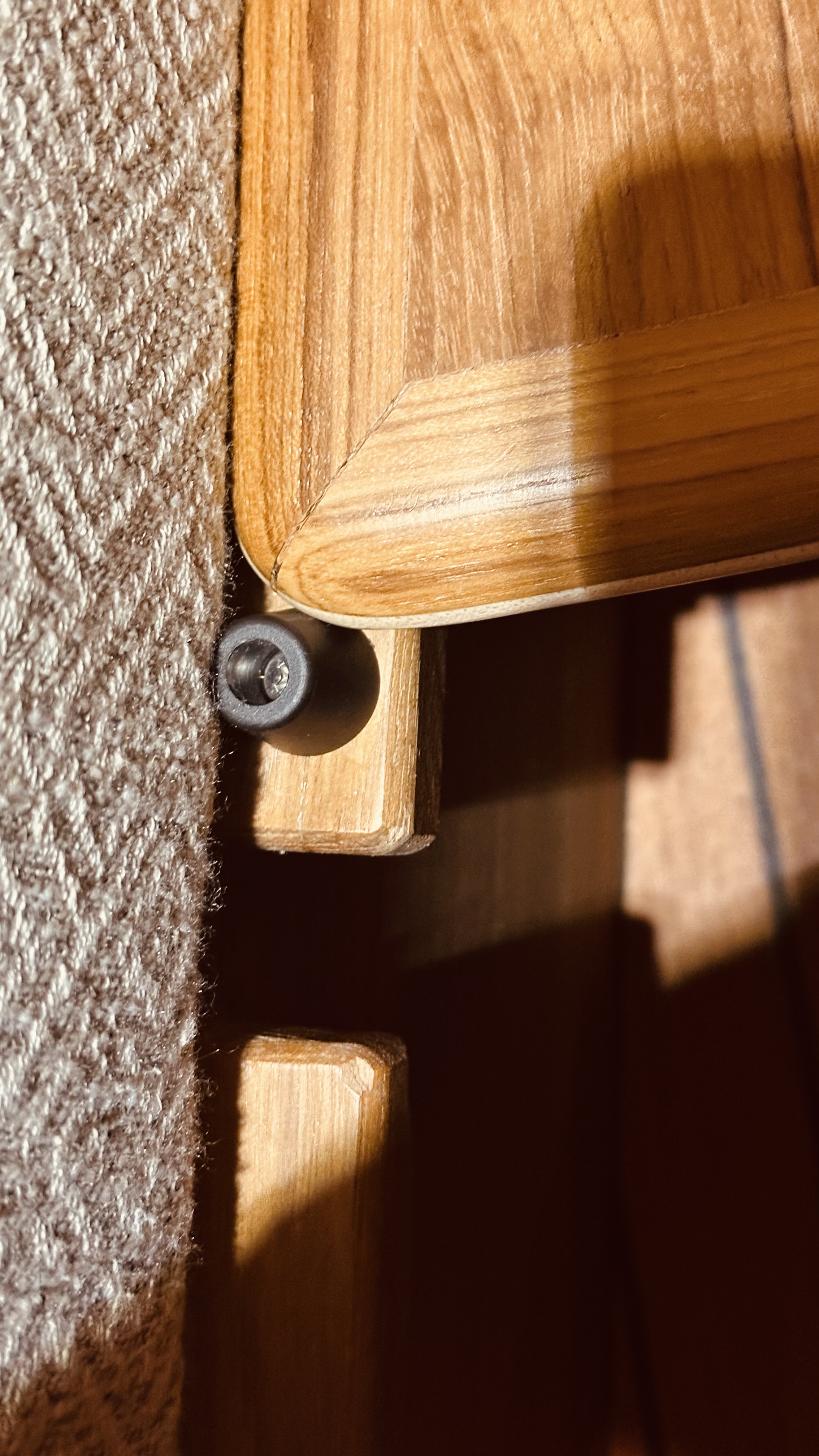

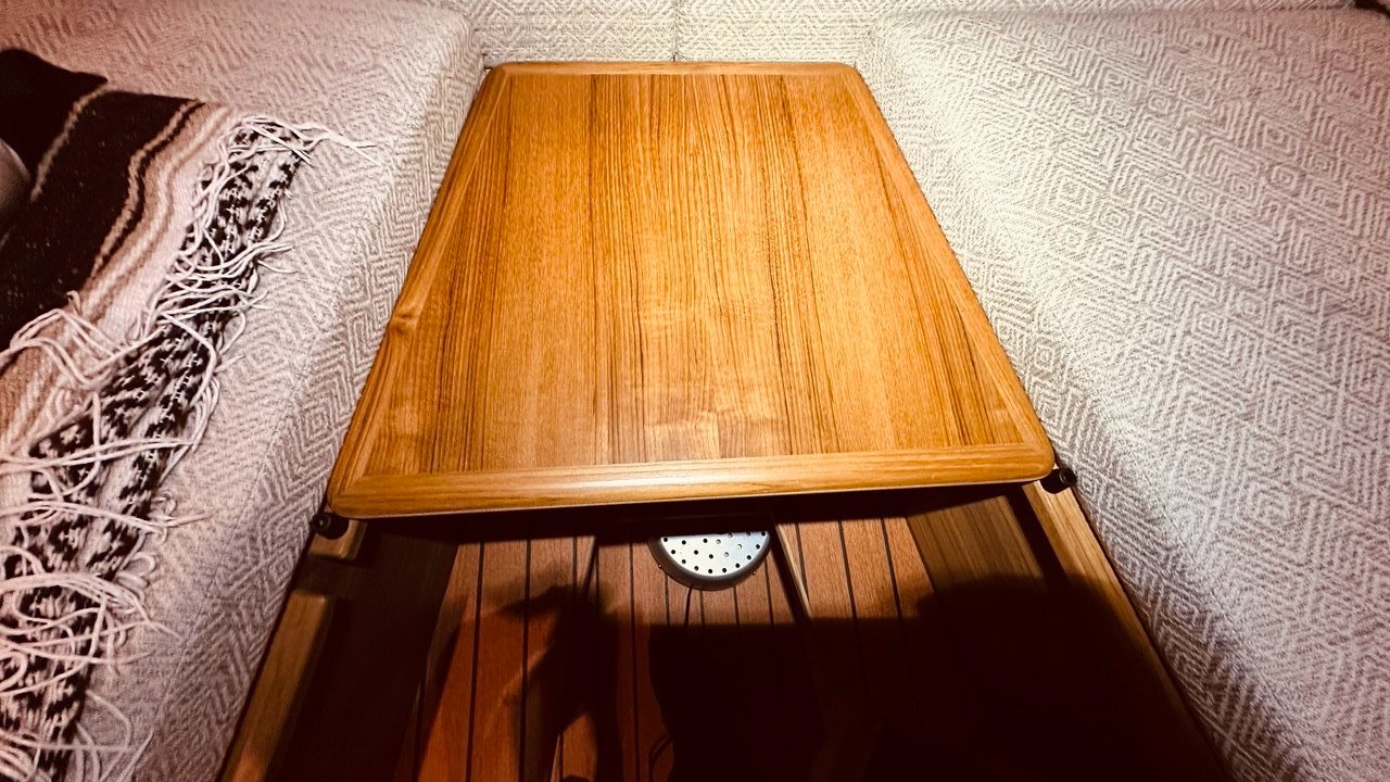

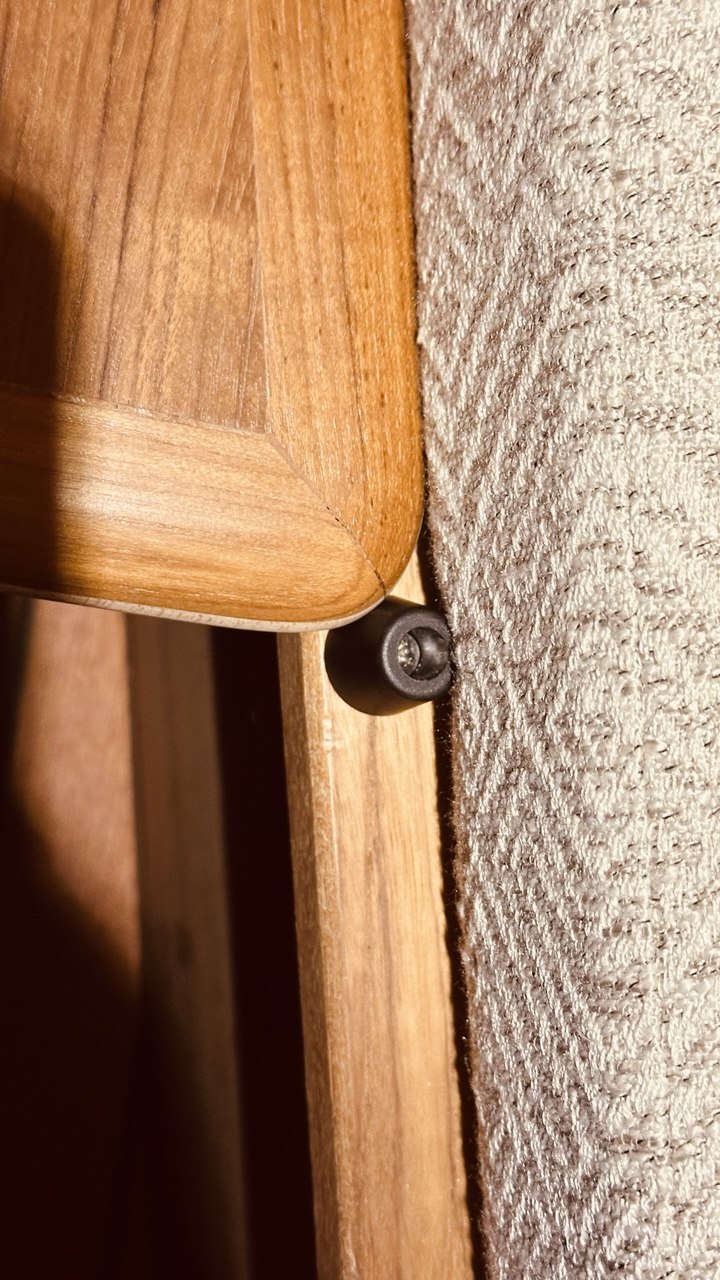

Same on our R25OB 2025. The table center section keeps falling down into the open when we see seas over 2 feet. It’s trapeze shaped with nothing holding it in place other than friction of the filler on top of it. So, should it slide back from hull vibration just a little it comes loose crashing down. It happened on our Vashon Island trip today like 2 times. Came looking for solution here, but seems like it’s a common issue even beyond our Ranger Tugs boats.
Coming back with my solution, see pictures

in my case the weight of the pad cover did not stop it down. The table surface on both sides is too slick to stay in place even under pad weight (which is negligible).

I will have the boat back in the water in about two weeks. I'm anxious to try your solution with the stoppers. Where did you get those?
absolutely great idea pisned1
