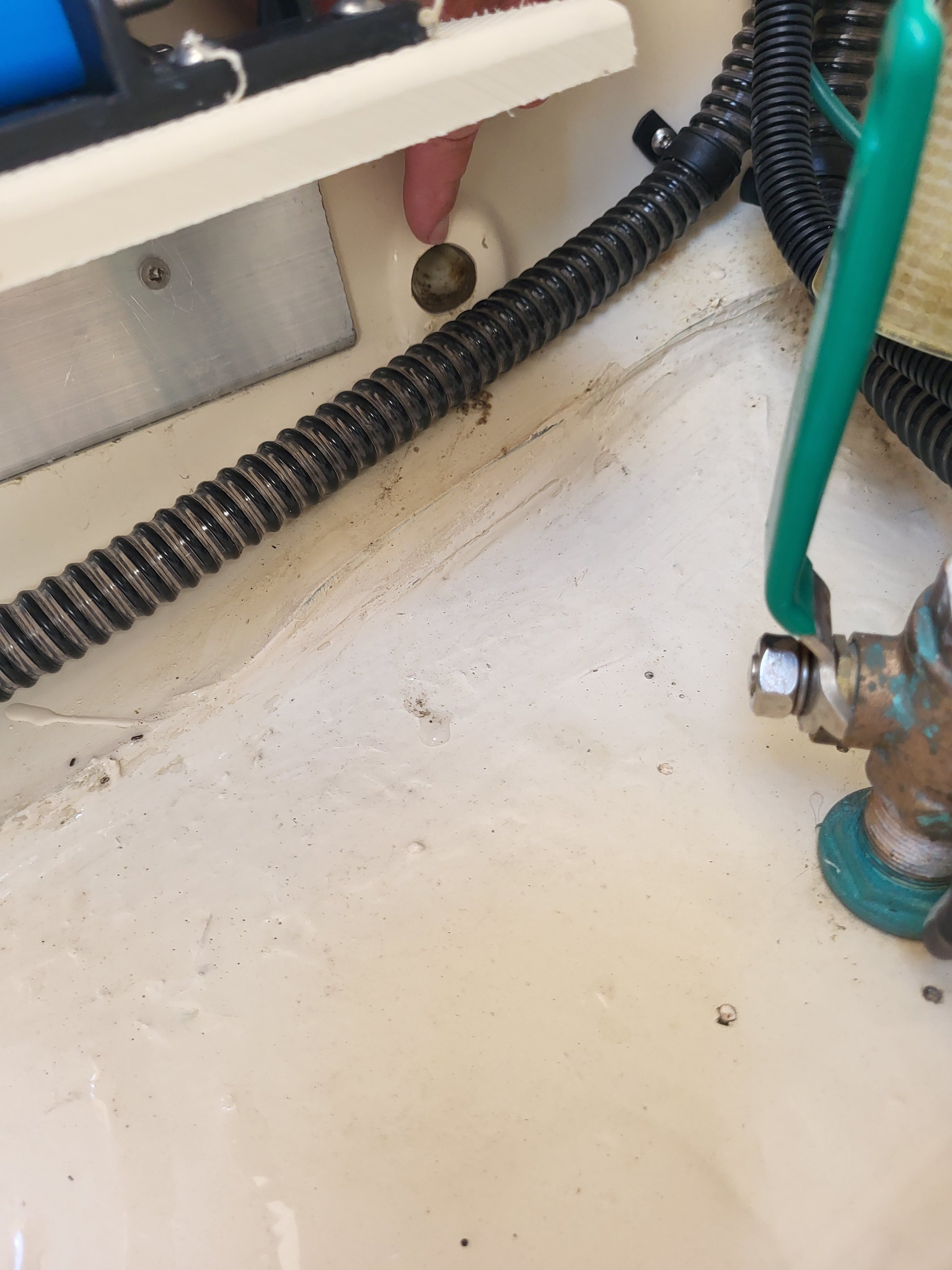

I discovered the water is getting in the bilge through a hole in the starboard side under the AC pump. Could it be the ac drain? Surely that would drain overboard. Unless it's clogged. Anyone run into this?
Looks like the limber hole that drains from the lazarettes to the bilge. On my boat, when the scupper drains can’t keep up with the flow of water, the water spills over the self drain channels, into the lazarette and drains into the bilge.
We've got a C28 so different arrangement, but, I noticed water that at first I thought was from a leak in the engine raw water intake on the port side. However, I realized that it was also coming from the limber hole that runs to the area under the rear bench seat. (I couldn't see the limber hole under the wiring at first and the water runs down around the raw water intake.) I always have some water in our bilge and as best as I can tell it's from that limber hole. When I've looked through the small access holes under the rear bench seat, there is always water in that area under the stern thruster that flows through the limber hole into the bilge. I have yet to figure out exactly where it is coming in from though.
You might want to check the cup holders, as they have drain holes in the bottom that may drain into the bilge.
