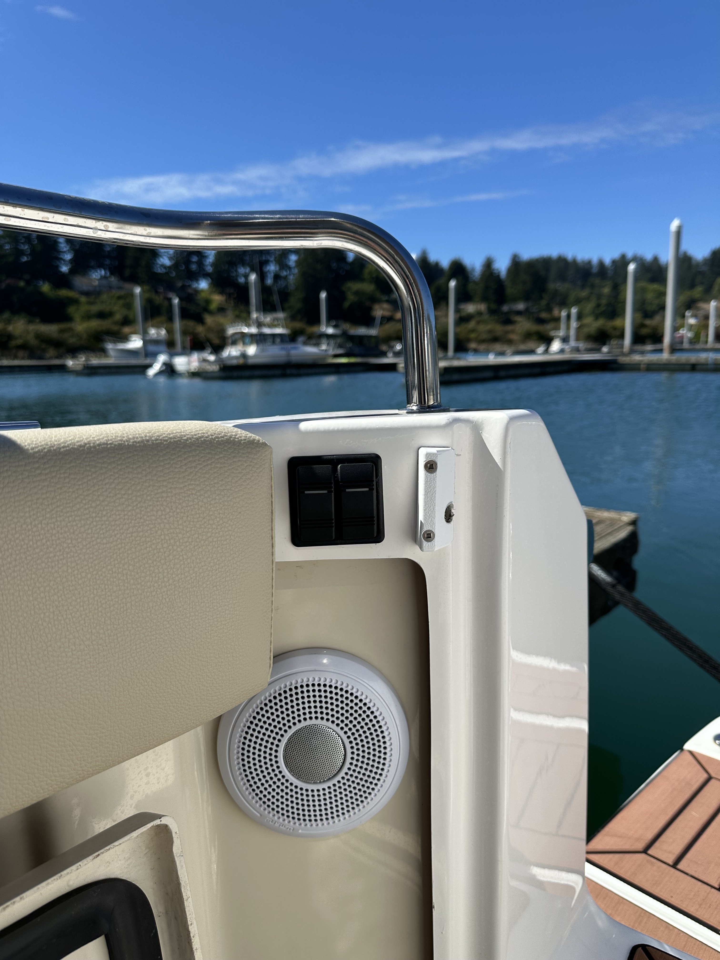

My deck lights and underwater lights won’t turn on.
Can anyone tell me where the fuses are located?
