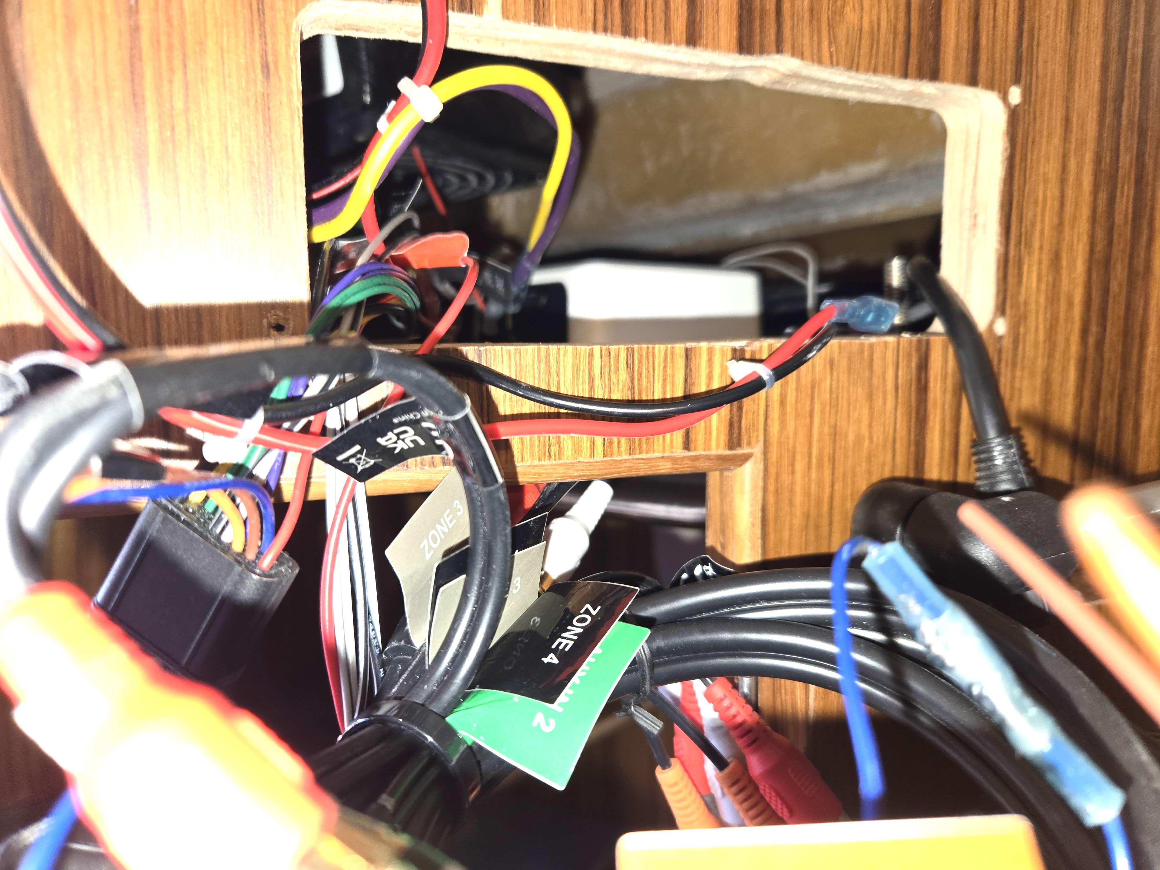

Typical install would've had one or two additional fusion zone amps mounted in the same space as the stereo head unit. Access is marginal from the panel underneath, best access is from above by removing the windshield heater/fan.
You can see the amplifier on my boat in the photo, it's the white box in the hole. It's a 2 zone. I had to remove the radio to get to it. You could try to remove the fan but you might need both access points.
