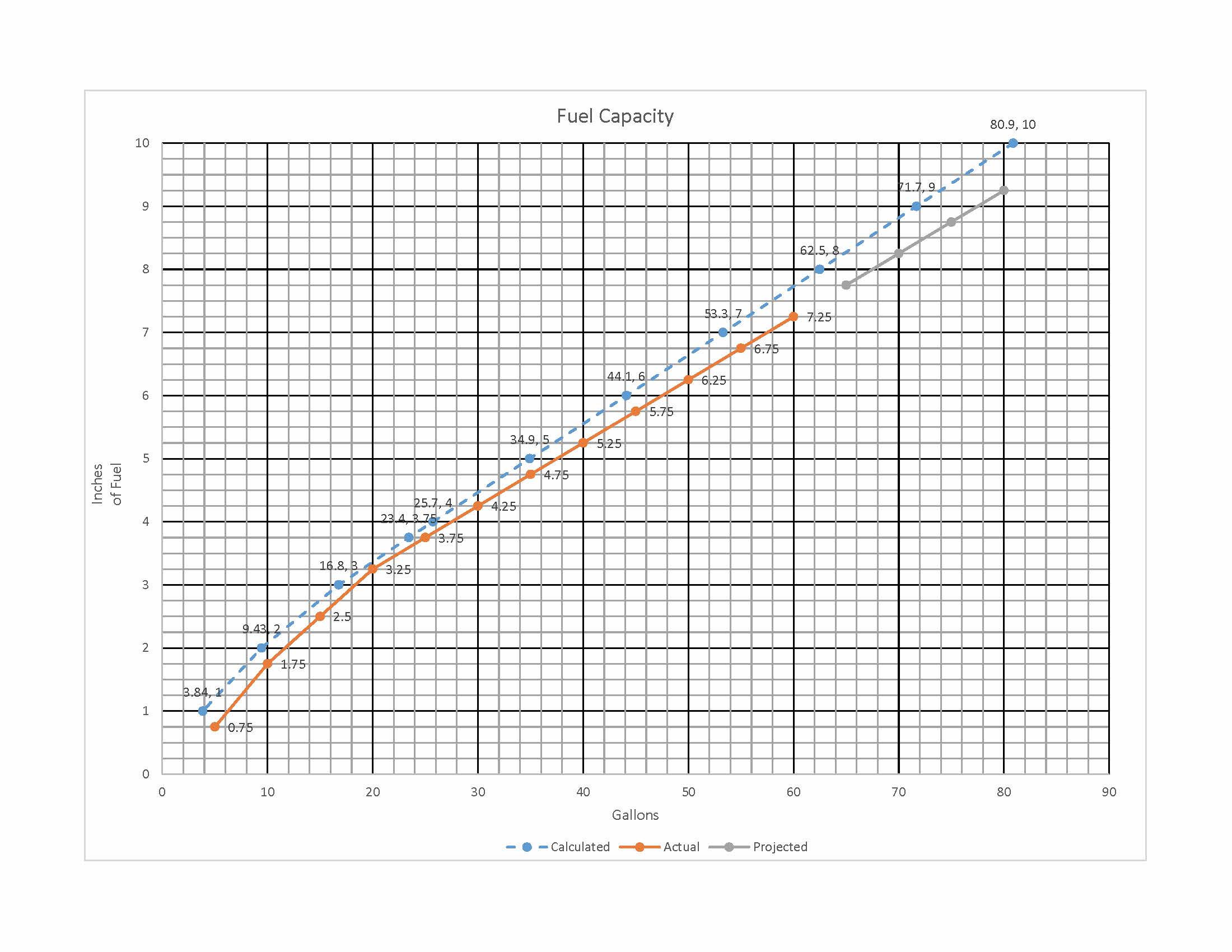

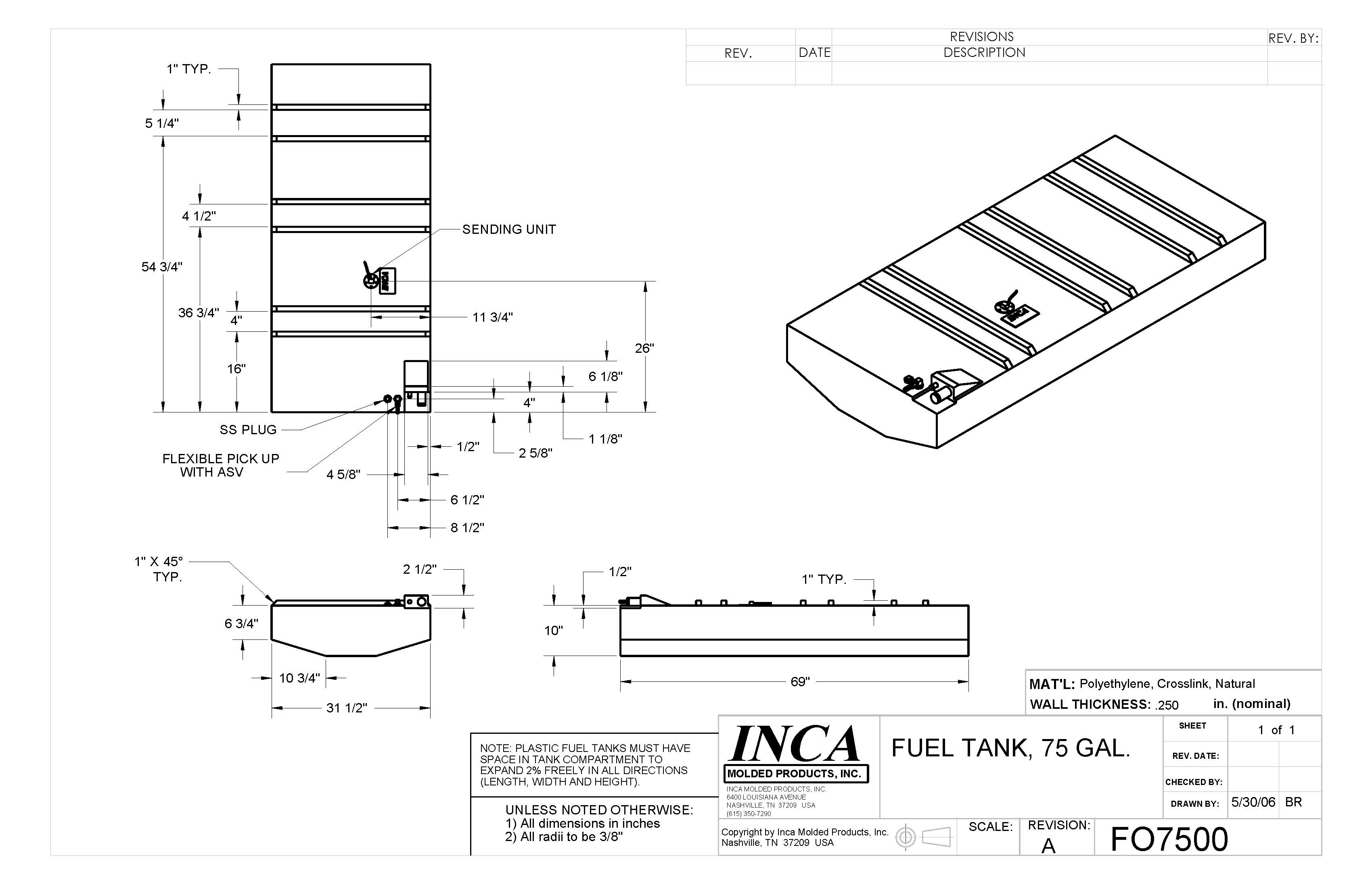

2015 R25sc. I had kinda the same "how much is really in there" issue on our Great Loop trip. When we got home, I emptied the tank using a fuel transfer pump. Tilted the boat (on the trailer) bow up to make sure all the fuel was gone. Used a bore-scope to confirm empty. Leveled the trailer and then added 5 gallons at a time. Stuck the tank after each 5-gallon increment to directly measure the fuel depth. Continued to process until 75 gallons (capacity is 80). Also got the tank dimensions and did the math. Generated a graph.
So now and then I stick the tank while level on the trailer confirm tank contents - often before and after adding fuel. I have also correlated the fuel depth vs gallons while floating at a 3 degree bow up attitude. Not much difference. Lotsa work, but the tank got a good cleaning and now I can be absolutely certain how much fuel I have.
Despite having lotsa measurements and such, there is no consistent under-or-over reporting from Garmin. Sometimes it is almost exact, and sometimes 10% of so off, both over and under. Seems to be most accurate at about 1600 rpm. There is slight correlation for under reporting (reported less fuel used)at lower RPM and over reporting (reported more fuel used) at higher RPM, when there is a long enough consistent run to kinda make that pretty hazy correlation. I always stick the tank before leaving on a "longer" trip.
