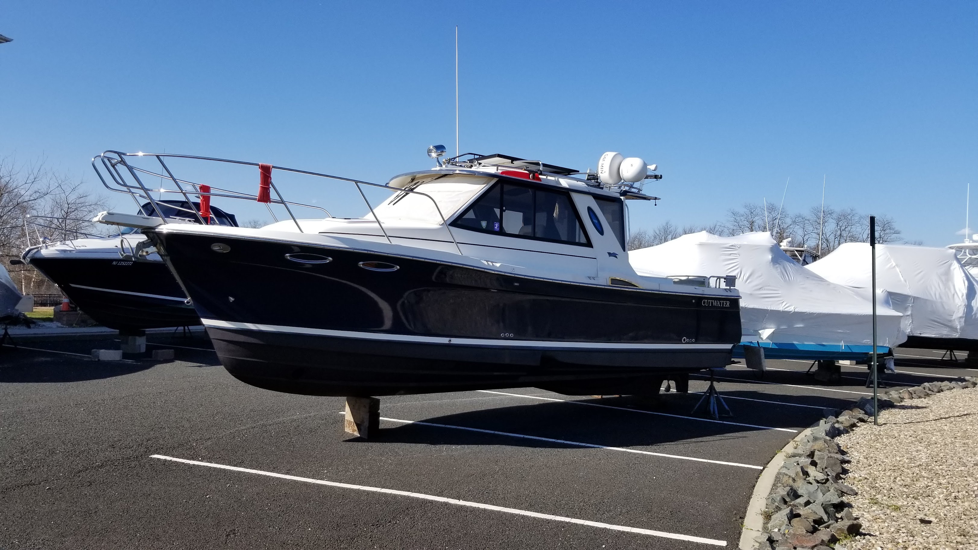

All the colored gel coat hulls require extra attention. Red is probably the most difficult. Mine is blue so I'm not far behind. I often hear people say their boat has been cleaned ,waxed and polished. One question is with what products?
Colored hulls generally require buffing. I use a Makita buffer with a wool pad and 3M heavy duty compound. I sometimes have to use super duty. Yes, its work. Labor of love for me. I don't have to wet sand with that process.
Carnauba based waxes don't work well for boats. You need polymer to provide enough protection. I have been using Collinite boat wax lately. That's a hybrid that has both Carnauba and polymer. Plenty of other choices out there, but Carnauba alone won't do it.

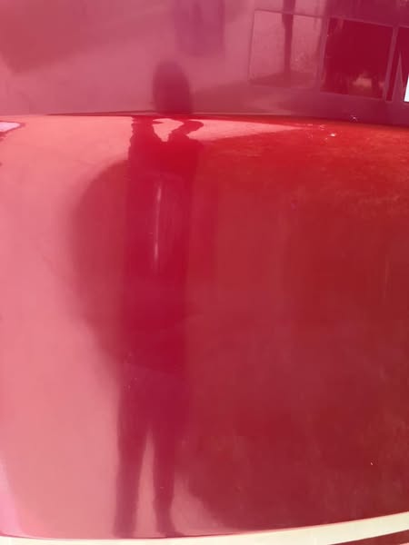

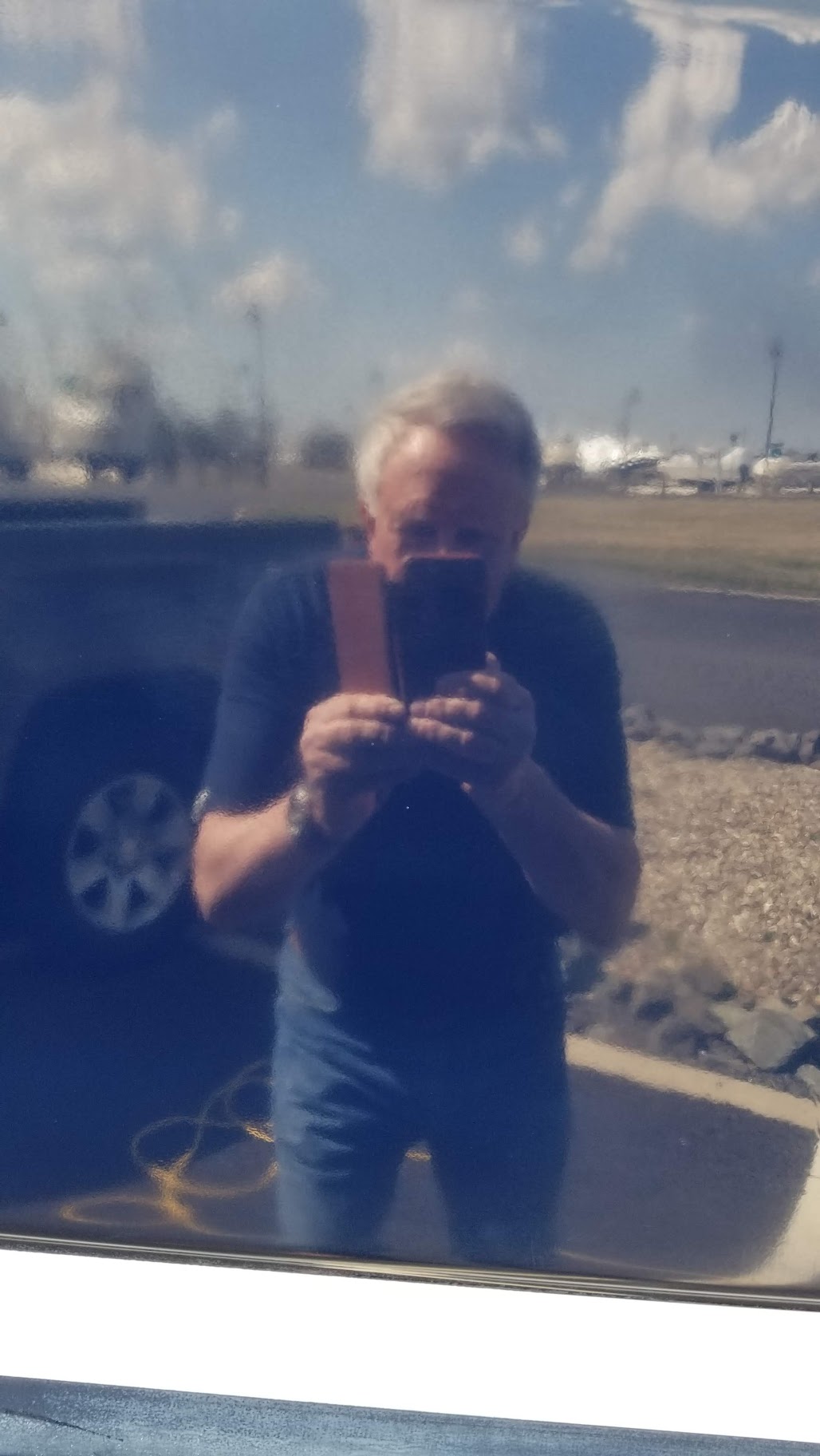

When I first got my boat, a 2013 C 28, it had all the issues you describe. Water spots, oxidation, etc. It needed I think about 10 hours of work to restore. it needs maintenance every year, which is why I do it myself.
Some pictures:
Yes, I need a haircut.

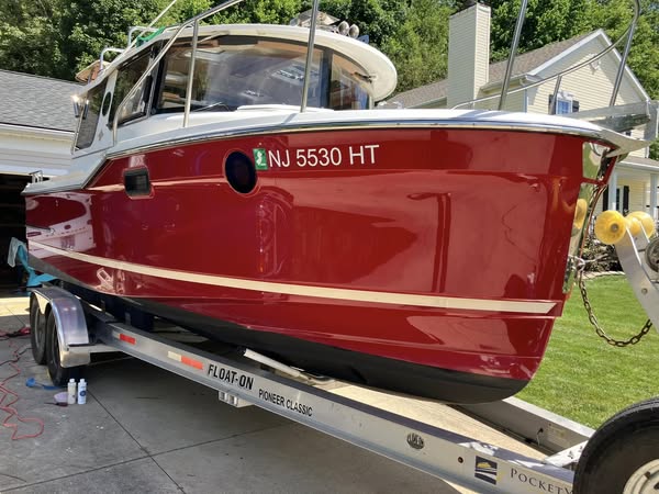

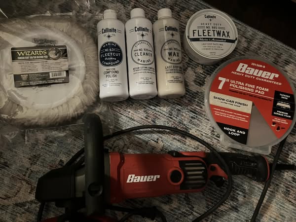

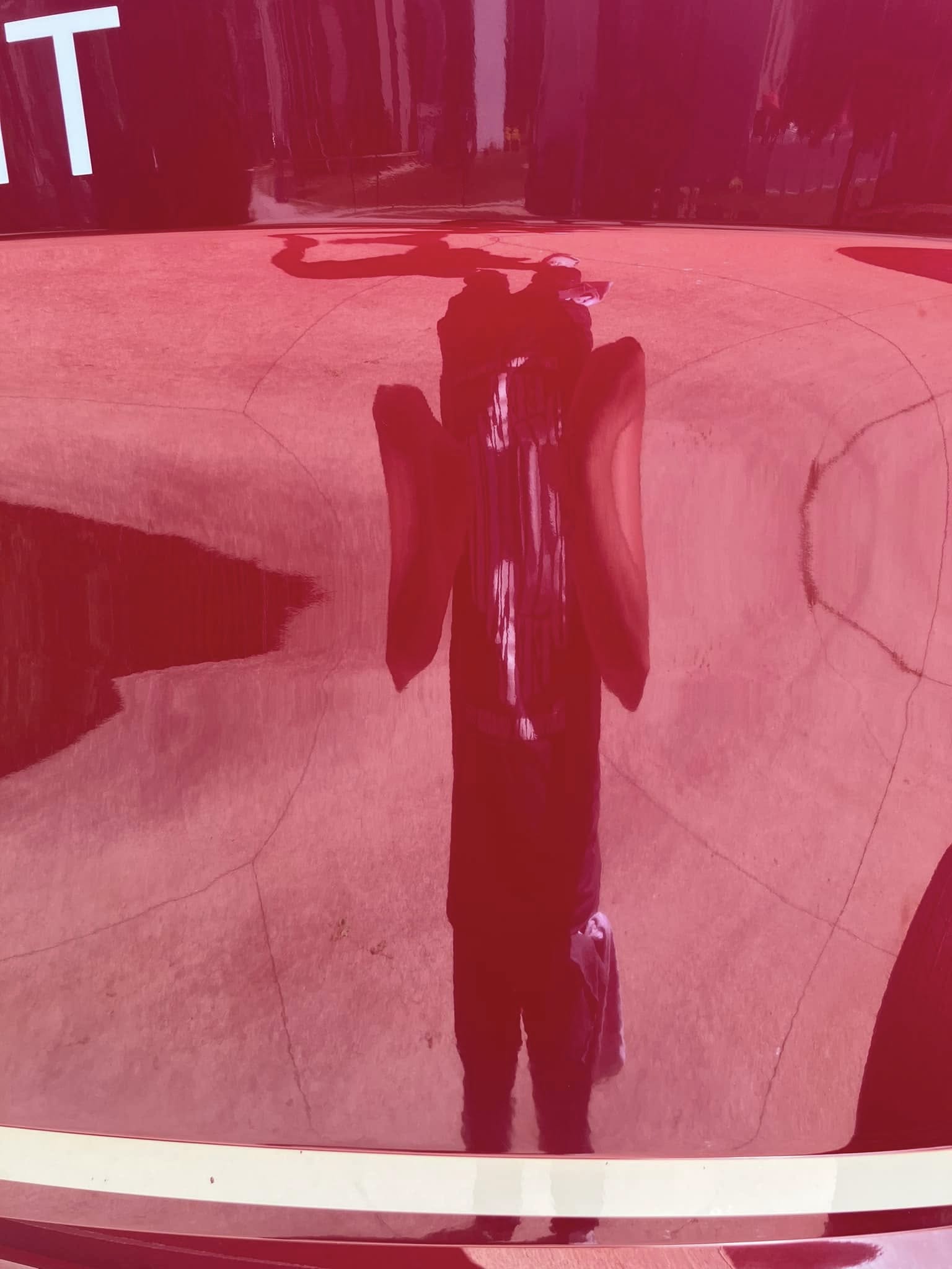

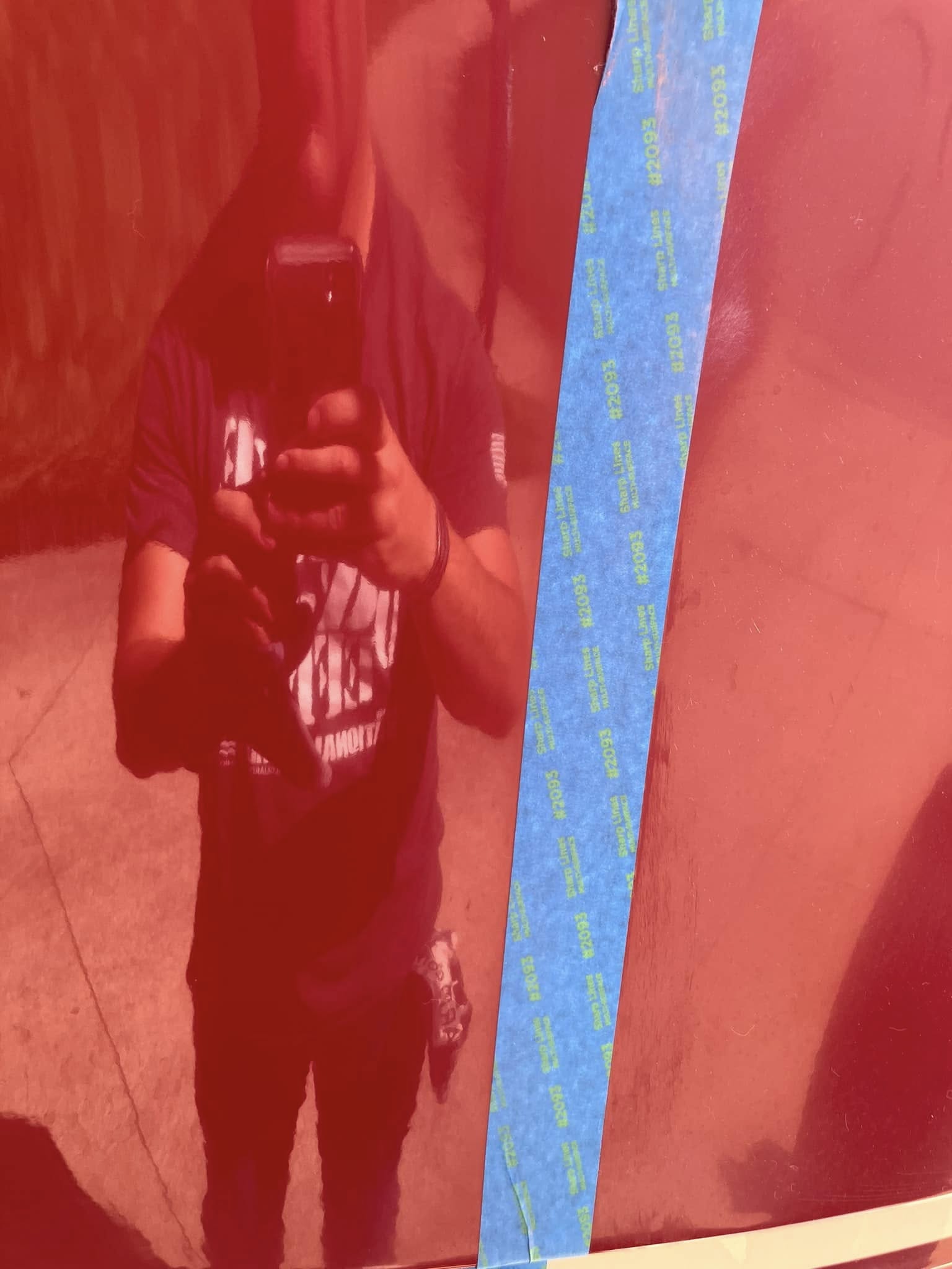

Hope this “how to” may help someone.
Purchased my boat late last year (2017 R23) and finally polished and waxed the gel coat. Had quotes over a $1000 to do it and I decided to give it a try. Did a lot of research and this method worked very well for me as a first timer.
6 hours or fun and $165 and very happy with the results.
Harbor Freight - Bauer 7” Polisher $100
Collinite 631 Medium Cutting Compound $20
Collinite 925 Finish Wax $20
Wizards 7” 50/50 Wool Cutting Pad $15
Bauer 7” Foam Finishing Pad $10
Process:
1. Clean and Dry Hull
2. Tape off 36” sections at a time
3. Start with Wool Cutting pad and compound. Apply 5-7 nickel size drops to pad.

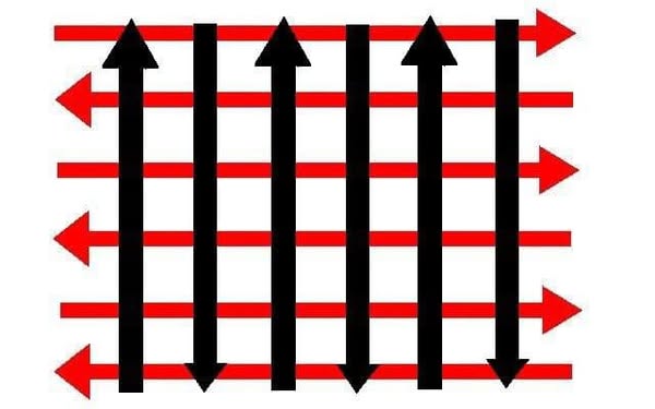

4. Stamp pad to surface and spread compound
5. Using a “cross hatch” technique at 600 rpm start your initial pad to set in compound. Apply pressure similar to pushing a lawn mower
6. Once compound is applied over area, increase speed to 1800-2200 rpm based on comfort to control the polisher
7. Once compound has dissipated, buff excess off and repeat if oxidation wasn’t fully removed.
8. Change Pads.and apply 3-5 nickel size drops of finish wax to pad
10. Stamp pad and spread wax over area.
11. Using a “cross hatch” technique at 1800-2200 rpm apply wax to surface
12. Allow wax to dry and buff excess
13. Repeat process, overlapping areas until entire boat is detailed.

Miller, I see you're a Jersey boy too! Boat looks wonderful. I have come to appreciate the Collinite products also, especially the hybrid waxes.
You need need a haircut!
