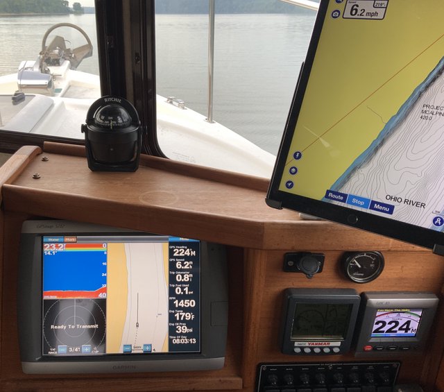

After my trip across the current, I turned parallel to the current (there was no wind) and this photo shows the results:
Heading and track are the same 224°. Magnetic compass 219° (again, magnetic compass deviation).
