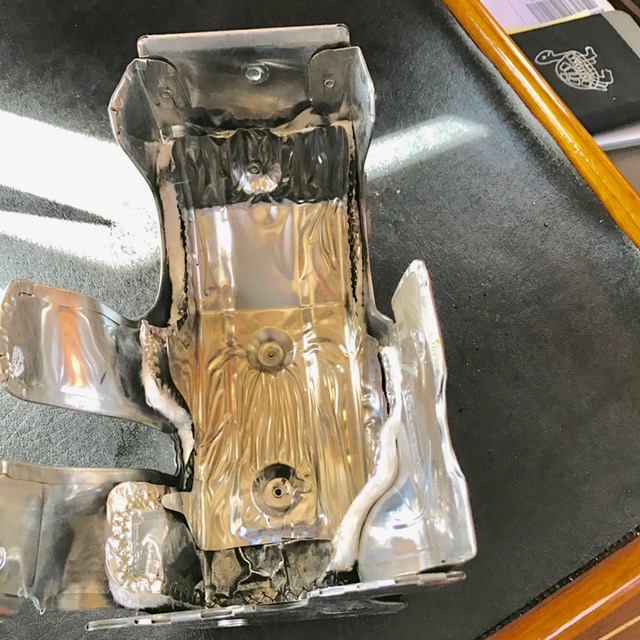

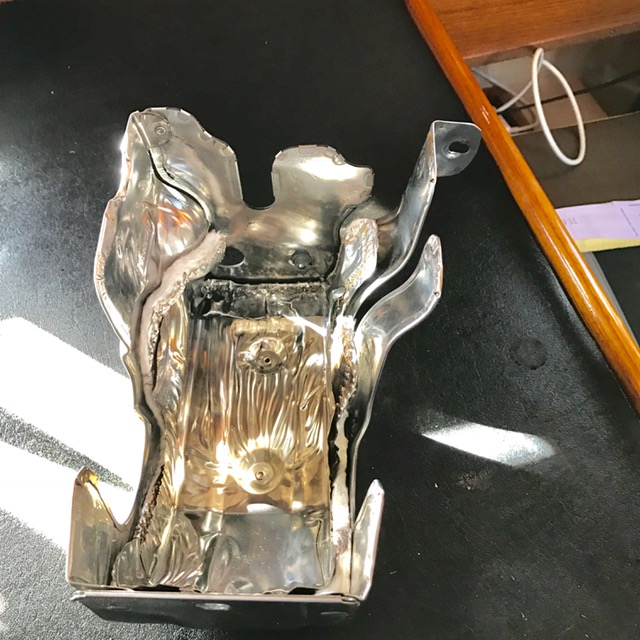

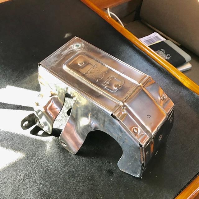

I was able to dismantle the stainless turbo heat shield on our 2012 Yanmar 4BY2. As you can see from the photo's there is an insulated heat shield mounted inside of the metal shield. The owners manual states that this should be changed once per year or every 250 hours. It appeared to be like new in my case but we don't travel fast enough to activate the turbo for long stretches of time, mostly at the end of a days cruise for a few minutes. For those that have this shield and use your turbo it may be worth an inspection.
