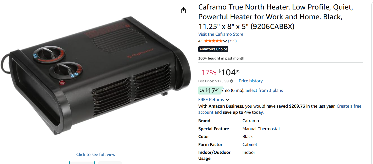

I used this heater in the cabin. I wouldn't rely solely on the heater though and recommend draining water tanks (fresh and hot water) and blowing out the lines.
I use the same one on top of my engine. I trailer my boat and fish throughout the winter months and don't want to winterize the raw water every time I come in. I put this in the engine compartment and set it to kick in if it drops below +3C. 10 years and no issues so far.

The Pacific Fisherman's Mutual Marine Insurance pool has learned from long experience that any heater with a fan is trouble. Use an oil radiator type, Honeywell or other that does not have a fan to burn out.

You know, that never occurred to me... but seems obvious in retrospect.
