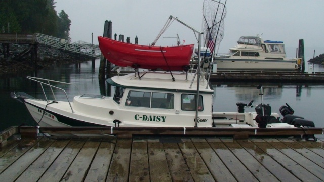

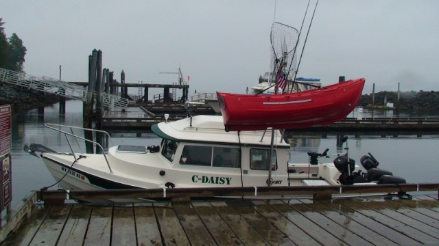

How about something like this?
That's a Portland Pudgy, about 125# I think. The davit is a Garhauer and the lower section can be made any length to adjust to the height it's gotta be.
Charlie
