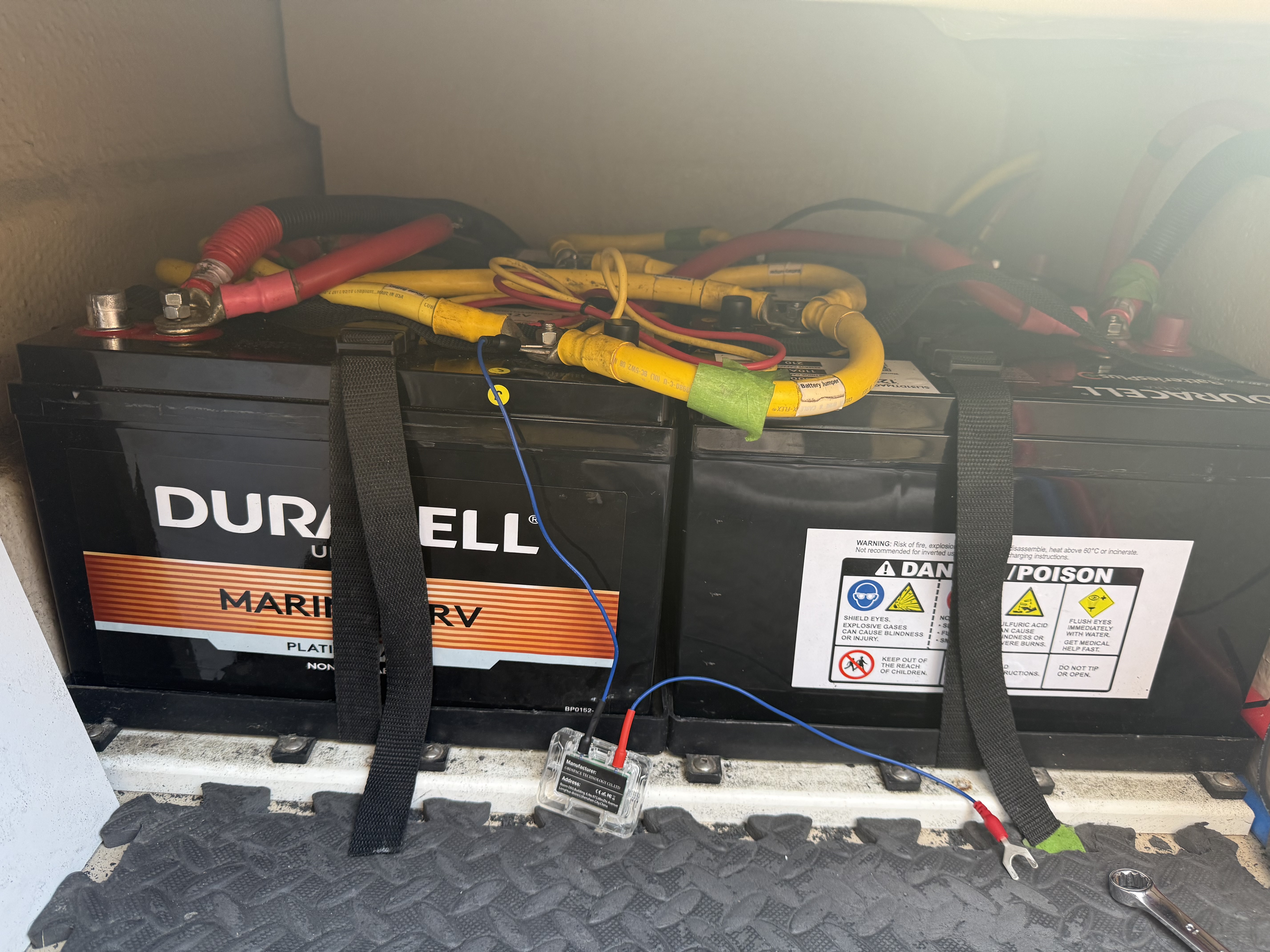

On my CC30, I have 4 Duracell Platinum AGMs for the house, 110aH each, then one for start and one for thrust. Perfect combo for my use, but as some have suggested, Oddessey have been recommended for the Start/Thrust. They are substantially more $$$.
On my CC30, I have 4 Duracell Platinum AGMs for the house, 110aH each, then one for start and one for thrust. Perfect combo for my use, but as some have suggested, Oddessey have been recommended for the Start/Thrust. They are substantially more $$$. View attachment 26714
I like it, especially the dual terminals. What Duracell battery did you use for the starter, or are all six of yours the same battery? Thanks.

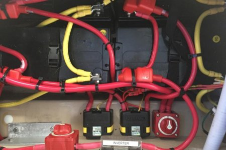

It's been a while since I had this done. (I got a technician to do it). I forget the switch make but I can check next week when I visit the boat. It came out quite neat as you can see. The On/Off switch is next to the acr's. Let me know if you still need make and model.
Okay, looks like a simple Blue Sea Systems switch. Thanks for the photo.
