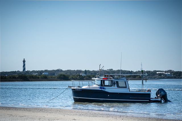

we actually make a 1200w solar hardtop conversion 🙂
DJI_0092 by Grant Wilson, on Flickr
