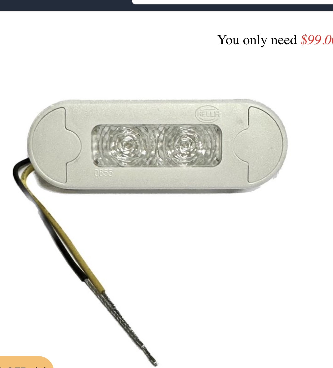

Does anyone know how to get the end caps off to replace these lights so I can access the screws and replace them? I have tried prying cutting them out. I must be missing something and the Hella site does not help at all. I have a 2018 Ranger Tug 29S. If you have any recommendations on what to replace with. Currently thinking replacing with the same.

Pretty sure they won't come off clean. Mine didn't. Needed to replace entire unit. The ends caps will pop off with some force but they will be ruined.
Yea, like demoted said, you'll need to pry the sides of with a tiny screw driver but it's going to mark up the platic, poor design. I ended up replacing them with a different brand, just some ones from amazon that looked good that were simular dimensions
I just replaced all 6. The best way I learned was to take a screw and just screw into the caps. The screw will stop after the cap and force it to come away from the light.
The Hella installation instruction sheet includes a note:
"With most mounting configurations, end caps cannot be removed without being damaged, do ensure you are satisfied with the installation before adding the end caps. Spare end caps can be purchased separately."

I replaced both this past weekend. I just shoved a flathead screwdriver into the caps and destroyed them as they came out.
