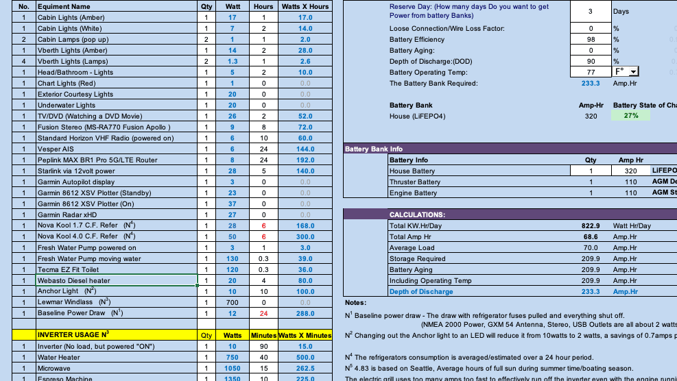

ROI, return on investment. Adding another battery is just adding another bucket to hold electrons, which gets filled primarily on shore power as solar and engine charging are considerably less than shore power charging.
Let me give you this example. I have 420 watts of solar. I have 320 amp-hours of house battery bank. My boat uses 100 amp-hours a day. My solar panels provide me over 100 amp-hours a day, every day. It's like adding a battery that recharges itself daily.
I have a power management spreadsheet available to let you play with the numbers so you can see the difference solar makes over adding more batteries.
