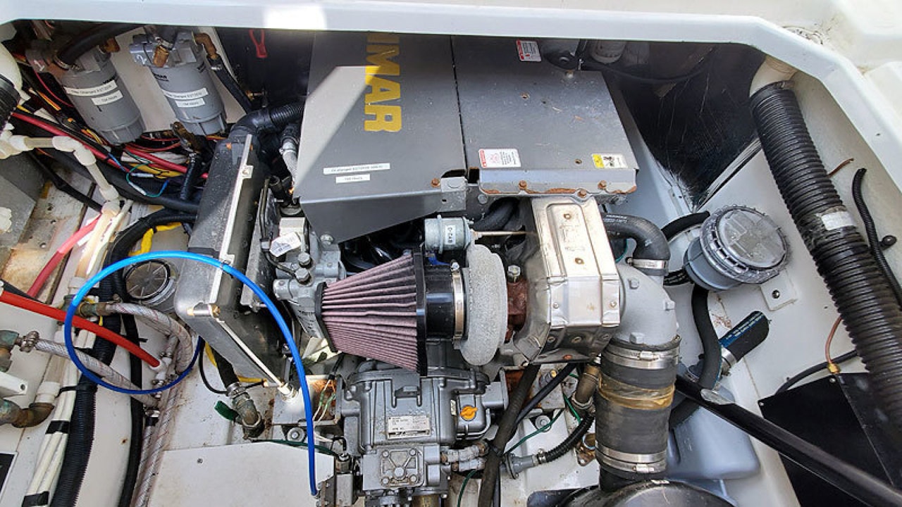

Do the Yanmar engines have the same issue?
Based on the photo below the installation of the Yanmar is the same as the Volvo. Read this article posted by snydzy
snydzy":28zzvqut said:
I’ve posted this link before: https://www.sbmar.com/articles/designin ... st-system/
I believe if you take the measurements discussed in this article you will find the installation to be marginal at best. This doesn't mean you will have an issue.
https://unitedyachts-iyba.imgix.net/ima ... lossless=1
https://cdn.yachtbroker.org/images/high ... d53_97.jpg
I have a Yanmar and have never had hydro-locking issues. I've only been towed once and closed the raw water intake to ensure no issues.I've looked at the exhaust installation and it is to spec, not marginal in my case. I do have any early Ranger R-25 (15 years old) with a Yanmar 4jh3-dte.
