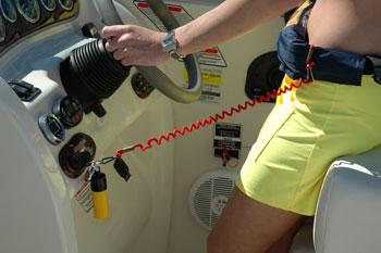

Hey Captain Steve,
You do have a kill switch! On a 2009 R25 it's that red dongle on the helical (I love that word) key chain next to the ignition key. You can see it near the thruster controls in the photo below. You are supposed to attach the lanyard to your body (I advise anywhere except clipping it to your nipple) so that if you move a couple feet away from the helm it pulls the plastic doohickey out of its receptacle (I love those words, too) and kills the engine.
This makes good sense when sitting in your dinghy with the lanyard attached to you and your 2 hp Honda. If you fall out of the dinghy it kills the engine. It also makes sense on an open cockpit boat when single handling to prevent death circling, like here:
