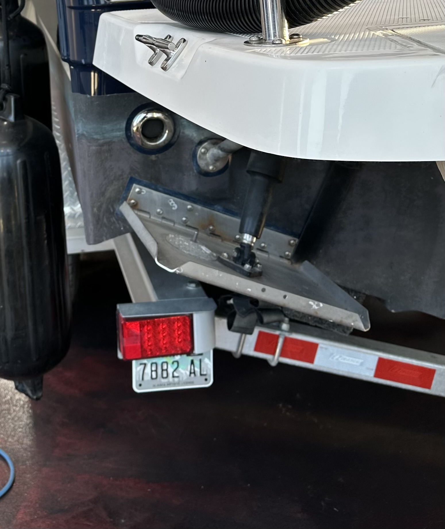

I want to upgrade the Lenco tabs on my 2019 R23 to the Lenco Pro Auto tab system. This requires an actuator change. Can you tell me the actuator size that was used on that model? 10" pin to pin 2.25" stroke? The other size is 12" pin to pin and 4.25" stroke.
Here is what I found out about the tabs on my R23. They are not considered standard Lenco tabs that are installed at the Ranger factory. I assume they were made to spec for Fluid Motion. If you would like to upgrade your Lenco tabs to the Pro Auto system and you have tabs like mine (see 11 screws holding the blade hinge to the transom) you will need to have a Lenco dealer special order this part from the Lenco factory P/N 15222-108. This will allow you to keep your current blades.
