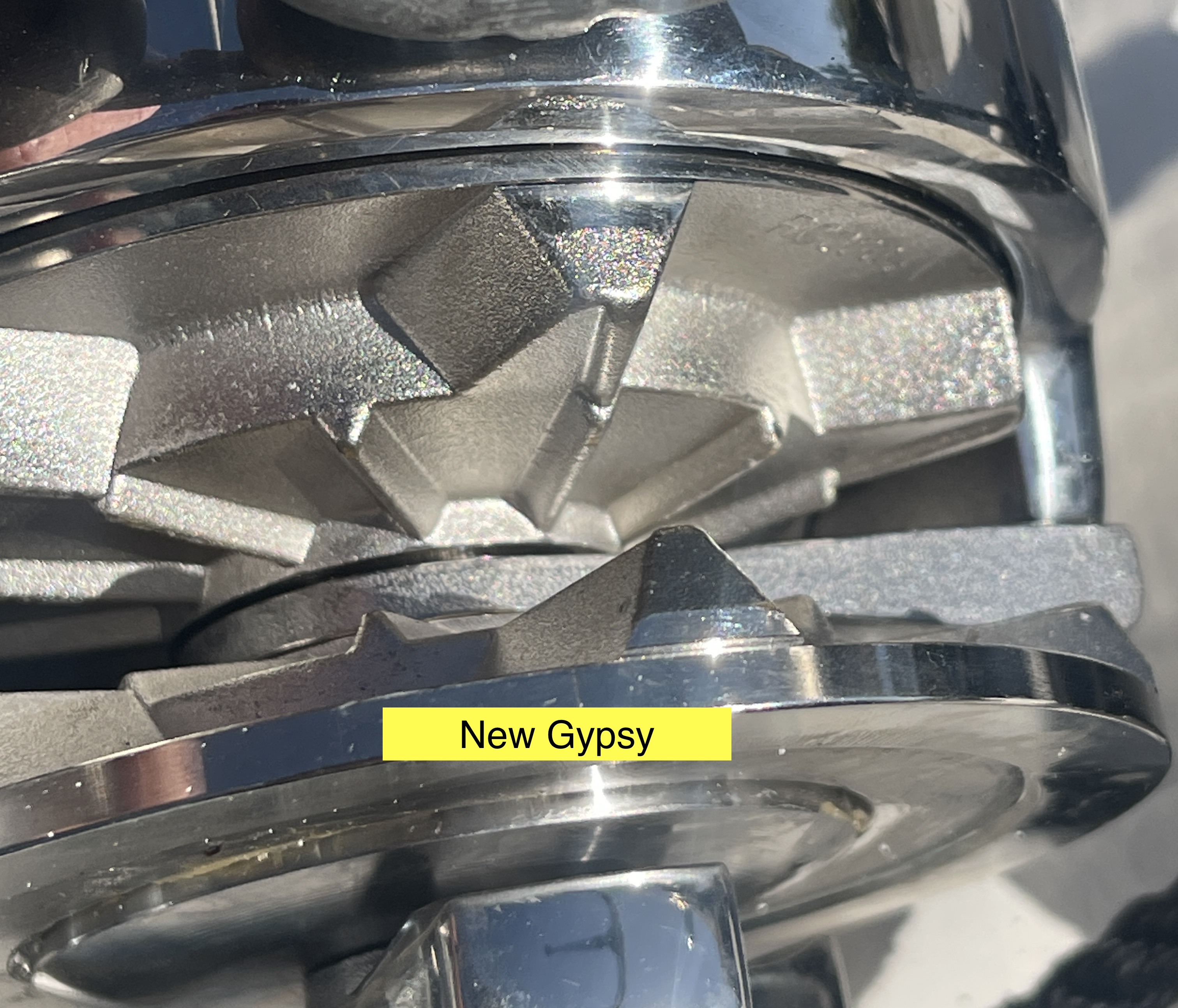

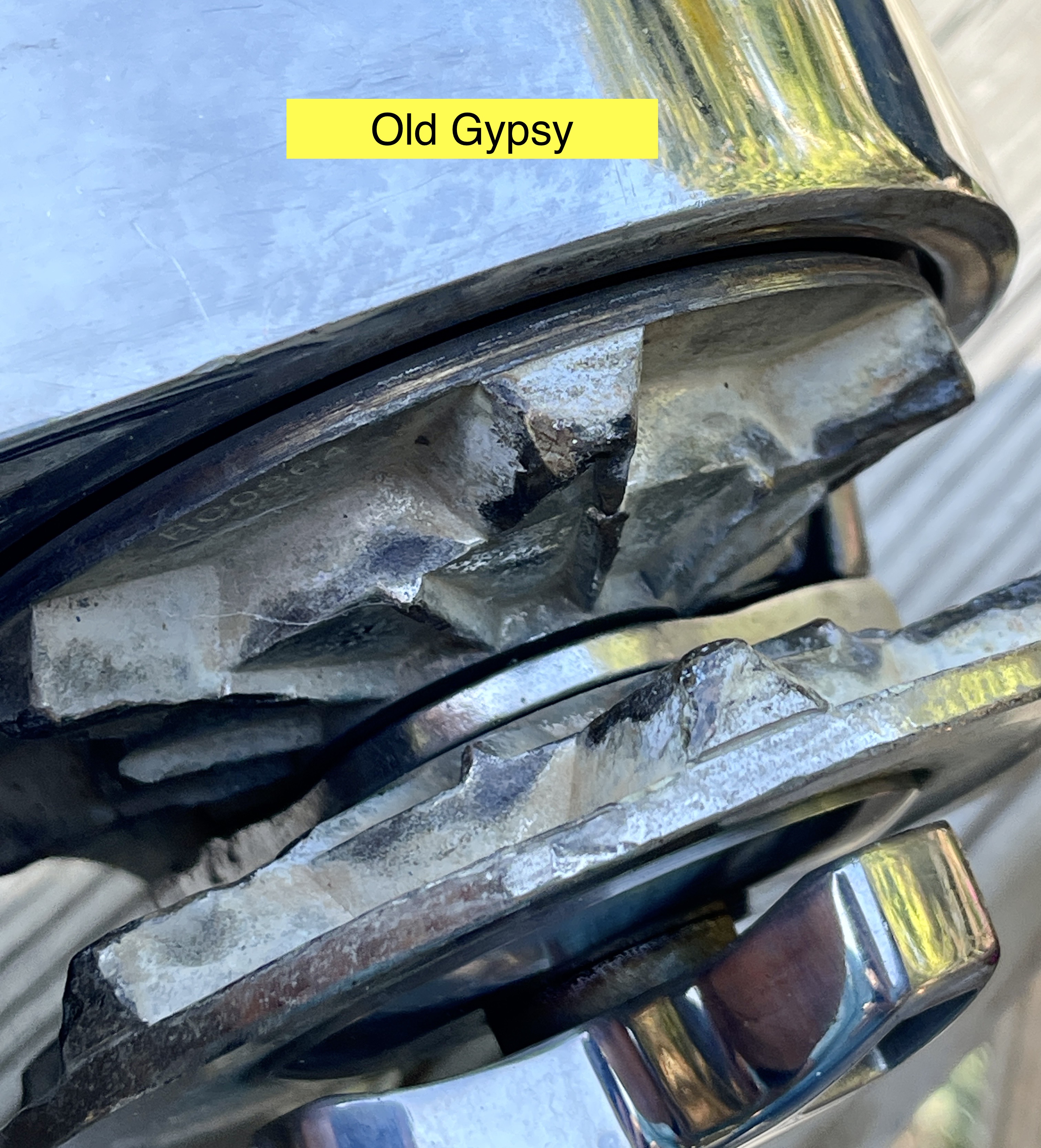

When the new windlass came and I saw the new gypsy, I was doubly glad I bought a new windlass. My Ranger Tug is the first boat I have owned with a windlass and I just didn't realize how worn out the old gypsy was. See the pictures.

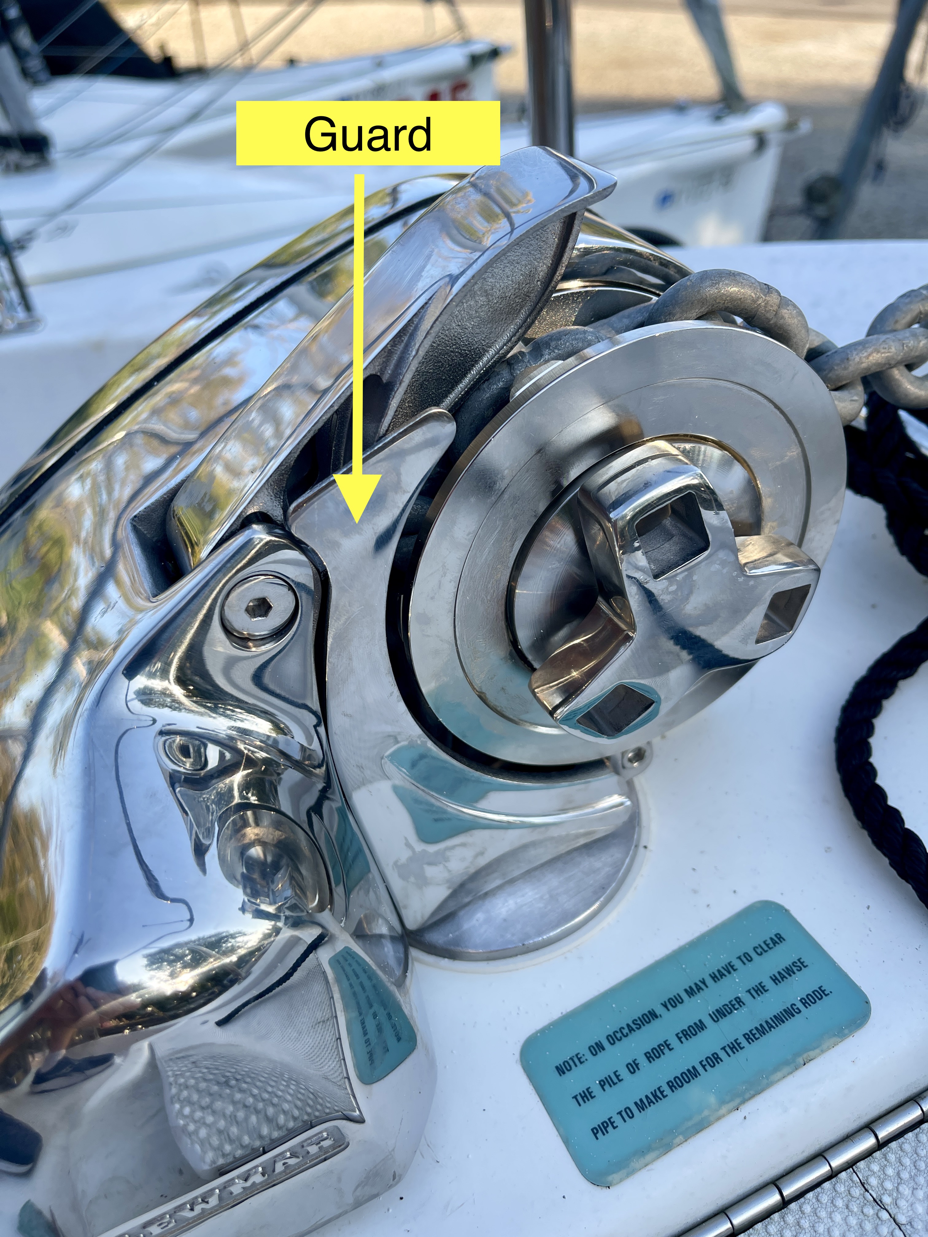

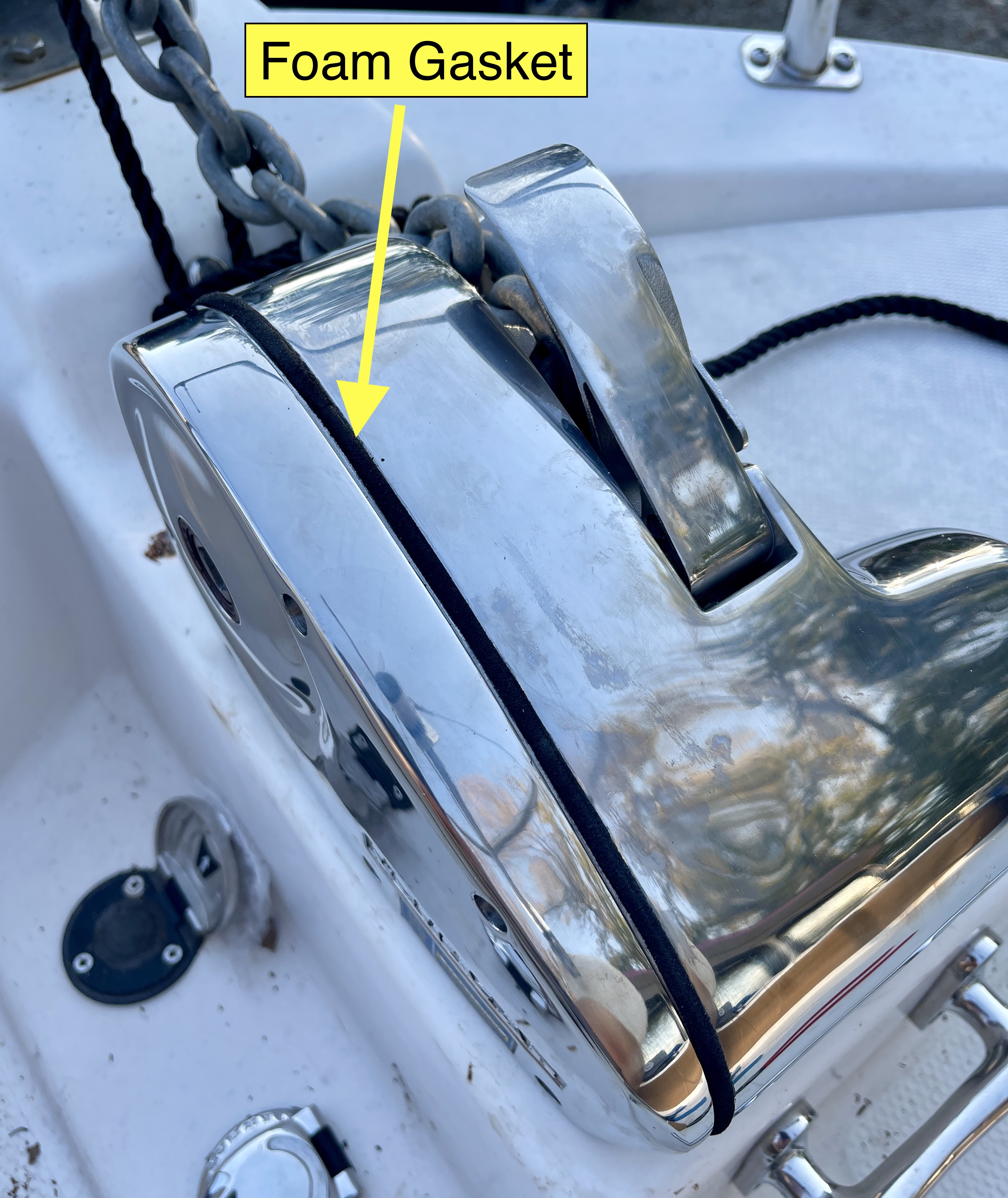

The new windlass has a thick foam gasket between the gear case cover and the windlass body. There's also a guard on the opposite side of the windlass from the gear case cover that may keep water out of the body. The old windlass did not have that guard. See the pictures.
