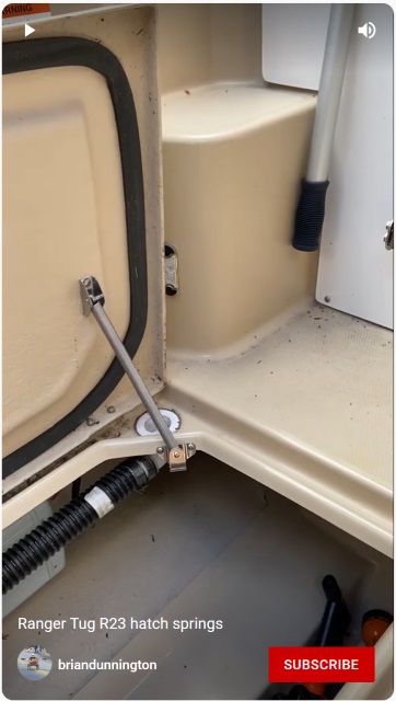

I decided to use a hatch spring instead of hydraulic arms on my R23 because 1) they were available, and 2) I thought they were clever in how they worked.
Here is a ~10 second video showing them in action: https://www.youtube.com/shorts/XxLzs_DAVgU
I use the hatch springs on my C242 and they work great.
were you able to mount the hatch spring the the hatch with out drilling all the way through the hatch. Im guessing just some stubby screws work?
correct - the hatch fiberglass is thicker in the middle (the part around the edge is thin to allow room for the gasket/etc), so i just used some short screws that didnt go all the way through

Didn’t work out. Removed them.
What was the issue, ie are you giving up on hatch springs, or just those specific ones?
on my C-28, the shape of the hatches and the flanges are not ideal for a spring setup. I’m using bungee cords on the hatch handles going to the cockpit stainless rails to hold the latch doors open when working inside the compartments.IMG_6298.jpeg
