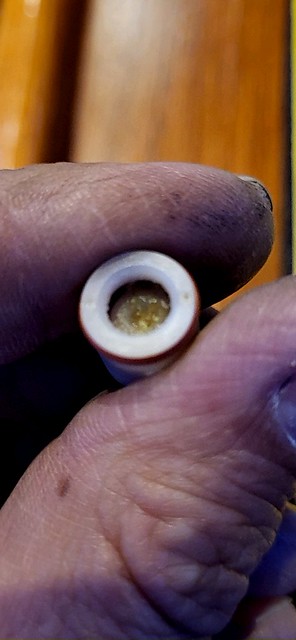

Here's the anti-siphon valve from the base of the flexible hose where it connects with a brass fitting under the galley faucet. To reach the valve, remove the phillips head screw and the brass fitting should come free from behind the sink. Remove the brass fitting from the flex hose to access the valve. Once the hose was removed from the fitting, I was able to remove the valve with a small bolt as a punch.
Once the filter and the corresponding rubber washer is out, scrape the ends clean, run some water over it to remove the loose particles. Blow through it in each direction just to confirm that it is no longer clogged, then toss it to the bottom of the nearest garbage can.
Reassemble the hose without the valve and washer, using a bit of teflon tape to ensure a proper seal and replace the screw. Remove the sprayer handle and turn on the water to blow out any crud that has accumulated in the line behind that pesky valve.
Please excuse the dirty fingers, getting that tap out and back in was a journey.
