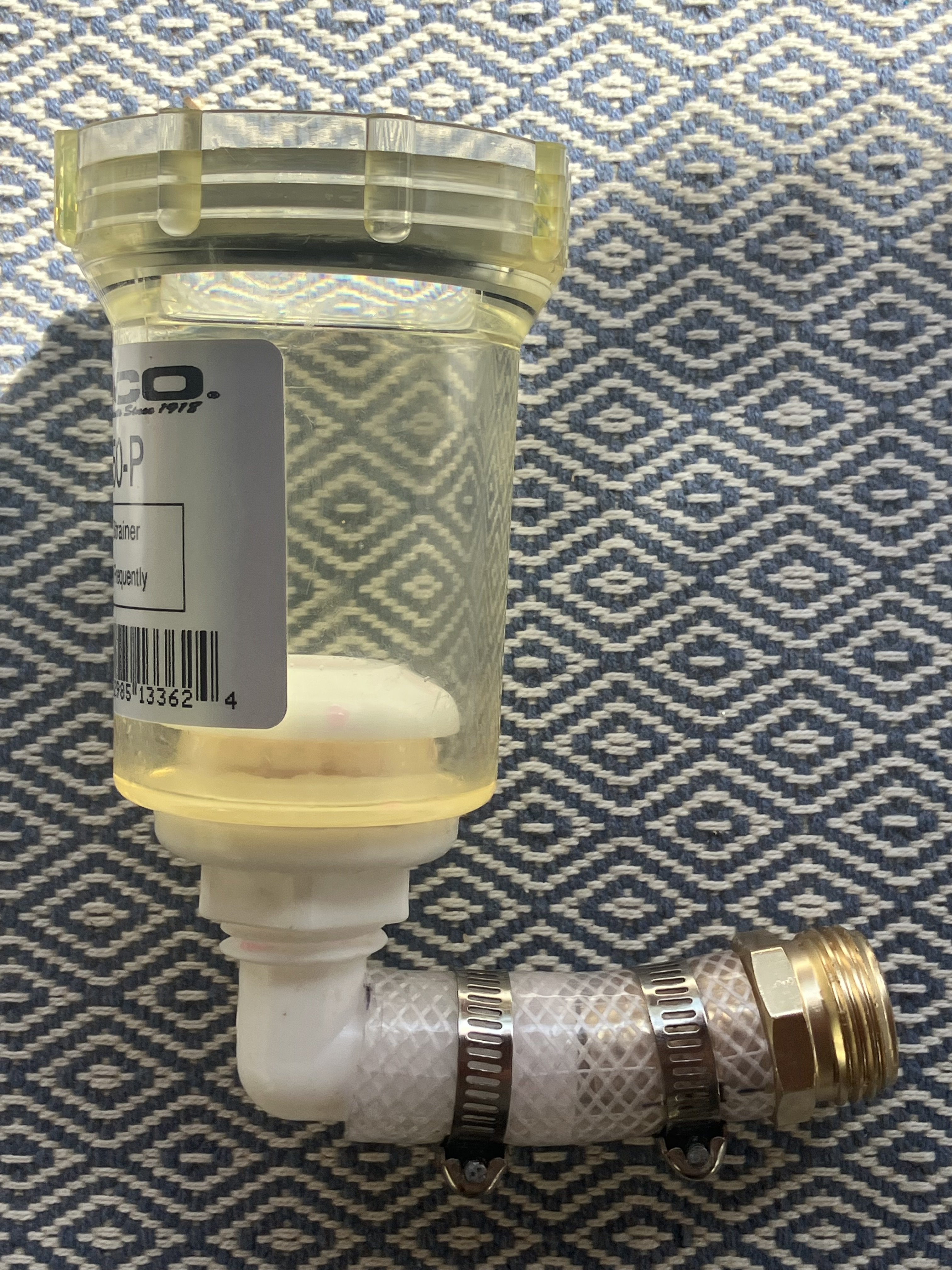

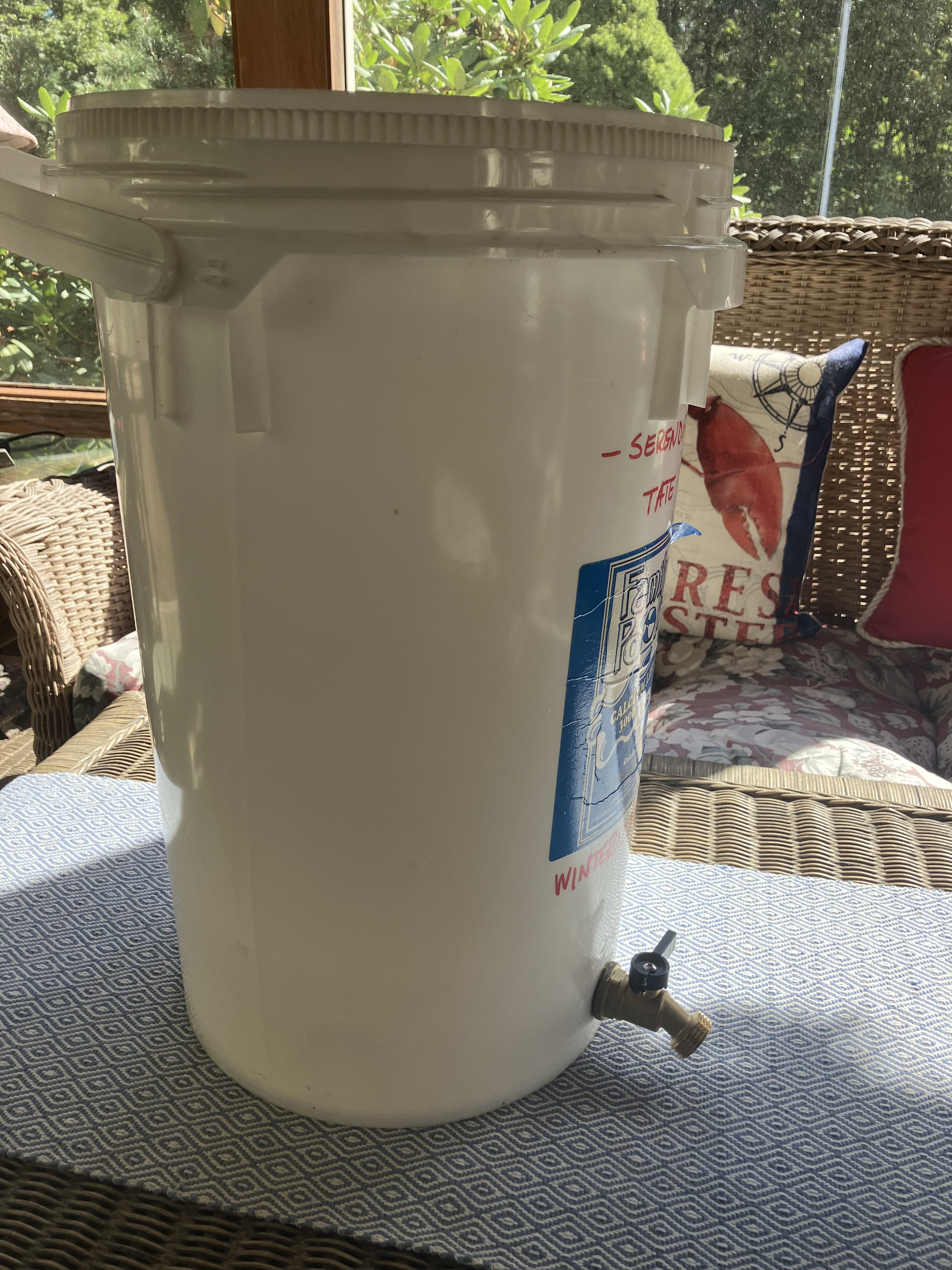

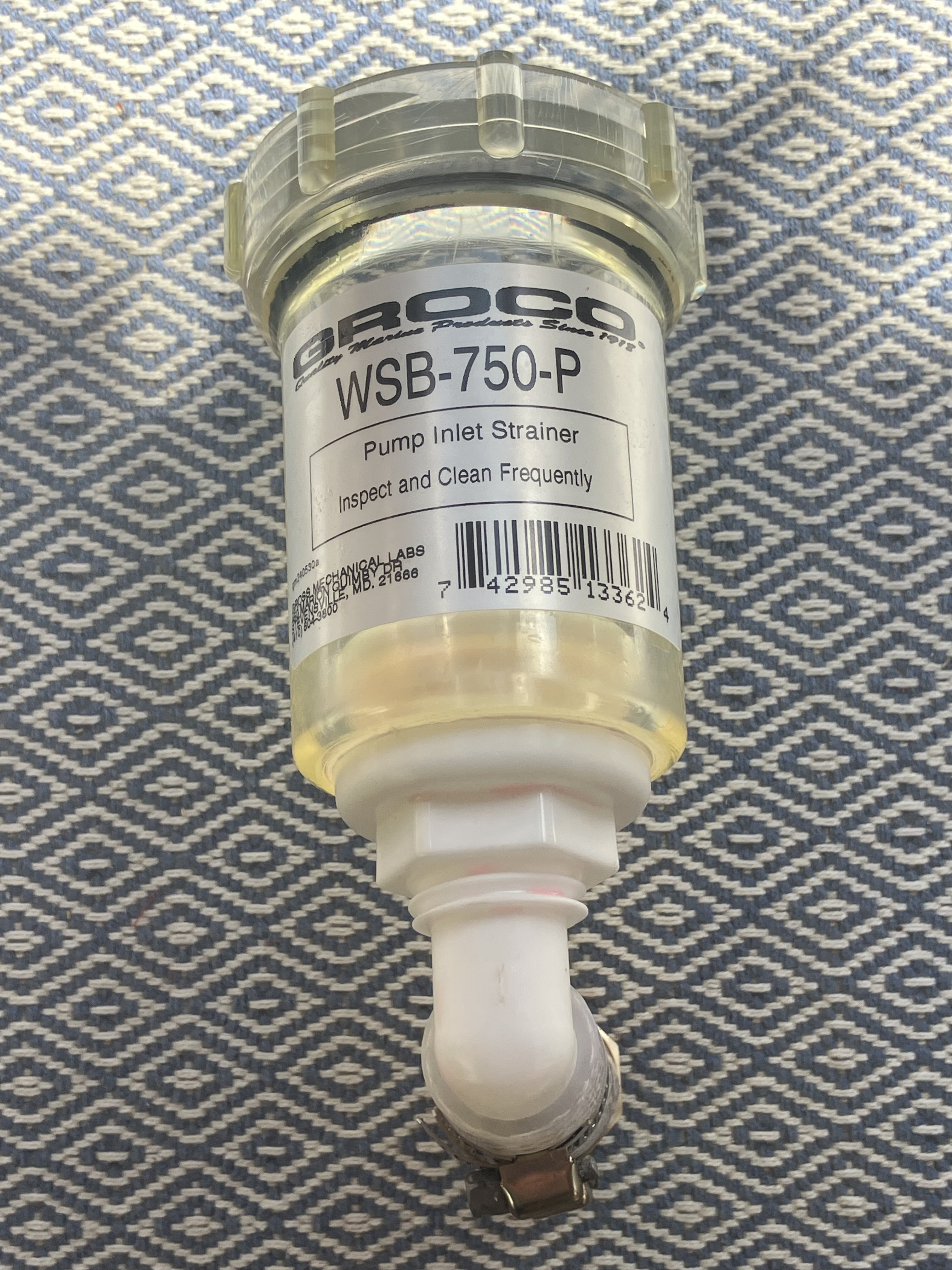

On our 2023 R27 OB, I made a “flushing bowl” out of a spare strainer bowl. To winterize with “pink”, I connect a bucket to the flushing bowl via a hose. The bucket has a hose bib in it. With the bucket up on the grill lid gravity can help. I use this for the A/C and deck wash. Our head is fresh water flush.View attachment 26569View attachment 26570View attachment 26571
That spare strainer bowl idea is fantastic! Makes winterizing a one-person, rather than two-person job. I've been looking for one of those strainer bowls online and they are not inexpensive...at least $50, unless you have a source I don't know about....?
You are correct about the cost. However, if we amortize it across several years of use the “investment”, it’s not so bad. Being able to DIY boat maintenance helps .
Yes, I agree...it's not all that much spread over multiple seasons. I will also be able to use it to treat the head and washdown with vinegar when they get that funky raw water smell.
Do you have any details on the parts you installed in the bottom of the strainer?
