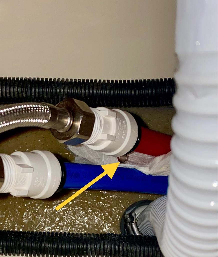

On my 2021 R27 I had a small drip from the PEX fitting under the head sink when the fresh water line was pressurized ( pump switched on, even if not running). It pretty much stopped dripping when the pump was switched off and the pressure was released by opening a faucet. I had to disassemble the fitting, lube the o-ring, and push it together again. Very cramped under that vanity, by the way. Might you have something like that going on?
