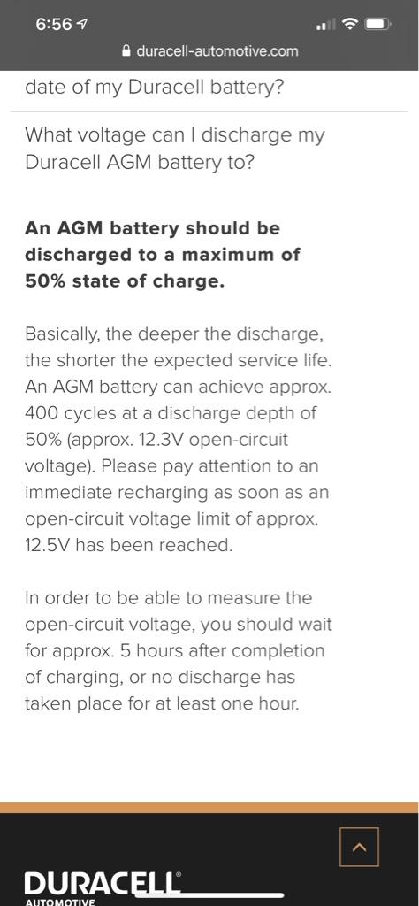

In your case this is true to the point of your issues. You have experienced problems with your engine and thruster batteries which generally do not get a slow full discharge. The engine battery and thruster batteries are used as a quick high amp discharge and then recharged. Many times in this case the engine battery fails early because it was under sized for the application. In your case a Volvo D4 requires a minimum of 900 CCA or 1100 MCCA. If you install a properly rated battery for this application AGM maintenance is limited to cleaning the connections keeping the battery tray dry, and confirming properer charging cycles from the battery charger. The same would hold true for the truster batteries too.
The case of the house bank may be a little more complicated. The batteries are discharged at a slower rate and for longer periods of time. With AGM's you want to make sure that they do not go below 50% discharge and when at 50 % discharge the batteries are recharged soon after they are at 50% discharge. Normally I like to start charging the house bank when I see 12.4V and do not let them go below 12.2.

Actually 50% or less if done frequently will kill them. I have by mistake had my batteries at 11 V which is 100% discharge a few times. I thought for sure they would be toast! That was 3 years ago the first time and it has happened a few more times after that. Did it hurt them ? Maybe! Do they still function ok ? They did when I sold the boat and had the Northstar battery sales representative at the marina load test them. He said tested as good as new ! 3.5 year old batteries. I do agree maintaining the batteries at 50% or lower is not a good practice.

One more thing to take care of AGM's: they need to be fully recharged after being run down. If they are often only partially recharged, their lifetime will be shortened significantly. I've had as much as 11 years service from East Penn Deka g31 AGM's on my 26-footer, but it was underway 4-6 hours or more most days, or tied to the dock with shore power, so they got fully recharged regularly.
