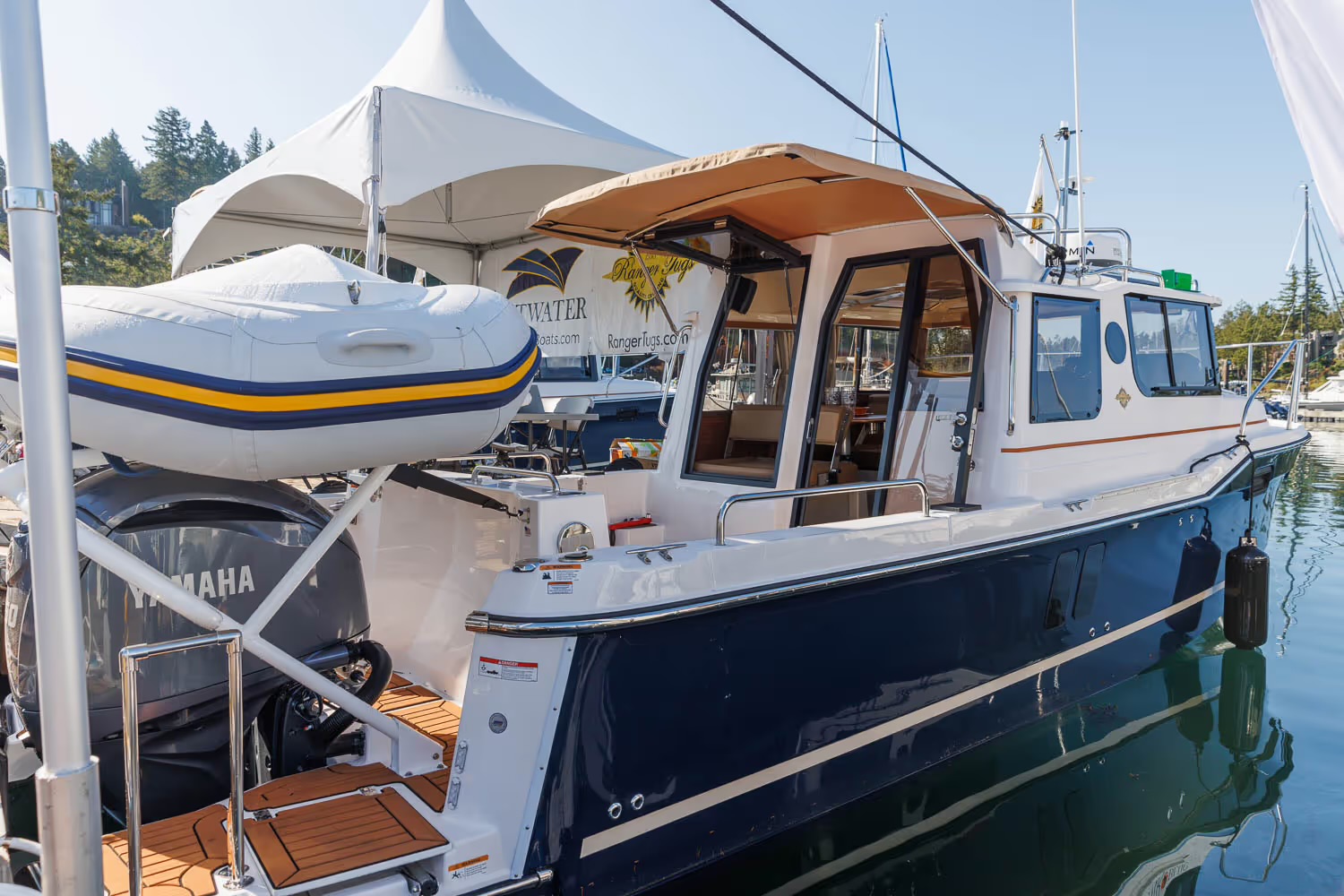

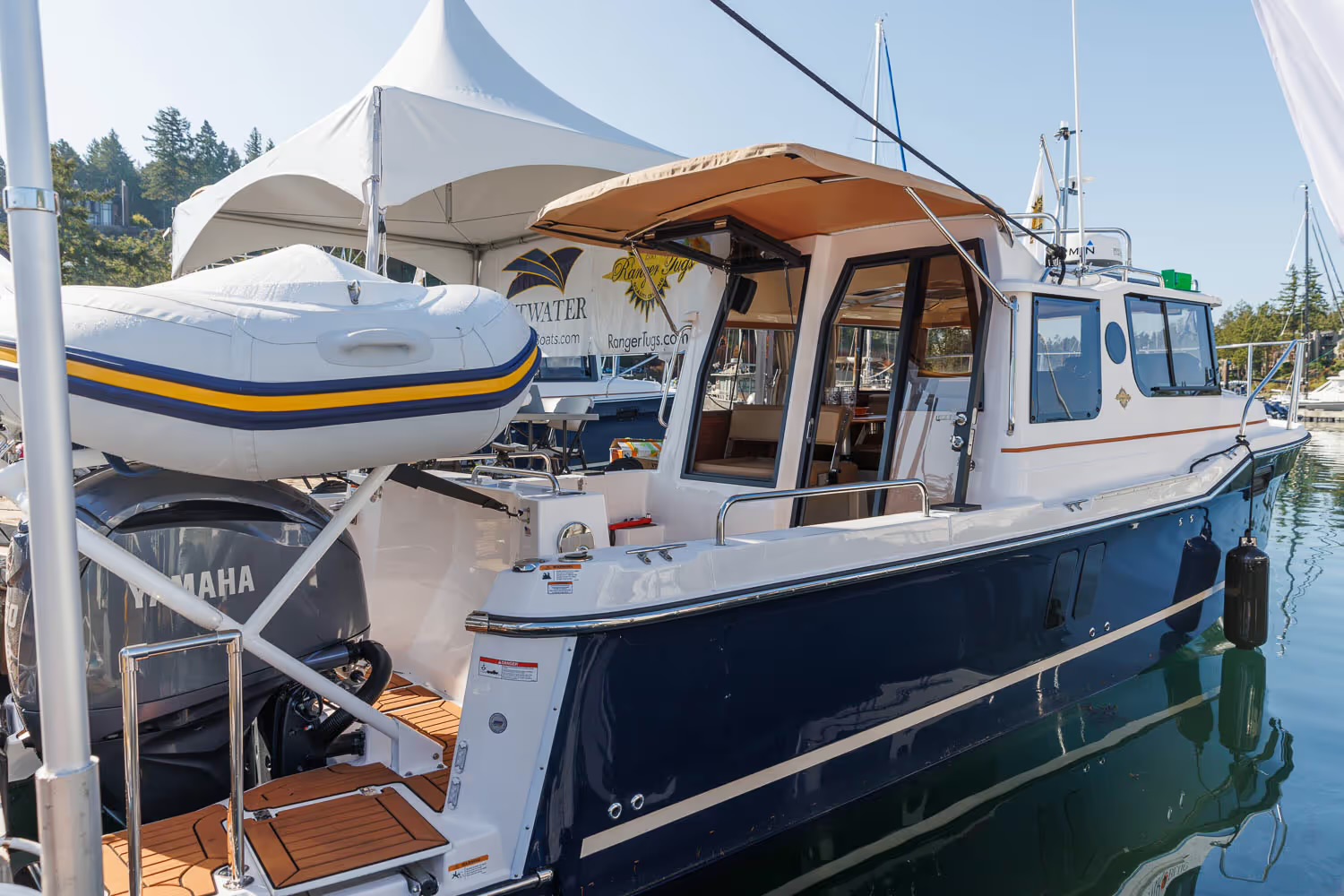

The dinghy lift is a factory option on the new R-25 ($10,500). If you want that option and didn’t already get it you may want to check with the factory or the dealer if it can be added. The gallery on the factory page shows a picture of it (also added below). Like @sogreer we did not get it because we fish a lot on the boat and did not want to have the dingy or the lift in the way. If that’s not a consideration, the main downside is just that it blocks the view out of the boat.

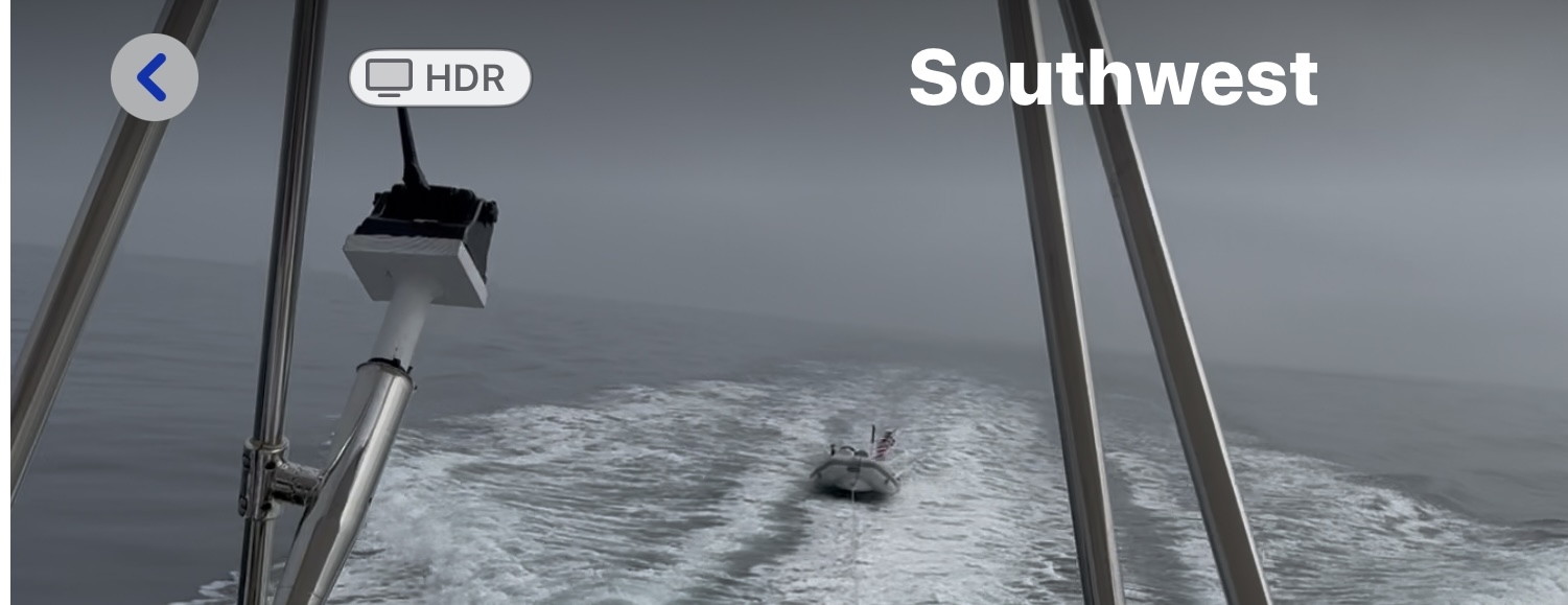

Not a Tug, but we also tow our 11’ Console style dingy behind our CW CB 30
How fast can you comfortably cruise at while towing your 11’ console, and how long a hauser/ line do you use?
We tow at our typical cruise 2950 rpm, about 15.5 knots to Catalina, and about 16.5 knots with the swell and current home, 26.2 miles each way. My tow line is 120' long with a bridle at the stern. I keep the engine about 3/4 of the way down to help the dingy track right behind the boat. I loose about a knot when towing vs no tow, and costs me about 5 gallons extra RT.
