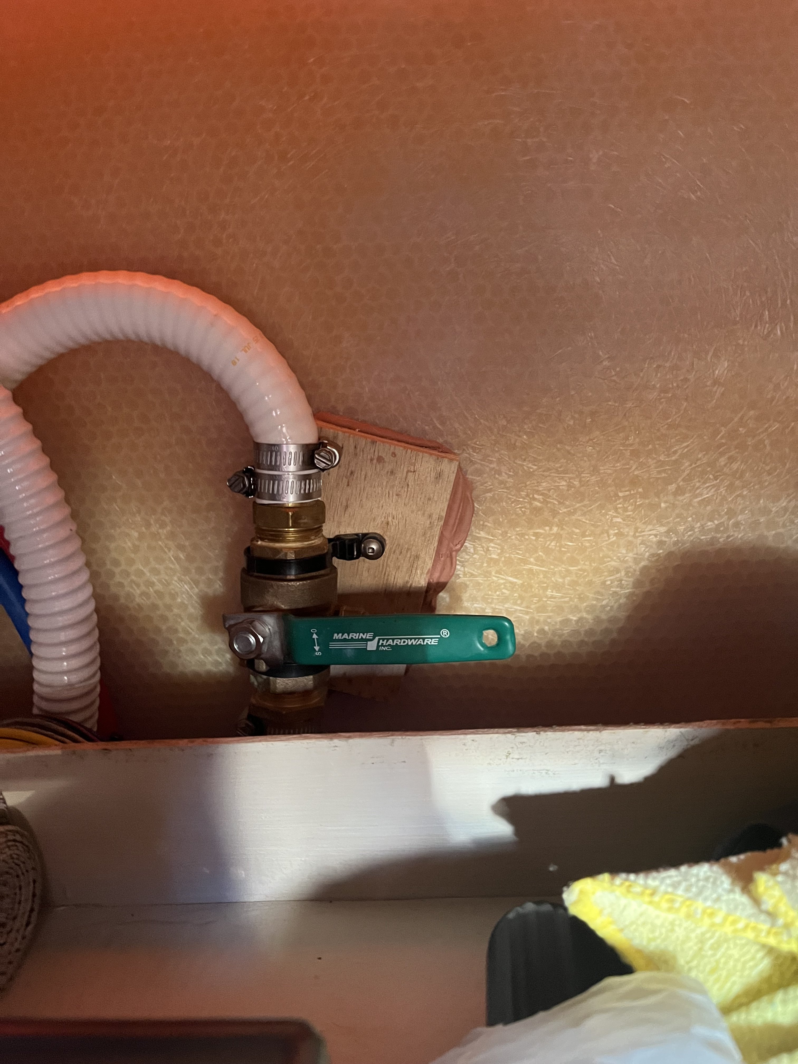

Sorry for the what are most likely dumb questions. New to using the marine toilet mostly we have used our r23 as a fishing boat and not using the head…but now the wife and I want to do some cruising.
Do I have to have the seasick open to use the toilet? Or can I just fill with freshwater from the sink? (Heard that will minimize smell)
When pumping out does seacock need to be open?
Also don’t plan on using macerator and I assume this picture confirms it is in the off position
Finally anything else I need to know? Thanks in advance to everyone for your help!

To use the head, you do NOT need to have the seacock open in the line that pumps overboard via the macerator. I don’t know where you are located and your cruising grounds. But in the US, you not only need the seacock to be closed, it should be closed in some kind of secure fashion — not easily opened. In my neck of the woods, most use a stout zip tie to secure it so that the zip must be cut off to open the valve.
The seacock also does not need to be open to pump out. Offhand, I would think it is better to have it closed to create good suction for a good pump out. But I’m not really sure on that. Mine has always been closed when I have pumped out. I suspect there are Canadians who could speak to how well it works to pump out with the valve open (since pumping out off-board is permissible in most Canadian waters if at least 3 miles off the coast).
Hope that helps!

Let me take a stab at your questions.
First, there is a water line coming into the toilet to assist with flushing. It brings water in from the bottom of the boat. There is a seacock at the hull on that water line that you can shut off and instead use fresh water from the sink faucet to assist in flushing. That’s the intake side.
When you flush there’s a hose that takes the “stuff” to a small holding tank. This tank is called the black water tank. In the R-23 I believe the black water tank is 11 gallons or about enough capacity for a single person for 5-7 days but your mileage may vary. Cut that time in half for two people on board.
There are two paths to drain the black water tank. One uses an electric macerator and pumps the “stuff” over the side. This is legal only under certain conditions but generally when you are miles from any shore. Read your local regulations on sewage discharge to be sure you understand the discharge rules in your area.
The other path from the black water tank is a pump out fitting on the gunwale of your boat. The cap is usually labeled Waste. You can use a marina pumpout station to pump out using this method.
So how do you control which method of getting rid of the black water fluids? There is a “Y” valve located either near the black water tank or near the macerator that you switch back and forth between the over the side sewage discharge position and the marina pumpout position.
Your owners manual should cover all this including the location of the “Y” valve.
Most electric toilets have a small built in macerator at the bottom to grind up “stuff” before it moves from toilet through an hose into black water tank. This is not the same as the big macerator that is used when doing sewage discharge over the side of the boat.
Hope I have answered some of your questions.
