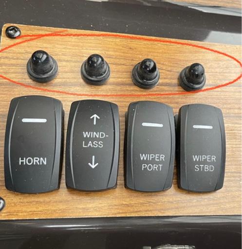

Maybe I’m late to the party, but just now realized that RT boats have 12V circuit breakers but there’s not one to be found on my cutwater C30. Why is that? Seems strange…

No reset buttons above or to the side of rocker switches?
Sorry, yes I do have those for the helm switches but that's it.

yah mines a 29. Yours doesn't the helm switch push button resets?
My C30 does have resets on the helm buttons. It does not have the full blown DC breaker panel for things like water pump, lights, etc. It seems like that feature is unique to 31's and bigger, and perhaps a few on the CW 288...
