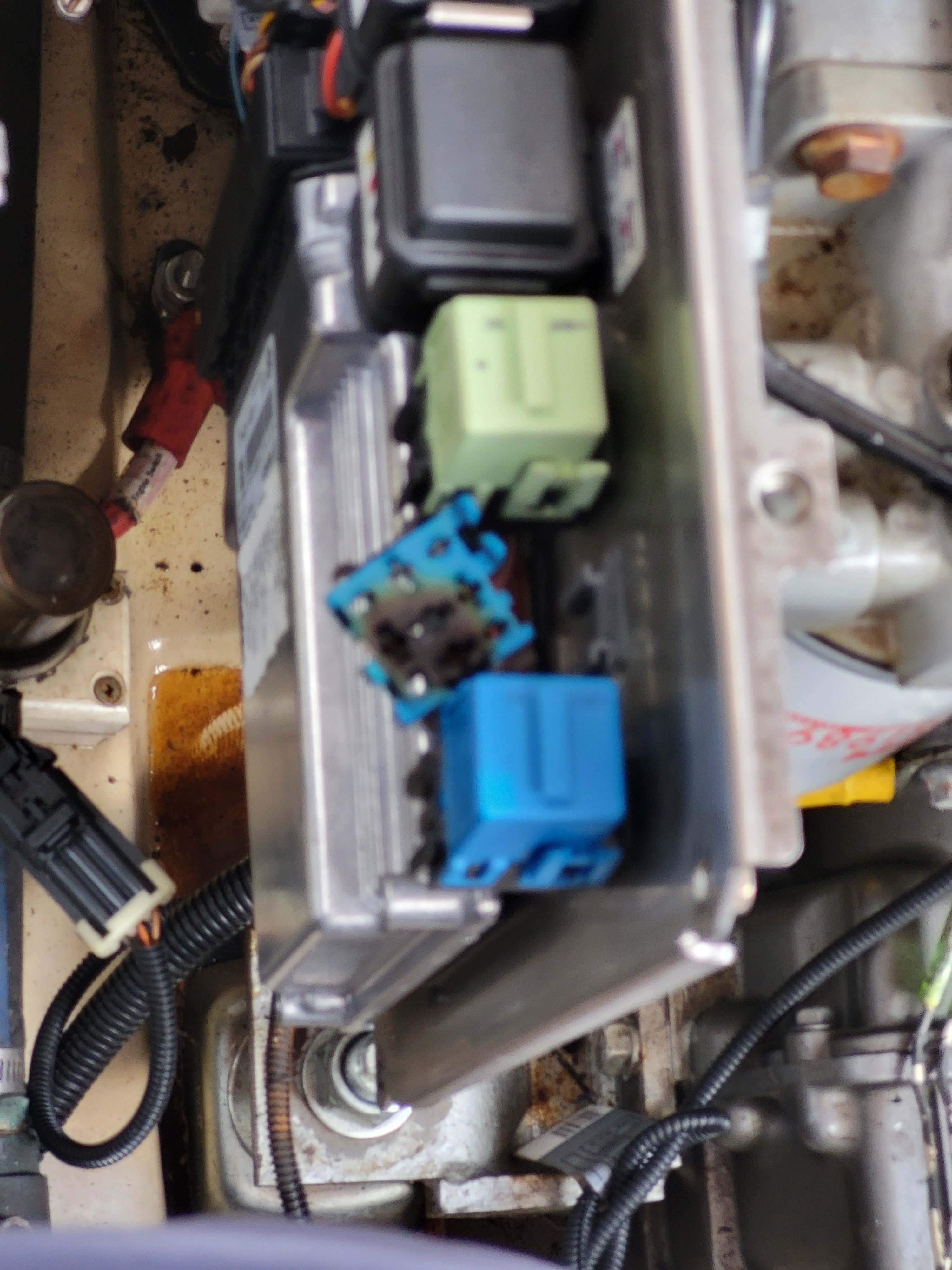

Had the same issue Checked the lift pump fuse was of, but the Relay and Holder were burned up.
Had the same issue Checked the lift pump fuse was of, but the Relay and Holder were burned up.View attachment 26631
The overheated fuel pump relay and scorched socket is a common issue on the 4BY2 and 6BY2 Yanmars. Most mechanics ascribe it to a high current draw caused by obstructions, such as clogged filters, in the fuel delivery system during high fuel flow situations. I don’t think that is always the case. Twice, I’ve had the fuel pump relay fail when throttling back to a low fuel flow. An electrical engineer buddy says relays can overheat because of a low voltage situation. I think it’s entirely possible the failed fuel pump relay issue is a fault in the ECU or an inadequately sized relay.
