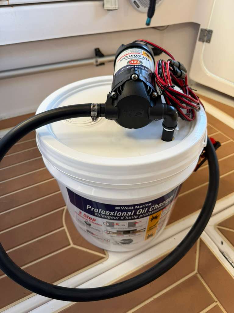

This past weekend I changed the engine's oil for the first time in this boat. I had a 12v extraction pump that I used with my previous boat with ouboard engine, but it stuggled to extract the oil, even after using masking tape at the top of the extraction tube, like Todd suggested.
I gave up, and got a new one at Westmarine. It is pricy, but did the job perfectly. It connects to the top of the extraction tube, like in the Robin's video.
I extracted almost all the oil from the engine (D6-435 capacity: 5.3 Gallons. I was able extract ~5.1/5.2)
