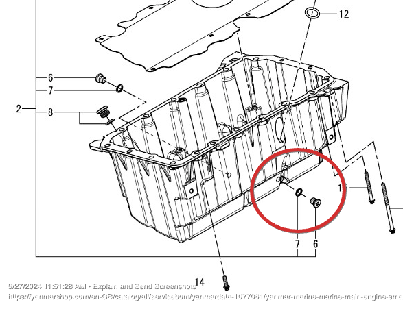

If it's weeping oil forward on the starboard side, get a borescope on this oil plug...
