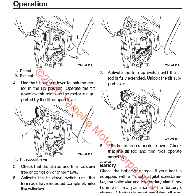

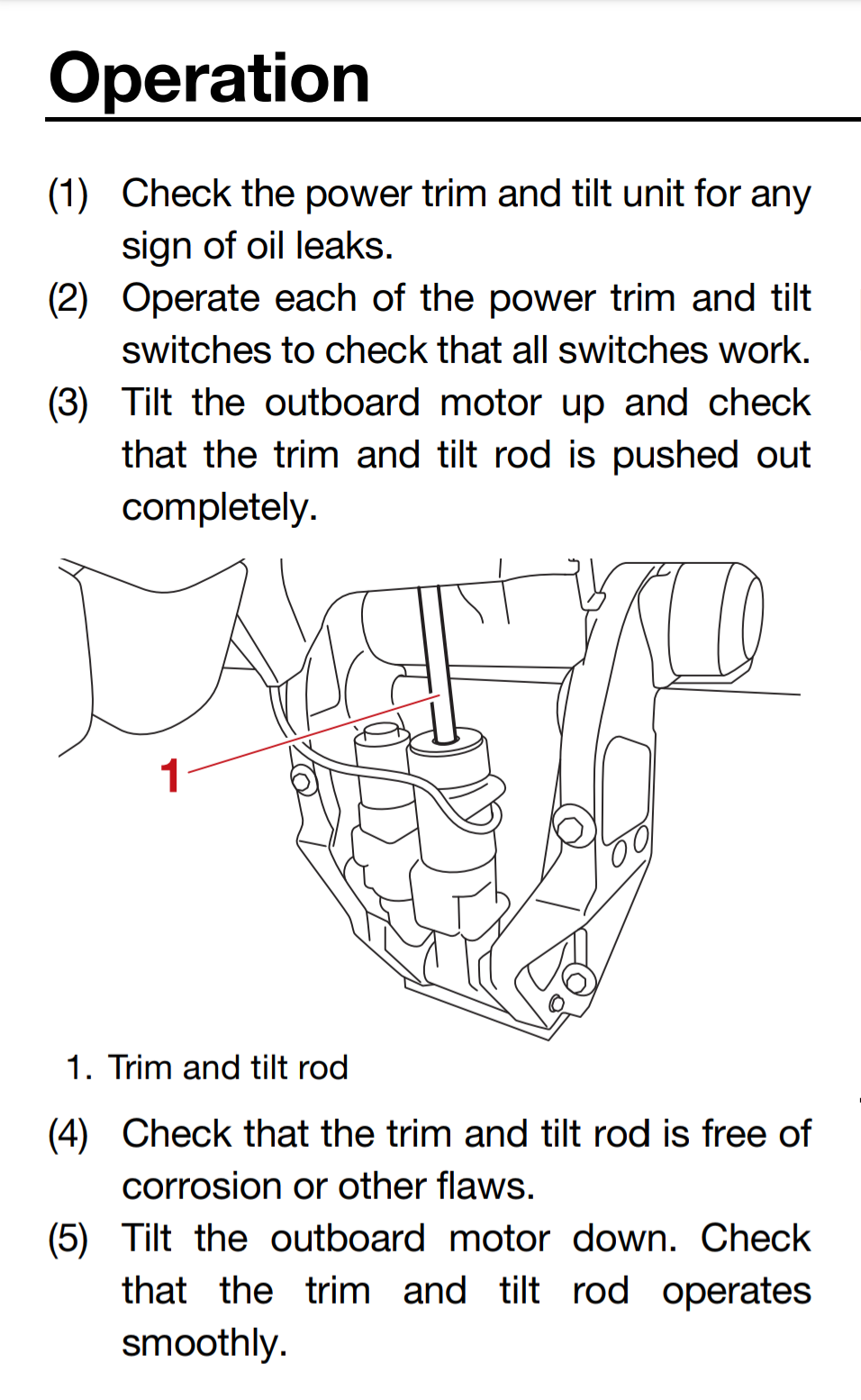

In perusing our R23 Yamaha F200 owners manual it mentions when the motor is stored in the tilted position, it should be supported using the "Tilt Support Lever". Until reading this we normally just raised the engine using the hydraulics and left it alone. Does anyone use the Tilt Support Lever at the dock? Will leaving the engine supported by the hydraulics cause undue strain on the system?
We boat on the Ohio River and the vessel stays in the water at our Marina. We have periods of single digit temperatures with minor ice build up. When this occurs we lower the engine to a vertical position to protect the lower unit from freezing. The owners manual suggest "... when the ambient temperature is 41 deg. F. or below, tilt the outboard motor up..." Other thoughts on this?
