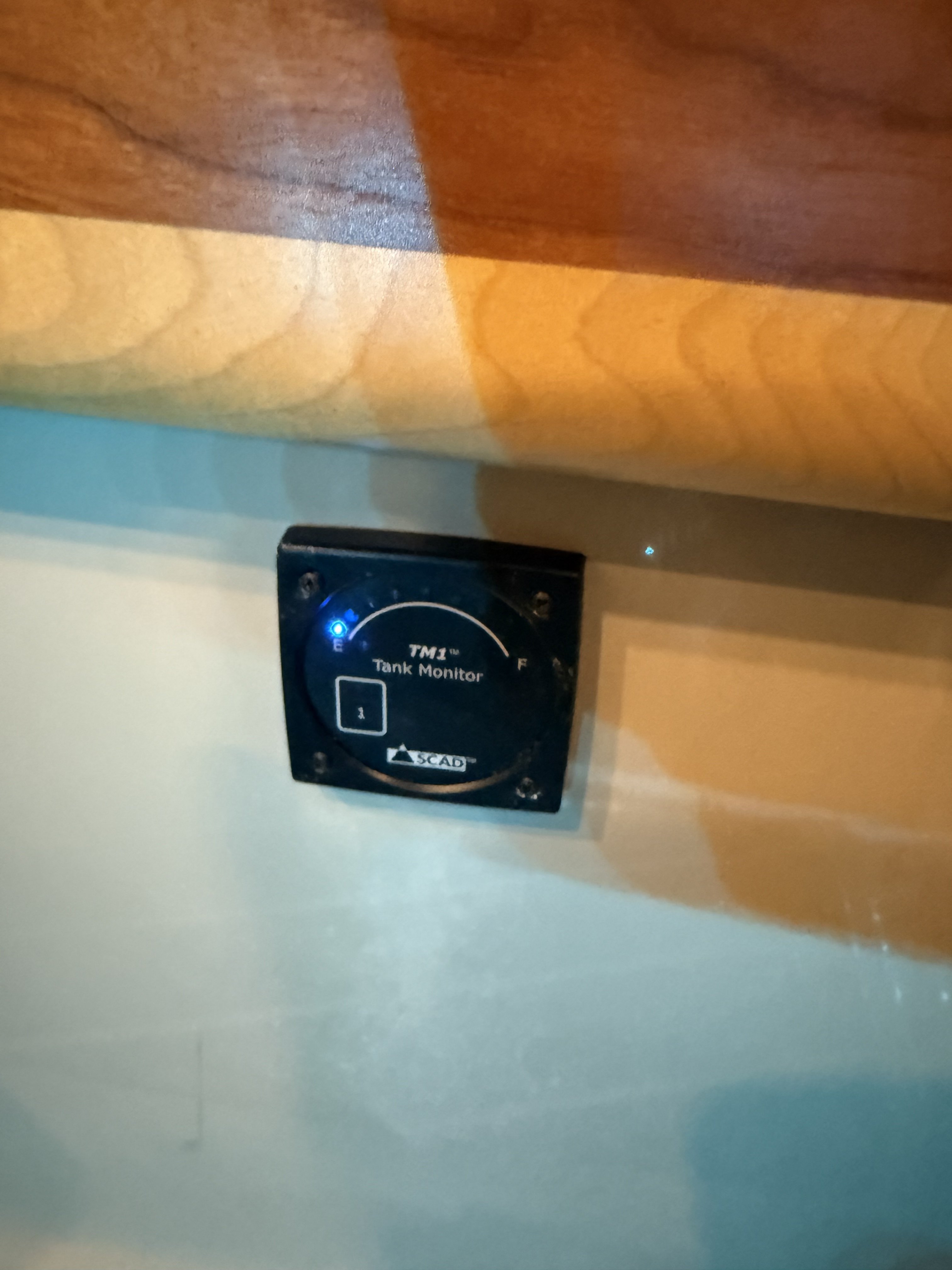

A full tank should either show in the toilet, over overflow out the vent, or both. As others suggest, you have a leak, probably a loose hose clamp would be the first thing I would look for. I installed a SCAD digital meter to monitor my tank, it shows the level of material at each 1/16th level and accurately.
A full tank should either show in the toilet, over overflow out the vent, or both. As others suggest, you have a leak, probably a loose hose clamp would be the first thing I would look for. I installed a SCAD digital meter to monitor my tank, it shows the level of material at each 1/16th level and accurately. View attachment 26567
