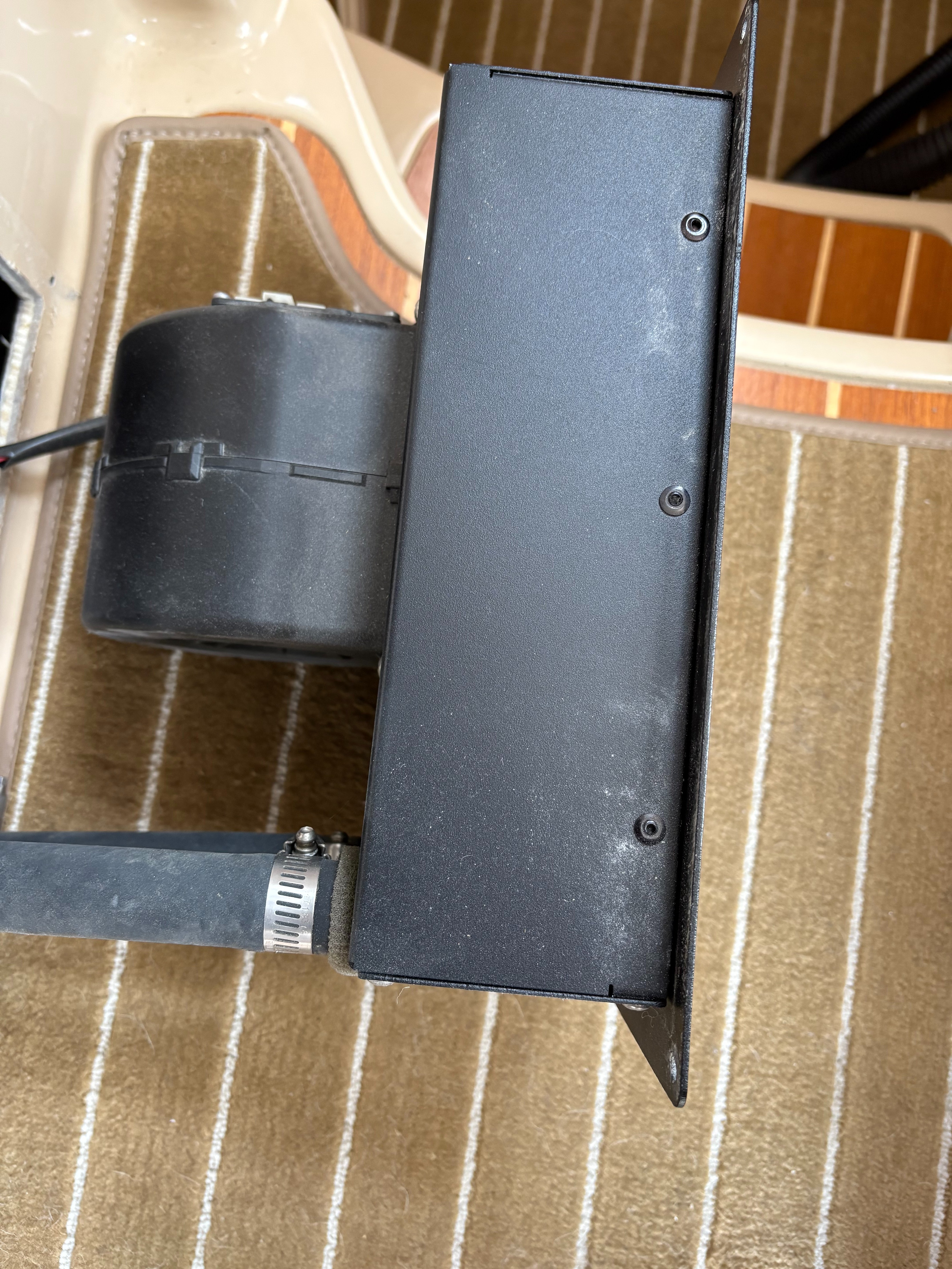

However, There are 2 problems. One is that I am hesitant to move the sensor, as it seems to be mounted where it is intentionally. Second, I am not sure what the cylindrical box attached to the inside of the "grill" is for (see picture below, which shows the top of the grill after it was removed form the wall). There are electrical connections, and I hear what sounds like a fan in there. Also, 2 rubber hoses are attached.
Can someone tell me what this is? The intake for the a/c is in the coffin, and has a difficult to clean dust filter.

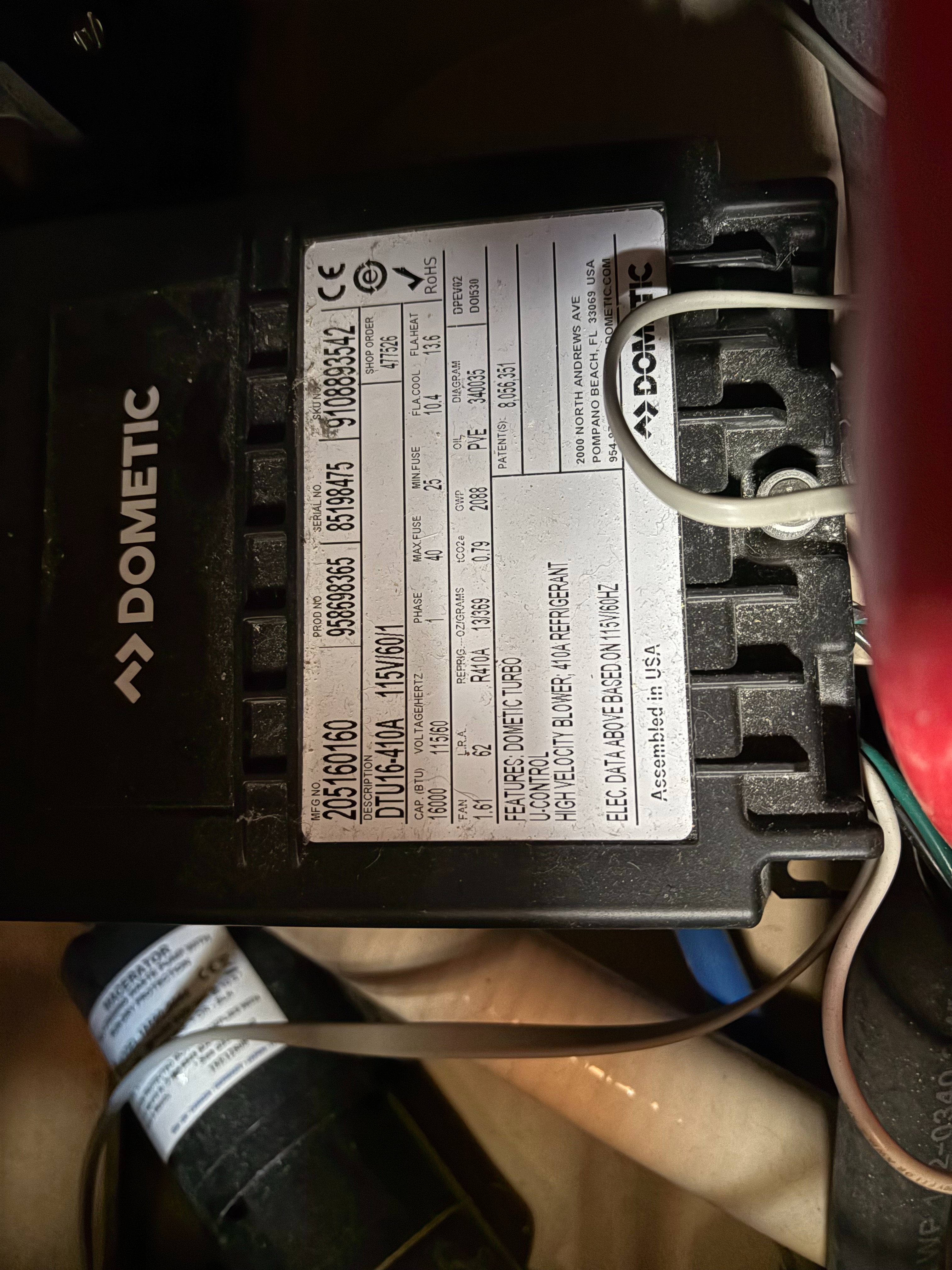

The second picture shows the type of Dometic a/c this is, if that's important.

I have a 2017 R29 NW edition, so mine is different for photo 2. Photo one is my heater that can only run if the engine is running. It has a three speed switch at helm, no thermostat. Hoses are antifreeze radiator fluid that provide heat like a typical car. Fan blows air over the rectangular grill radiator fins.
Thanks for the info about the heater. I think I get that part now.
I still don't know what to do about the thermostat sensor, but I get that you don't have one.

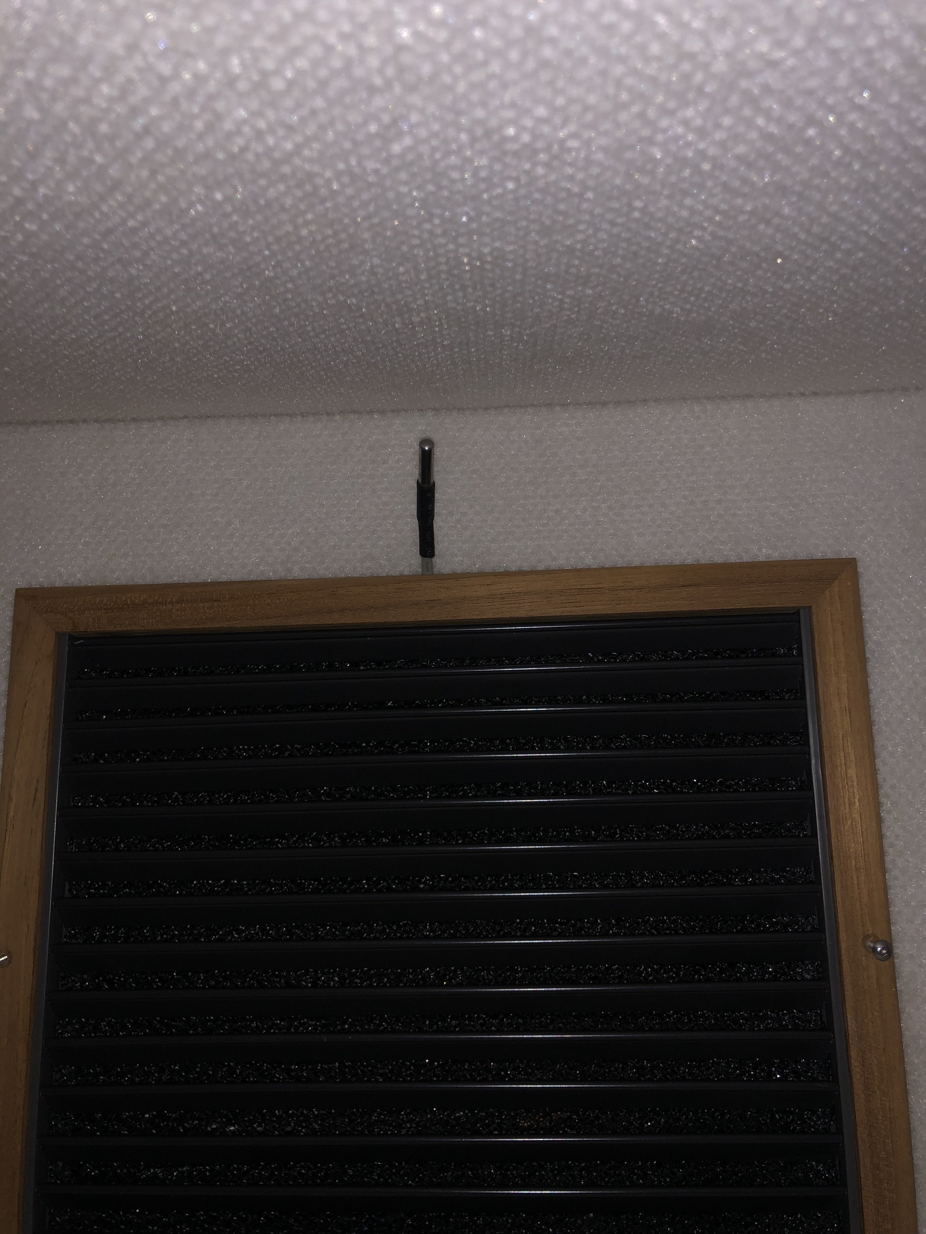

I looked at both units on my R31. Both had the remote sensor tucked in near the coil. Too cold down there in the winter to represent a good ambient temp in salon and v berth. I moved both away from the compressors and as far into the rooms that the cable would allow.

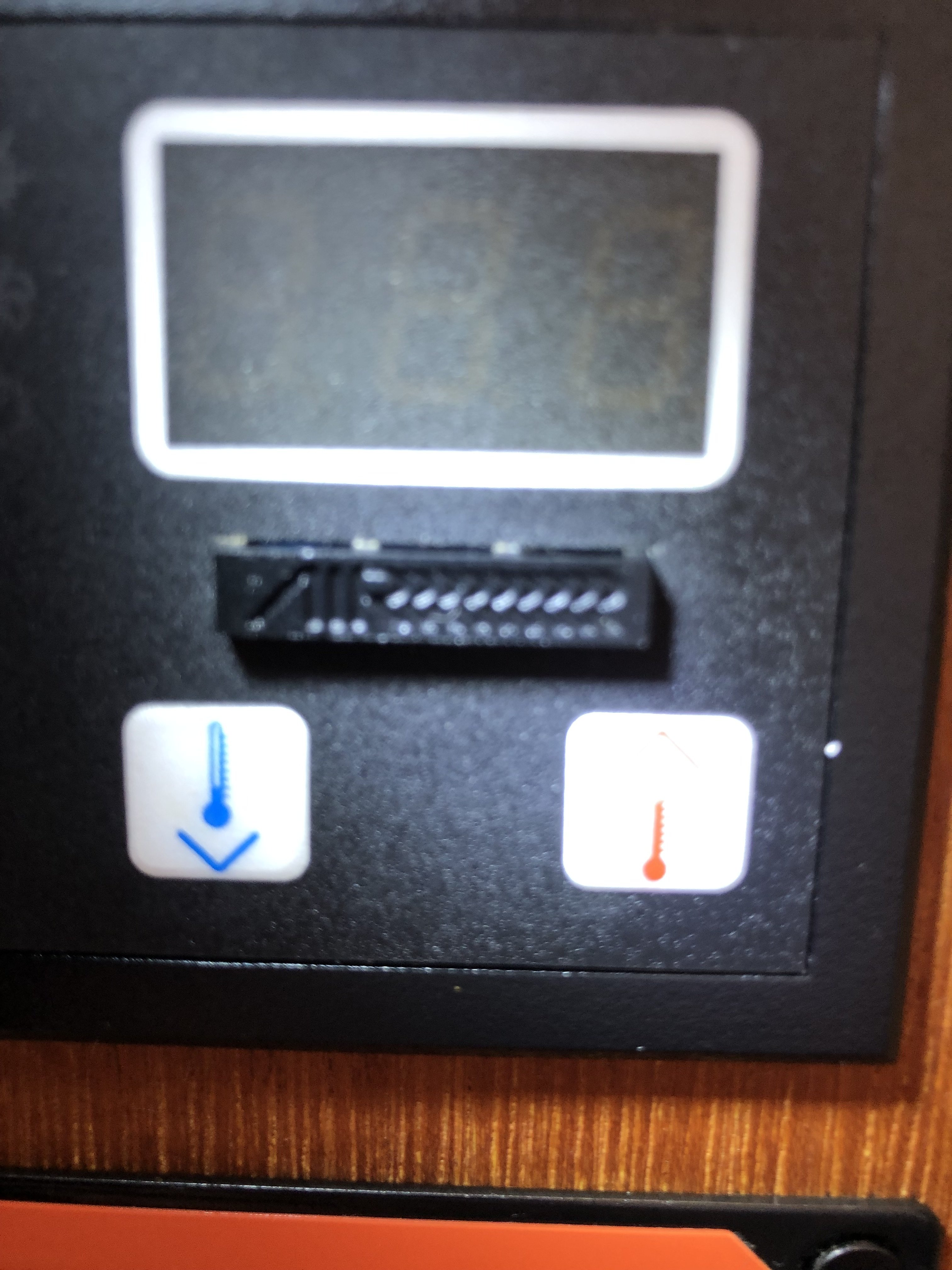

I was going to unplug the cable from J3 on the controller board but I didn’t have time to check the manual as to whether I needed to tell the system about it, so I haven’t yet.
As for the photo upload, it’s the 4th icon from the left at the top of the reply window. I uploaded a picture of my thermostat to show you the ambient air sensor that’s used instead of the remote sensor. It’s the raised area below the temp read out.
