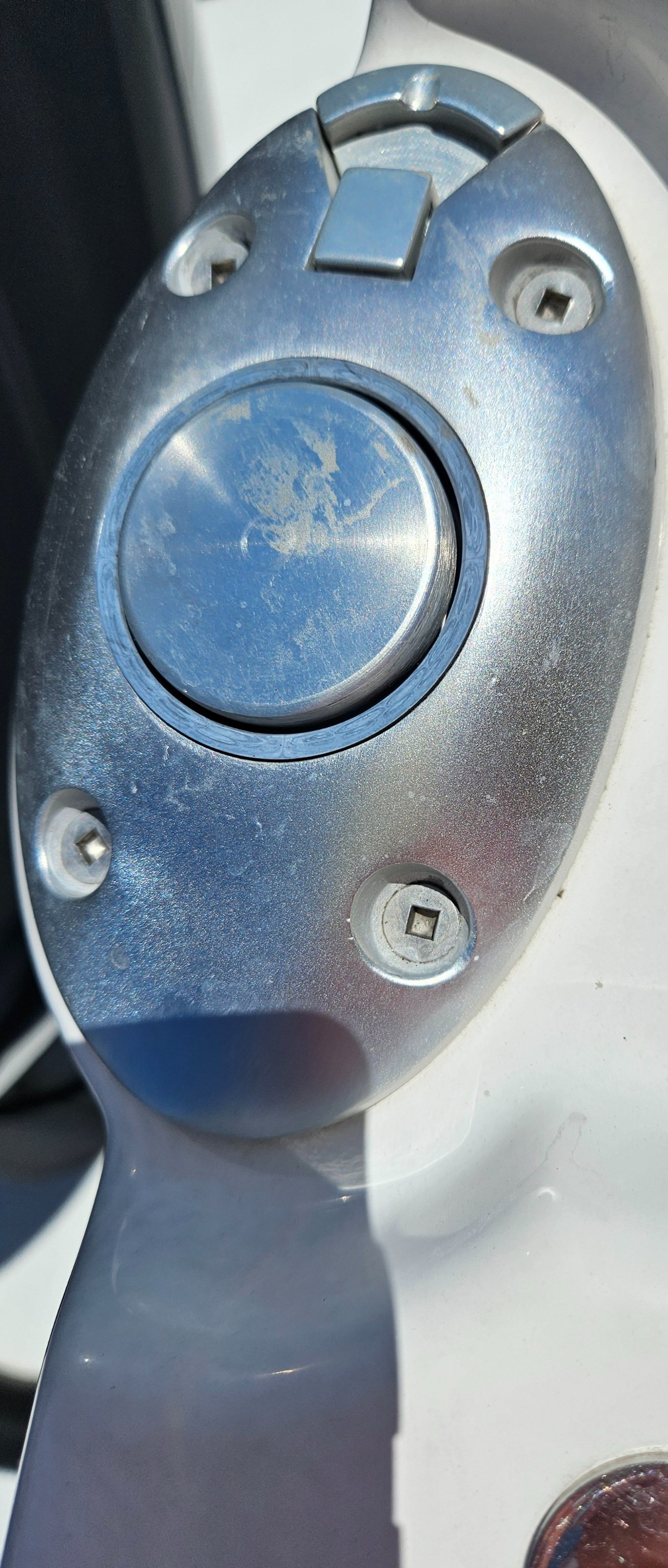

I recently purchased a 2018 ranger 27. Can anyone tell me what this is? It's by the grill.

Pop up waterski pylon
Most likely the sliding lock will be stuck.That little mechanism on the side slides outward away from the center. I had to use a screwdriver and a hammer to lightly tap it out to free it up. After I got mine working nicely and lubed up I realized I will probably never use it. 🙂
