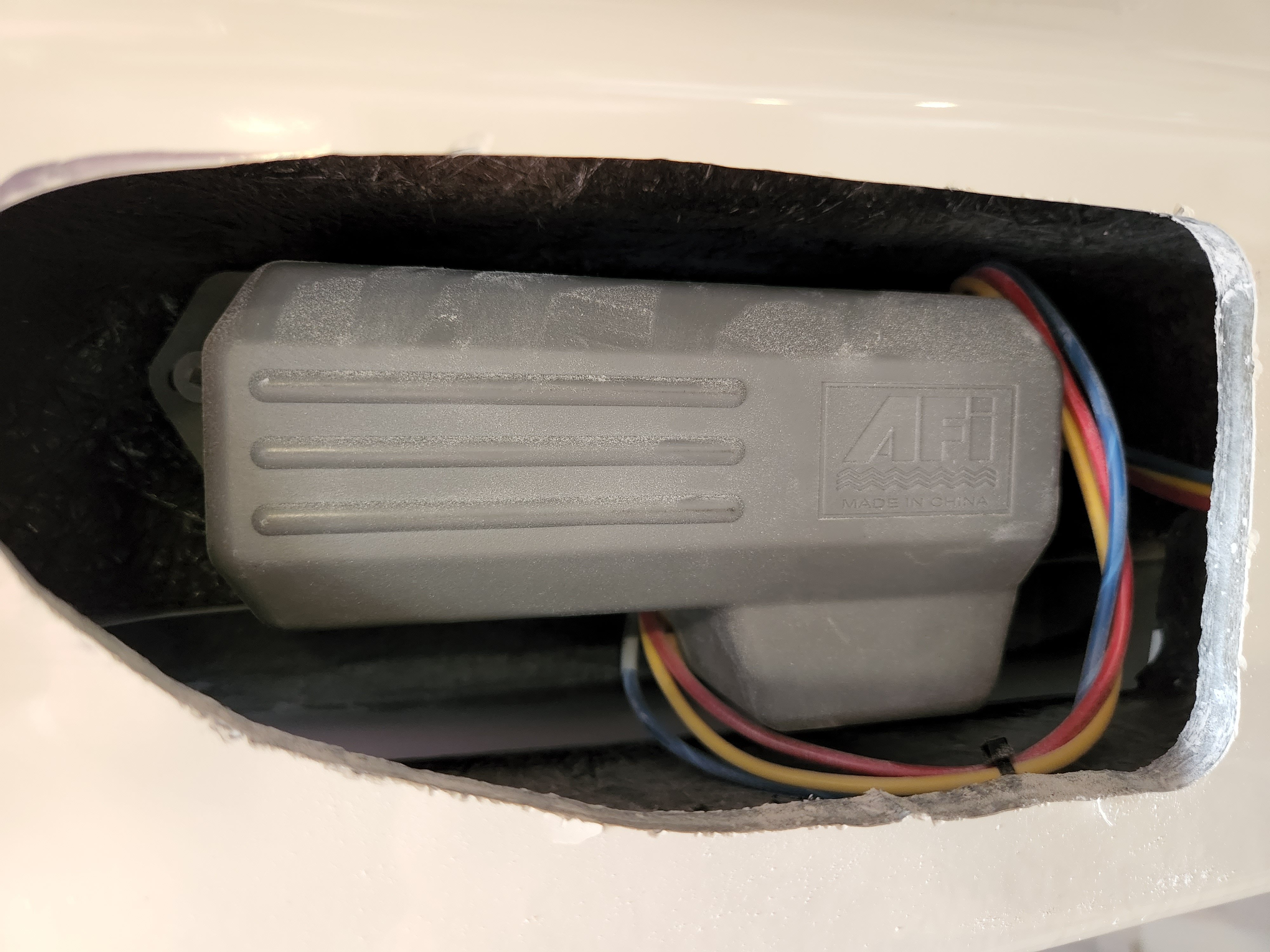

Does your wiper motor cover look like this?

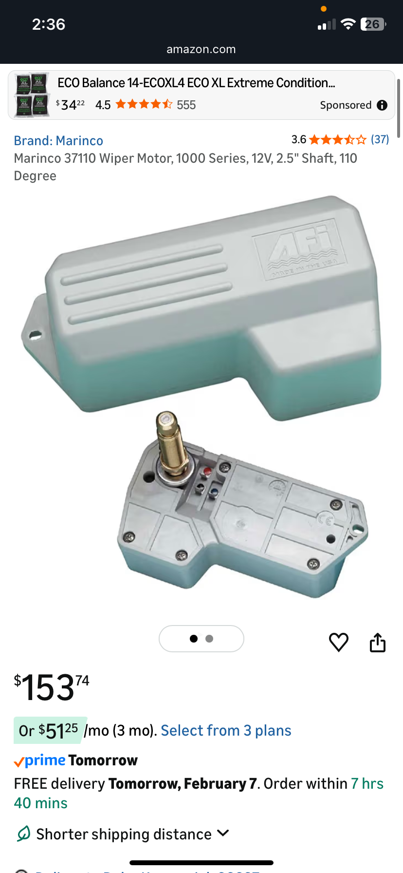

This is the replacement one I ordered for a spare, hope this helps. Bob
Yep, that's the one!
It's a Marinco AFI 1000 wiper motor. We have a '21 R27OB and I took the starboard motor apart in order to change the sweep direction of the wiper. We like it much better when the wipers both sweep from the center outwards.

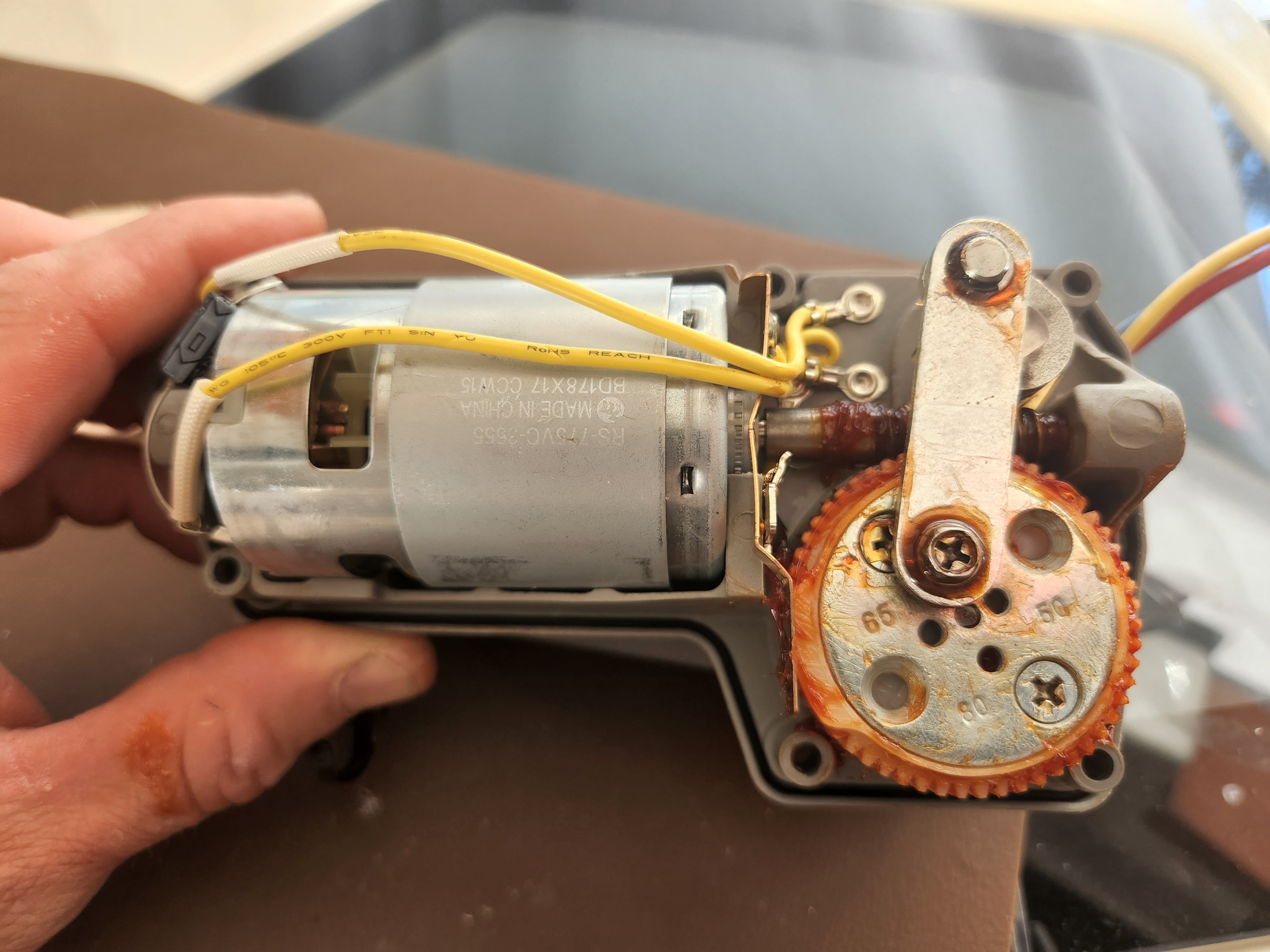

Anyway, here is a look at the works inside:
Just a motor spinning a worm drive. The hardest part of getting the unit out was taking the wiper arm off the shaft; it's held on with a hex set-screw that doesn't have much room to access.

Thank you, this is the info I needed. Now I know to look for a set screw!
