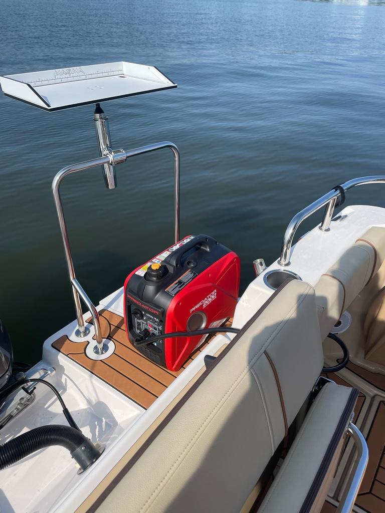

Predator 2000 with 4 ft Smartplug working great. No problem running AC, battery charger and AC outlets charging iPad and laptop. Max Amps on Victron shows around 7. Even running generator on ECO mode and no problems.

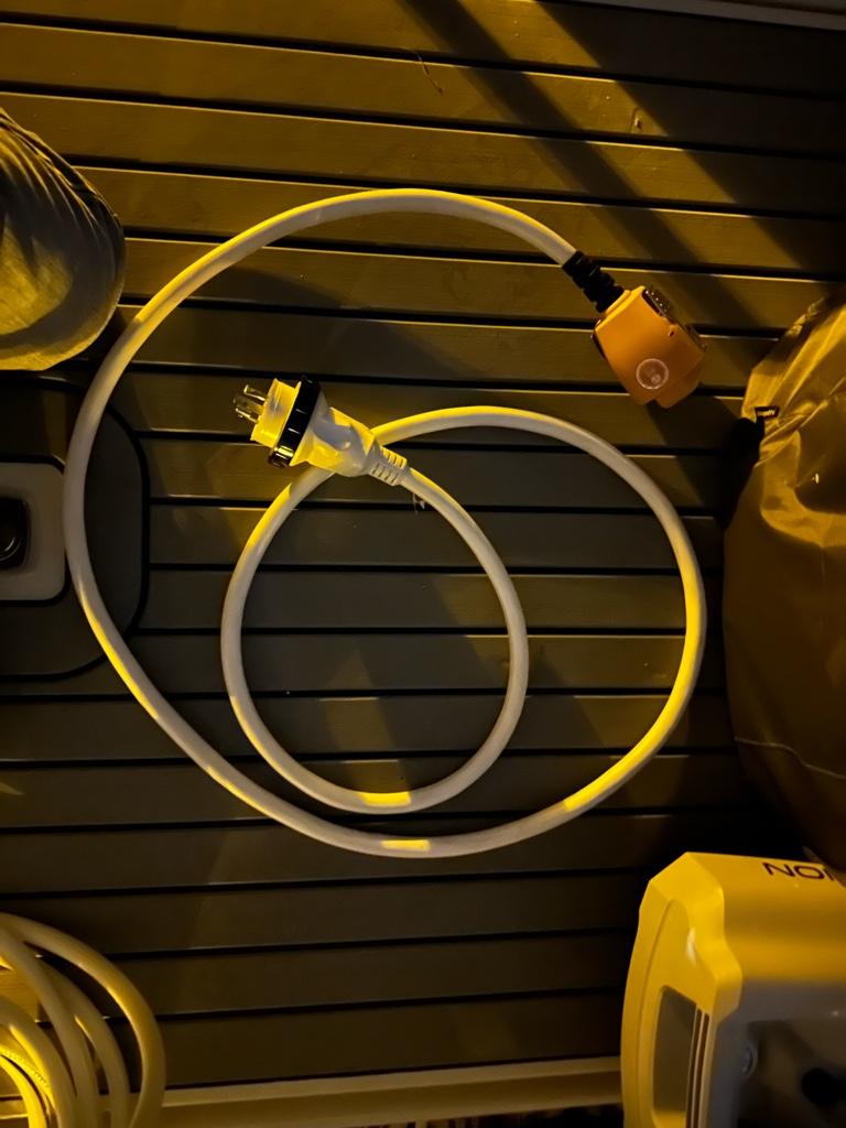

Yes, I bought a 4 ft standard plug to shore power inlet. (15 Amp 115V / 30 Amp 125V – 4’ Cordse) Treat the portable generator just like you would shore power. Some folks said they would get a reverse polarity light, I boaught the plug that fixes that problem. The plug goes into a seperate 110v AC outlet on the generator. (Southwire Company LLC Neutral-Ground Bonding Plug)

I made a short 30 amp cord to from the HONDA 2200 Companion 30 amp plug to the SMARTPLUG.

This is a very tempting idea for me, rather than spending $15k on a plumbed in genset. I do have a little shame about my boat friends judging me, and about how best to carry the genset with gas in it (probably shouldn’t be in my hot engine compartment), and where to place it while operating it… but that seems all doable for the cost savings and security.
I carry a 1 gallon fuel can in the anchor locker. Any fumes can get carried out the locker drain by gravity.
good to know, thanks. Do you think it's safe to store the generator in my engine compartment or is it too hot while the engine is running?
I have an R-23 w/ outboard, so I’ve never contemplated that question.
If we don’t have the dinghy with us, I have our generator strapped in the center cockpit locker while underway. When we have the dinghy and motor stored in the locker, I have it in the cockpit while underway.
