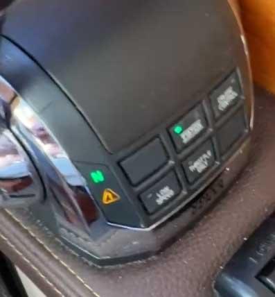

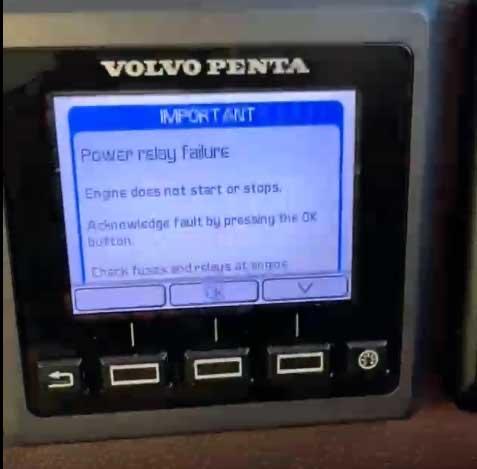

Hello -
We just got our 2017 R25 SC and we are still getting familiar with our boat. We received a power relay failure message tonight. I've been reading through similar posts and realized I turned the engine battery off before turning the ignition off. Does anyone know how to clear the error on the Volvo digital gauge? Lesson learned! Thanks!! Eric

Hi ECR,
You can clear that code by hitting the back arrow until you get to the view selection menu, then scroll all the way to the right and you should be able to acknowledge the code. You should also be able to clear the code by properly shutting the power down at the dash switch and then the battery switch, and then powering back up and rebooting. Hope this helps.
Thanks,
Ralf
